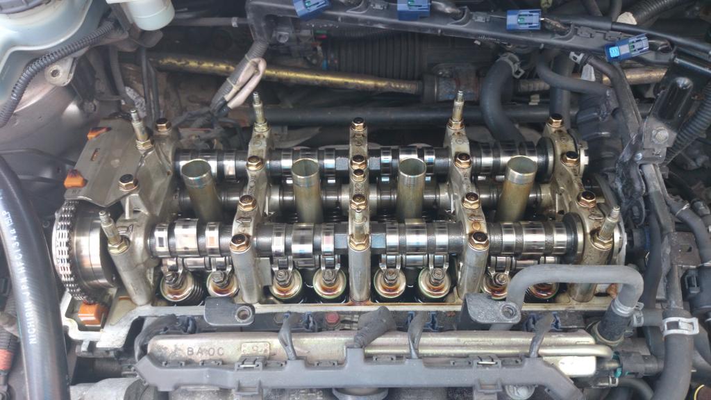

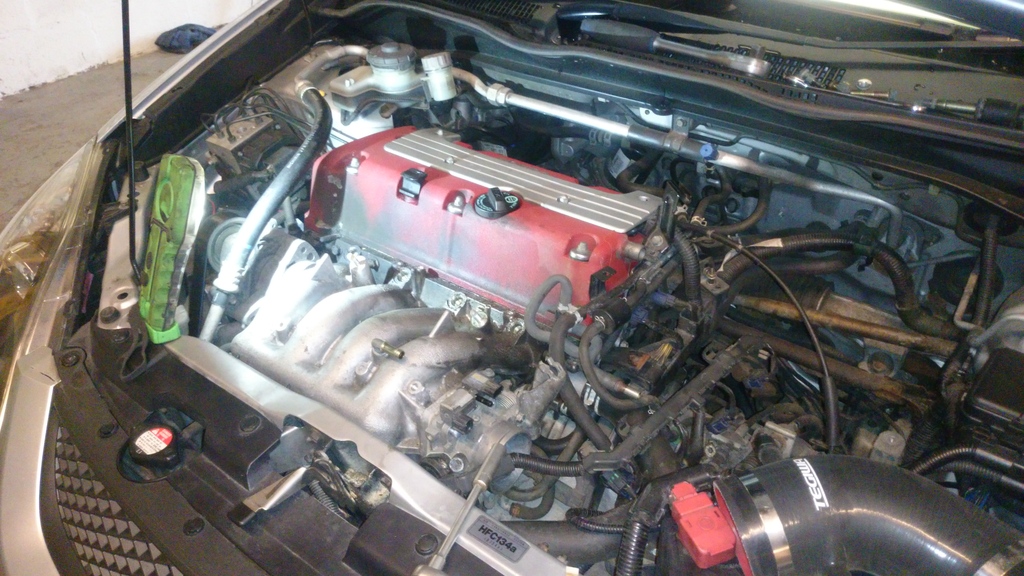

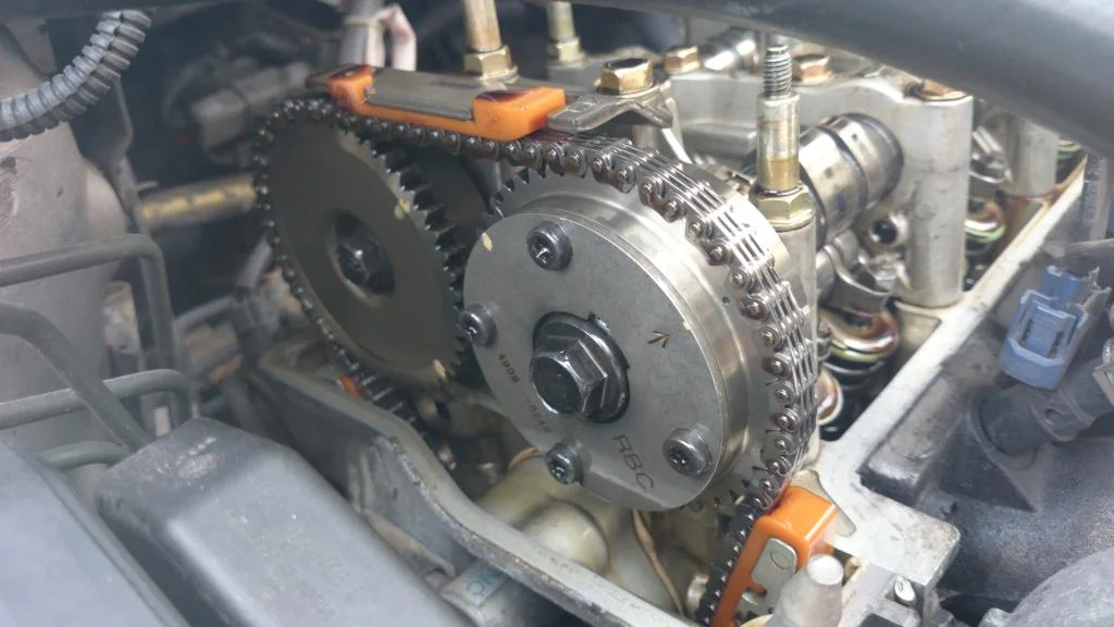

Next I changed the rocker cover gasket as it was leaking a bit of oil. Easy job. Few photos if anyone wanted to see what an EP3s brain looks like.

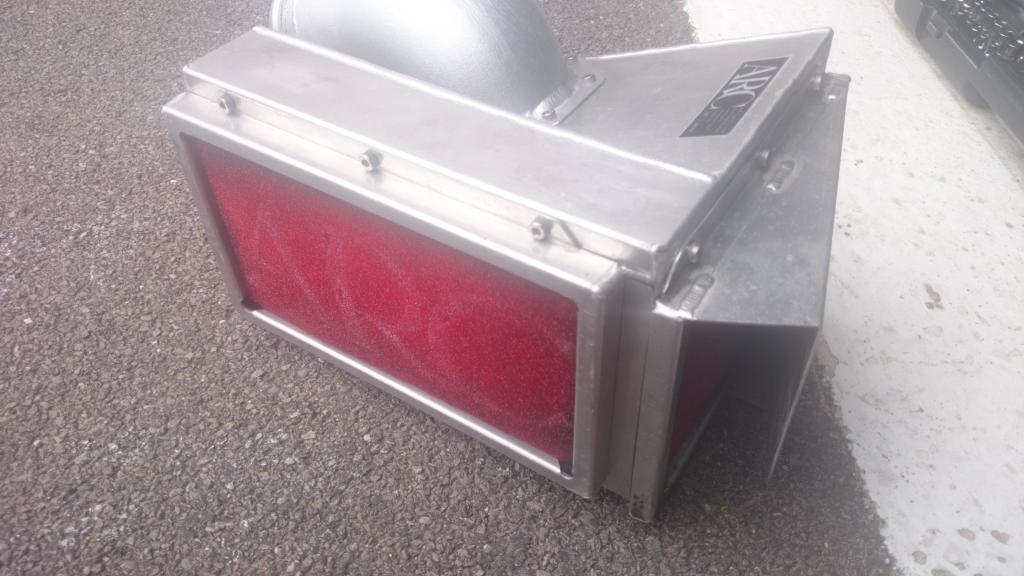

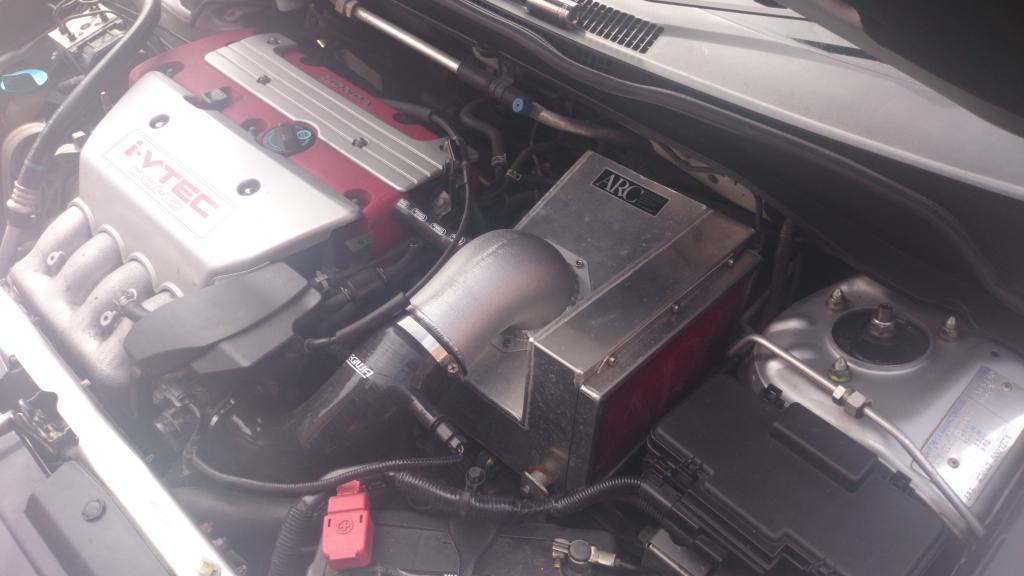

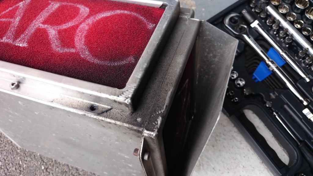

A friend of a friend was selling an ARC airbox and I decided to make the jump as something of an impulse buy as they're very hard to get ahold of and traded him my old AEMv2 and a bit of cash his way.
An ARC airbox is a no bullshit way of cramming as much air into the engine and a good starting point for extra mods.
They're originally designed for the DC5 but they fit the EP3 just fine. :cool:
They come with two filters and this one was a bit grubby on first arrival.
Bit of cleaning and oil later and it looked much better!
Kind of eats the engine bay...

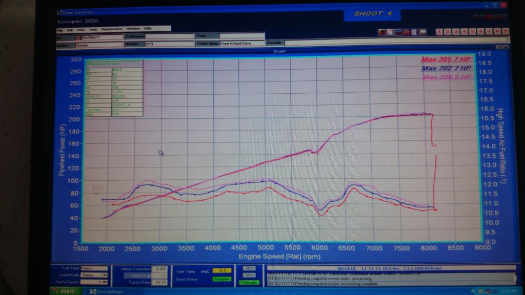

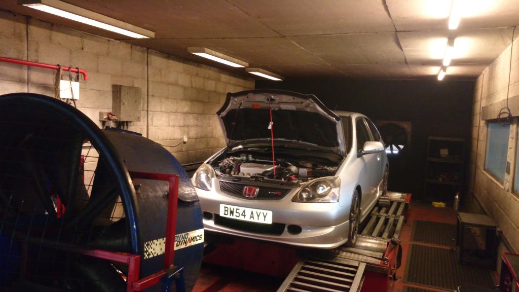

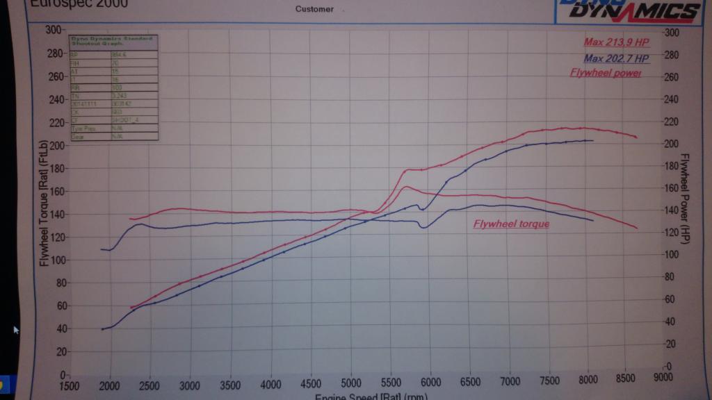

So, onto the rolling road the car went!
He did a couple of runs just to get some base figures.
As standard:

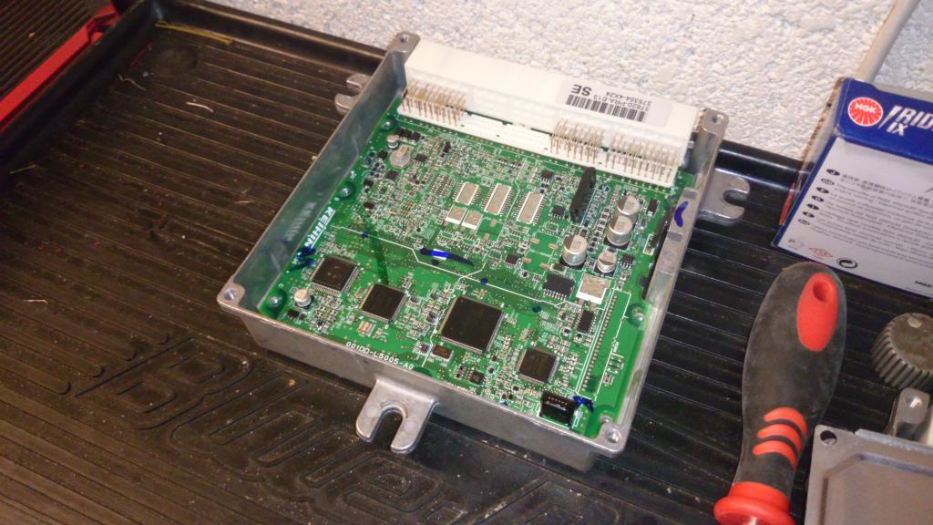

ECU Out!
Before and after:
It gained about 40hp in the middle! It's a totally different animal and the VTEC (yo) crossover has been dropped to 5400 from the ~6500 mark.
2nd gear is now something of a commitment and I have wheelspin at the crossover where there previously was none.
He's also raised the rev-limit to a stonking 8650 though the car over-reads and displays a totally ridiculous (ova!!) 9000 before it runs out of puff.
Problem is that now I have a printout I may end up going down the 4-2-1 and RBC intake and chase the bigger numbers... This stuff is addictive...
But at the same time at no point when I drive it do I think "this is slow" so I may just go for an LSD and some Recaros out of a Premier EP3.
Whether to get the standard box modified or just drop an DC5 one in I haven't decided yet - that can wait till 2015. :tongueout:

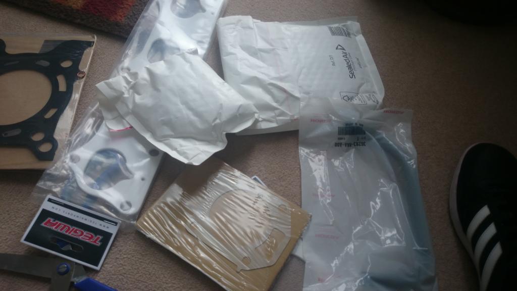

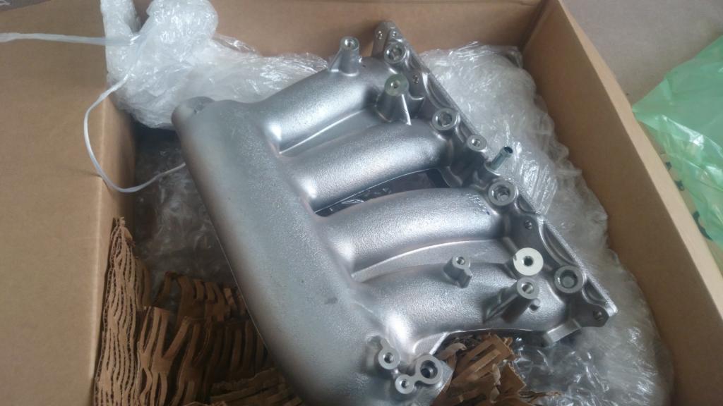

Now remember I said I wouldn't start chasing power?

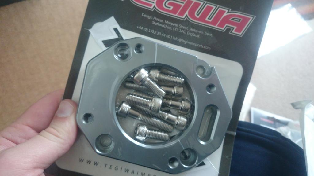

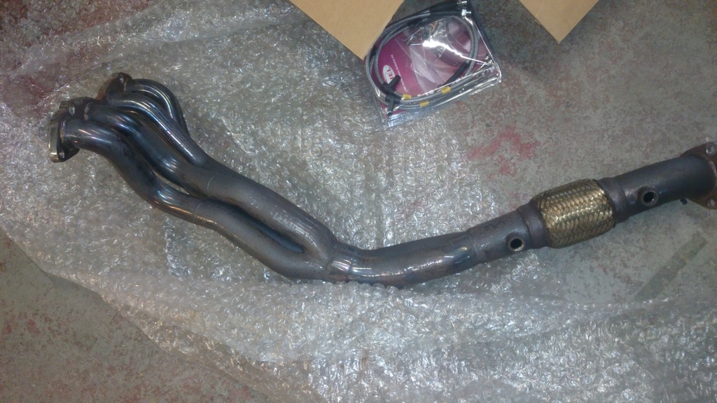

  • Well, a friend of a friend who is sh1t with money was selling a cheap 4-2-1 manifold...
  • And I may have gotten frisky online and ordered some other toys...

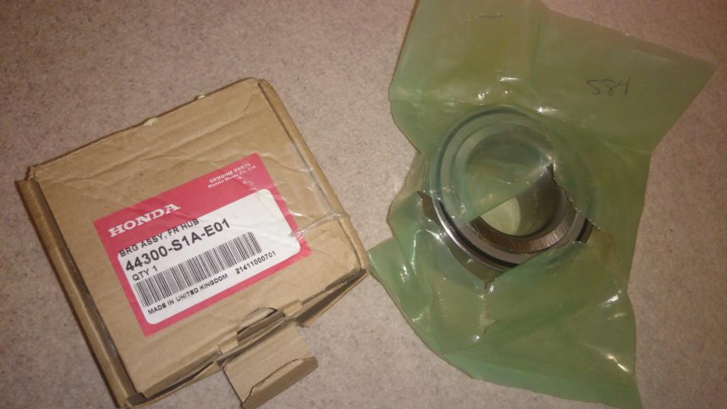

Swapping the bearings and ball joints didn't fix my wobble at high speeds :( so I guess the tyres have worn unevenly and they're now shaped like 50 pence pieces or something. I'll swap them at the end of the salt and grit season.
Bearings were a dickwall of a job but my god it's smooth driving round town now!

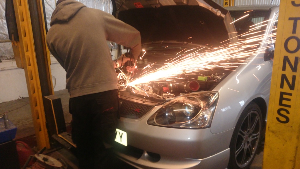

Anyway after the rather excellent Welsh meet I decided it was time to get all the extra toys I had lying around screwed on.
A good friend of mine is rather excellent mechanic so I invested in his help and yesterday we started screwing parts on.

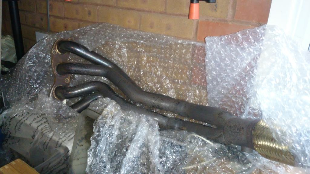

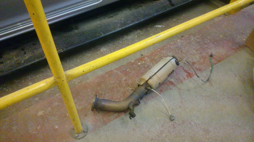

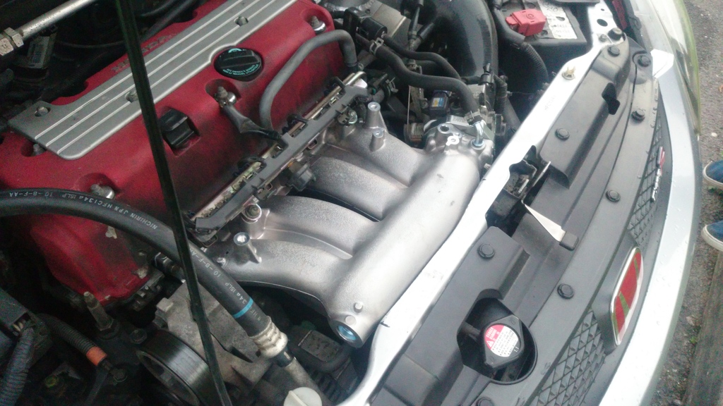

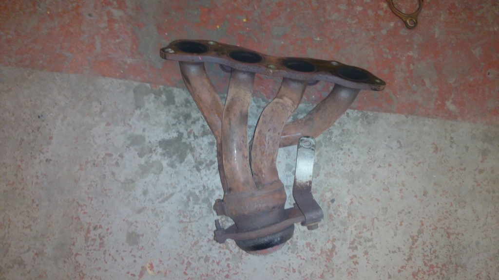

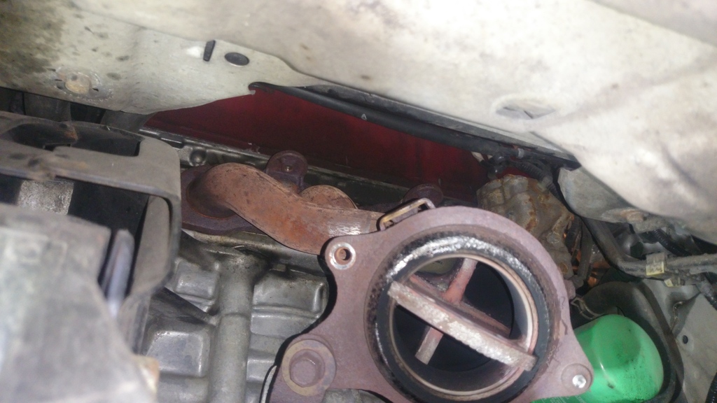

First he attacked the manifold and cat.
Goodbye Mr Restrictive
The old 4-1 manifold still on.
The old manifold off the car! You can see straight away what a restrictive lump it is.
Hello Mr Unrestricted!
Unfortunately I don't have any photos of the 4-2-1 manifold on the car however there's an exhaust flange that needs to go on the car as the 4-2-1 comes an inch shorter than the old manifold and the cat did so the next time it's in the air I'll snap a shot.

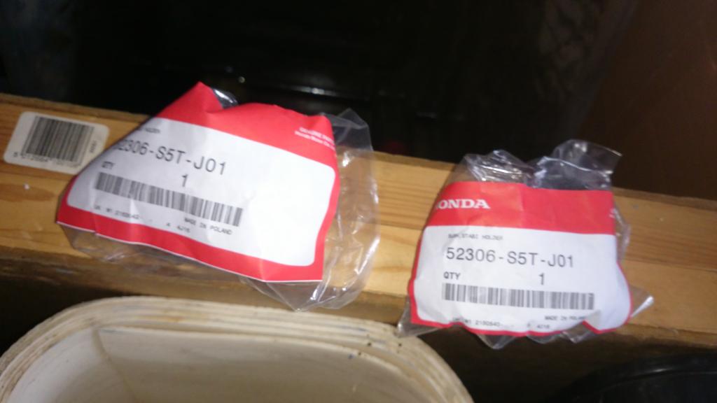

To utilise the uprated manifolds you need to uprate the engine mounts to minimise any engine rock.
I picked up some inserts for the front & back lower engine mounts - didn't take a photo so here's one I pinched from Tegiwa. :smile:

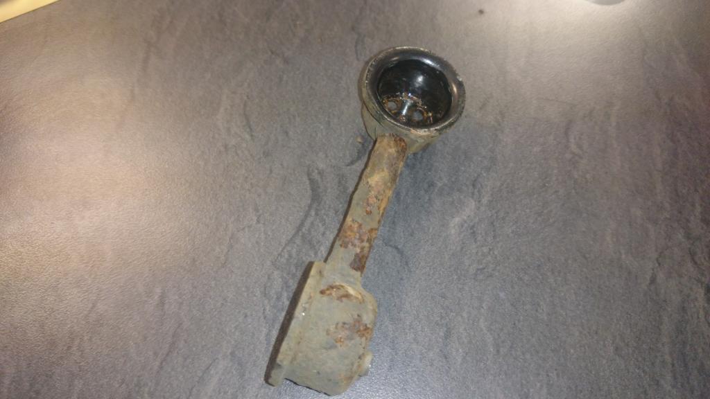

To get at the lower engine mounts the subframe requires dropping slightly.

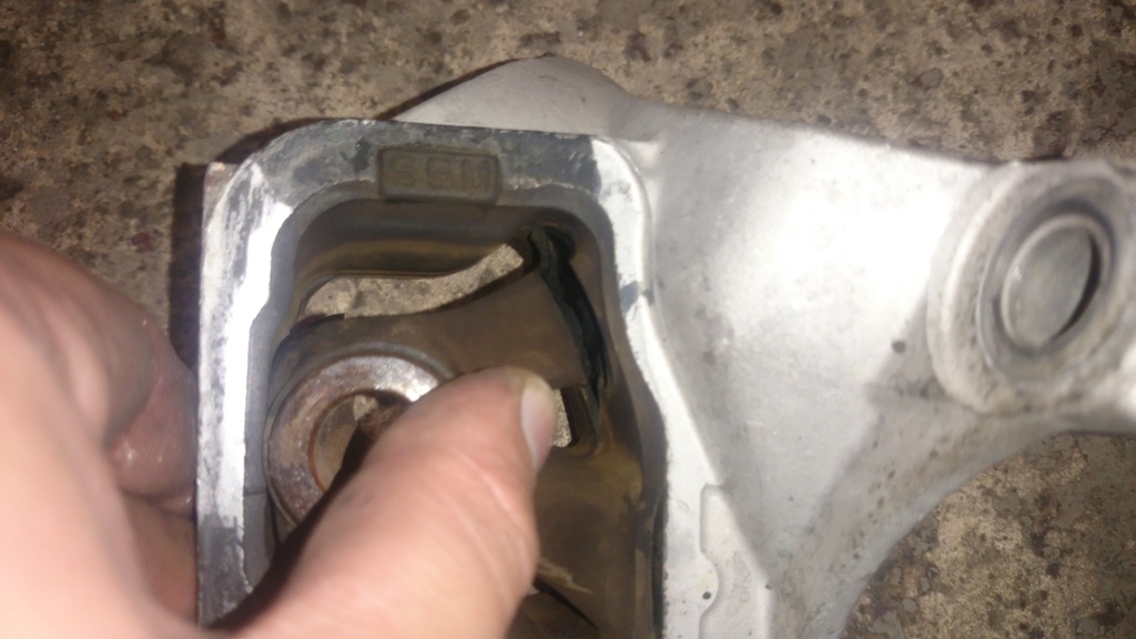

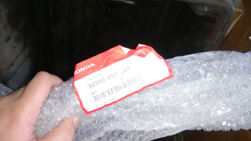

I'd noticed an engine rock had developed slightly and the lower-front mounts on these cars like to break. The previous owned replaced the the lower front mount twice. From my garage floor the mount looked fine, however once it was off it was a different story!
I'd foreseen this mount having broken so I actually had a spare in the garage. :smile: Dropping in the inserts was a total doddle.
The rear mount was a bit of a t**t to get out but with some good thinking from my friend and some wiggling, it came out too!

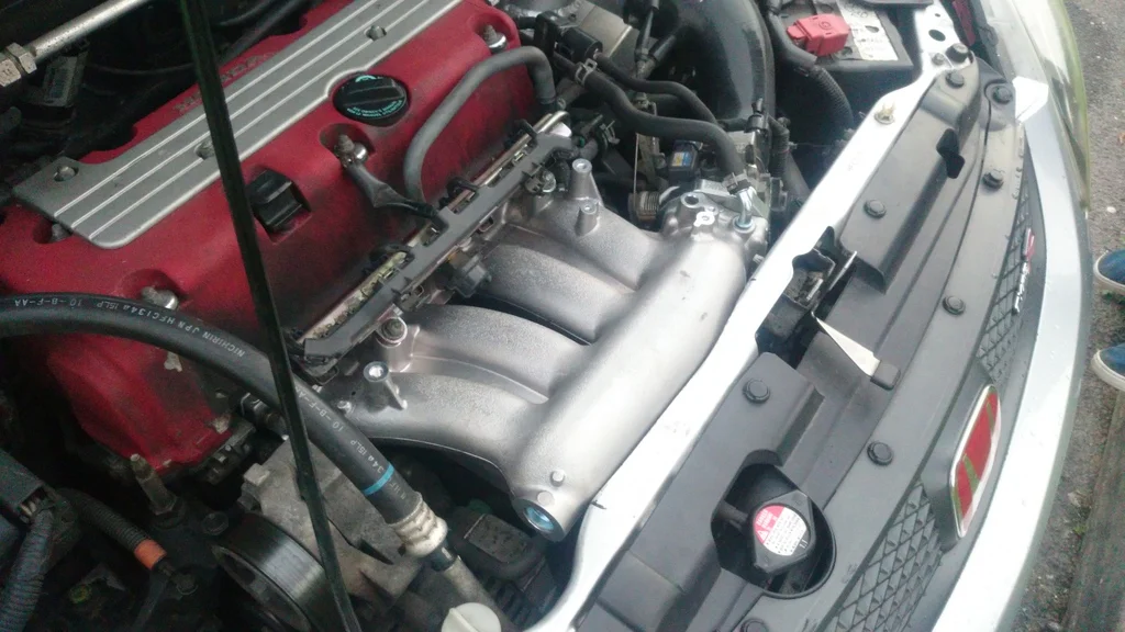

Next came the new intake manifold.
Here's how the bay looked with the airbox removed and the old intake.
A popular mod for these cars is to stick on the RBC manifold from the European Accord-R (it also was found on the USDM Civic Si from 06+) and it's become so popular that people have cut them ready to fit into EP3s.
To properly fit an EP3 you are required to cut the slam panel, and as my friend is considerably better with the grinder than I am, he kindly cut the panel for me.
After that it was a case of screwing everything back together, block up any extra holes on the RBC and sticking the throttle body back on with a new adaptor plate and some gaskets I'd bought.
Here is the completed engine bay today.
The car has quite a rasp to it now I must admit however I've yet to give it the full beans.
After reading around having an RBC on the car makes it run lean so rather than expose my lump to any unnecessary stress I'm keeping my throttle position as flat as possible and keeping away from Vtec (yo).
The car has been booked in to be mapped on bank holiday Saturday. Research suggests that with the mods thus far I should expect 235-240bhp out of the Civic however right now it drives fine, idles as normal and under normal driving conditions is actually not noise. The only real added noise comes from the mount inserts which I'm hoping will soften up with time.
I do not plan on changing the back box because
a) I like the stock look and it stops me becoming a cop magnet
b) Research suggests it doesn't become a restriction till 300+bhp
