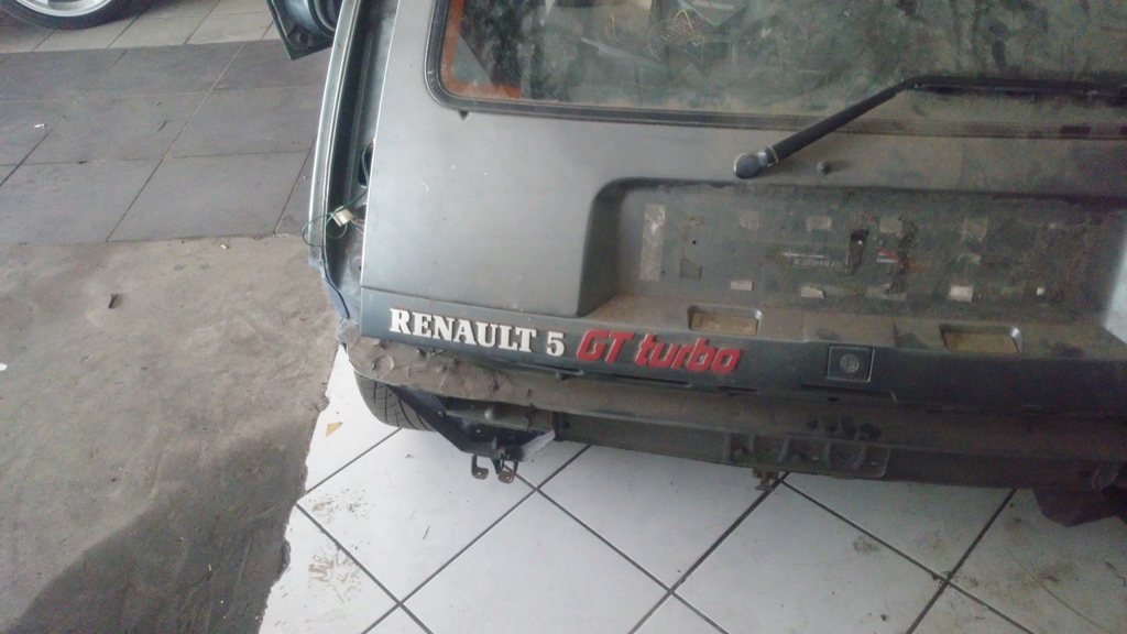

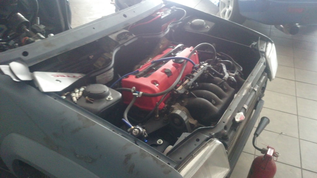

I spotted this knocking about as well.
Normal looking on the surface...
Surprise!
Looked like it was going to be boosted and it looked like they were in the process of moving the entire Honda loom and dash in. Big ass job!

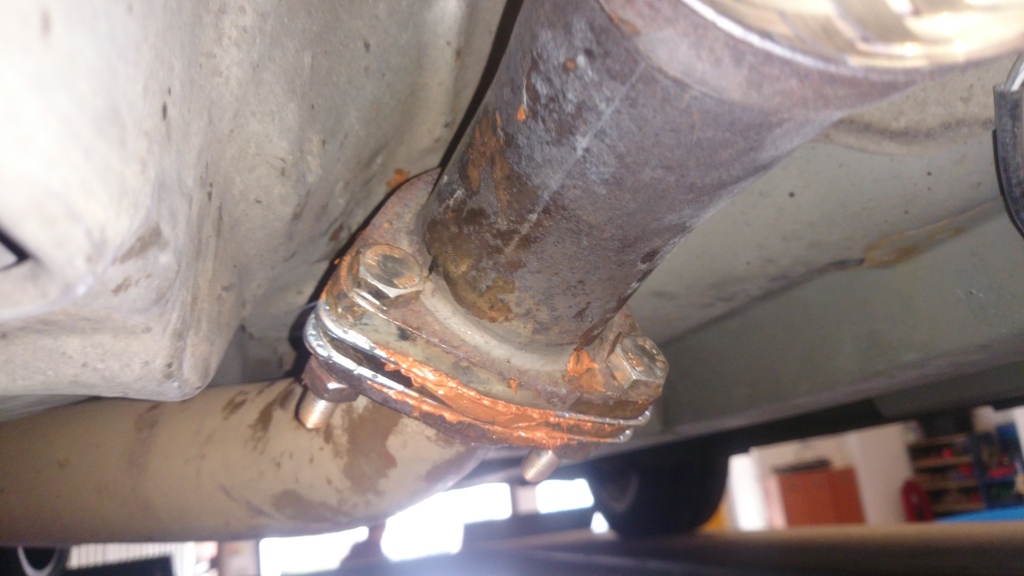

Once the 4-2-1 was on we found it was about an inch shorter than the original manifold and cat were. Personally I didn't care about moving the exhaust back an inch but it meant that the exhaust banged under the car on the overrun and start up. Anyway I acquired a couple of gaskets and a 2.5" triangle flange and put the car on my friends ramp after work one night. A nice 10 minute job. Not the neatest of installs but I f**king hate exhausts and don't want to touch it again.
Doesn't blow, doesn't knock. Perfect.

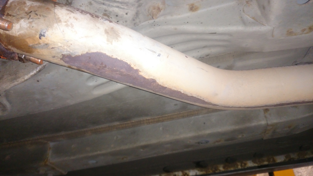

Looks like the B pipe has seen it's fair share of speed bumps mind!

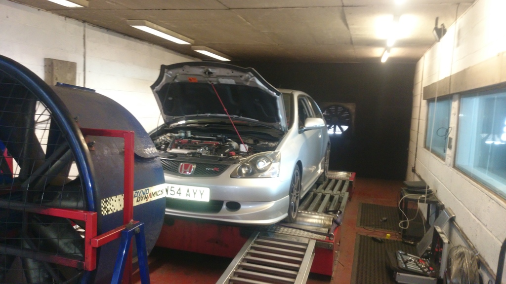

So on the 23rd the Civic went back on the rollers.
They did give me a print out but where in the name of all that is holy I put it - I have no idea!
I gave them a quick call though and conveniently they keep dyno print outs so I'll get them emailed to me.
What I do remember is:
225bhp
165lbft
The figures are a shade lower than I'd have liked but this is what you get for putting a cheaper 4-2-1 on there.
The midrange has had a nice healthy bump but the peak HP would have been nicer had it been higher but I don't plan on making any other power mods.
Eurospecs rollers are also notorious dream crushers so who knows what it'll make on somebody else's rollers.

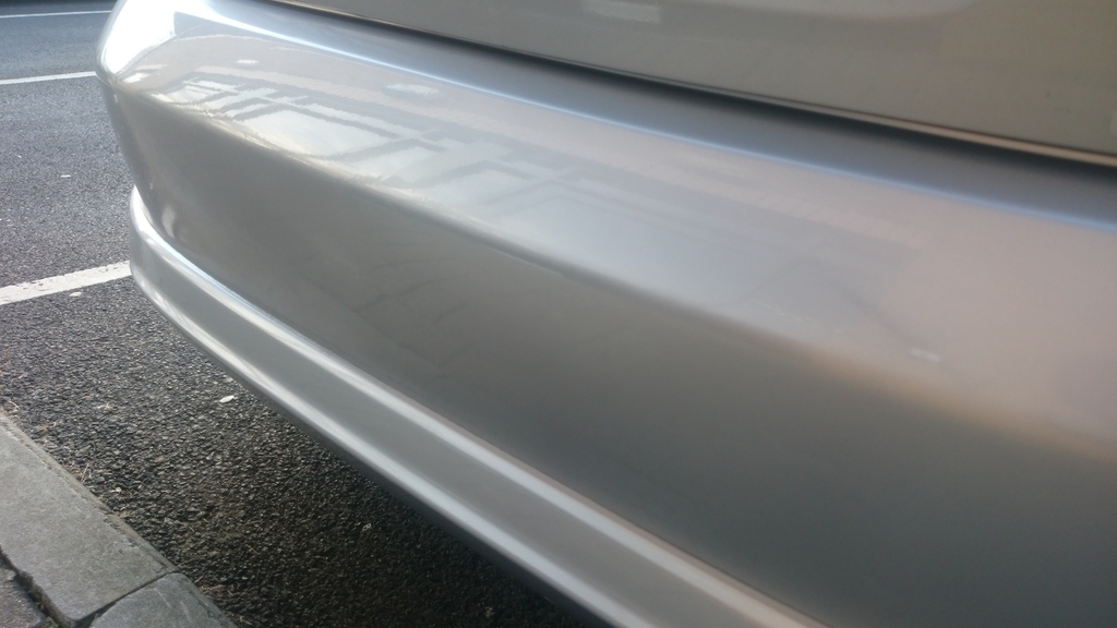

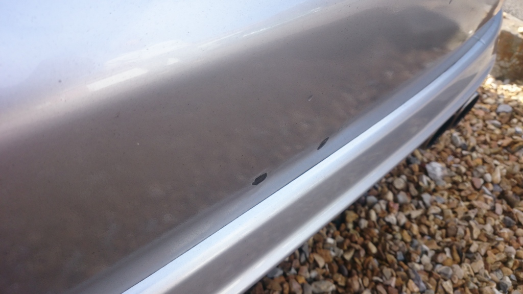

Back around Christmas some fool bumped my car with a trolly. I always meant to get it fixed but I kept forgetting about it.
Anyway lots of people have been pointing it out recently so I figured it was time to get it fixed.
Conveniently a good friend of mine owns a body shop so I left it with him for a day.
It's a 2 day job so it needs to go back for a polish and a final tidy up but it's looking a darn sight better so far.

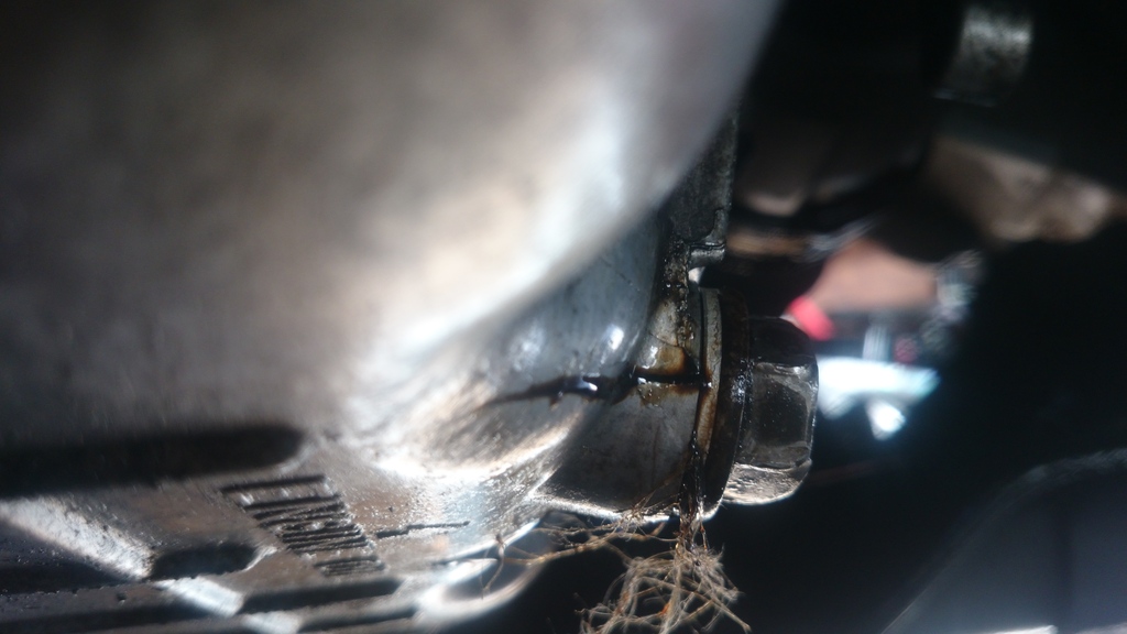

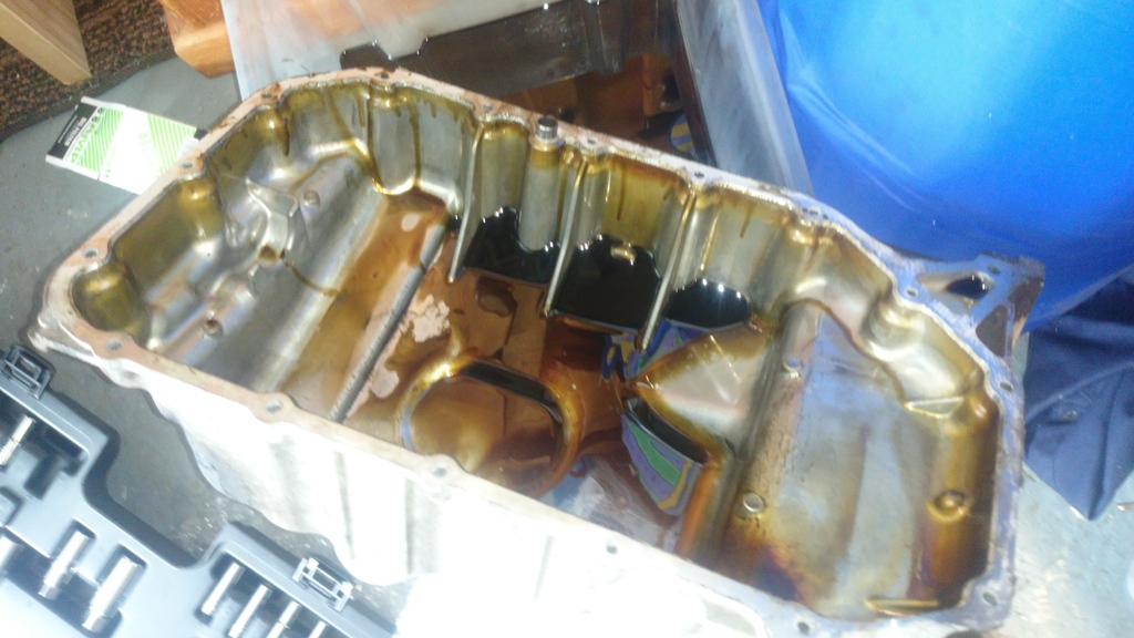

On the 25th of July like a complete nugget I managed to bust my sump.
I'll be honest, I was doing a service and I was rushing and on the phone so I wasn't paying attention to my own brawl so I just kept tightening the sump plug till I heard a *snap*. As soon as I heard the snap I knew it was fubared.
I thought I'd only split the thread so I was going to re-thread it but after seeing how I'd bust it from the side I decided I just couldn't be arsed and ordered a new one half an hour later from a breaker.
Yes that is plumbers hemp. You'd be surprised what I'll try when I'm desperate.
To be fair I had 3 people offer to weld it for me for free and 5 offer to come and help fix it.
I still maintain that I have better friends than I deserve.
I left the car on the driveway for a few days looking sorry for itself and 1st of August I took one of my awfully kind mates up on their offer and in a morning we got the subframe down and the sump replaced. That subframe is in the way of everything on the EP3. That wouldn't be the last repair job the subframe would be in the way of either...

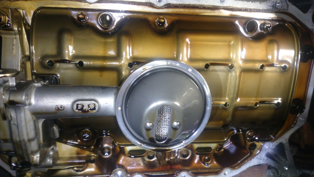

Anyway, one of the old bust sump draining through the crack.
Another one of a pleasingly clean oil-pickup.

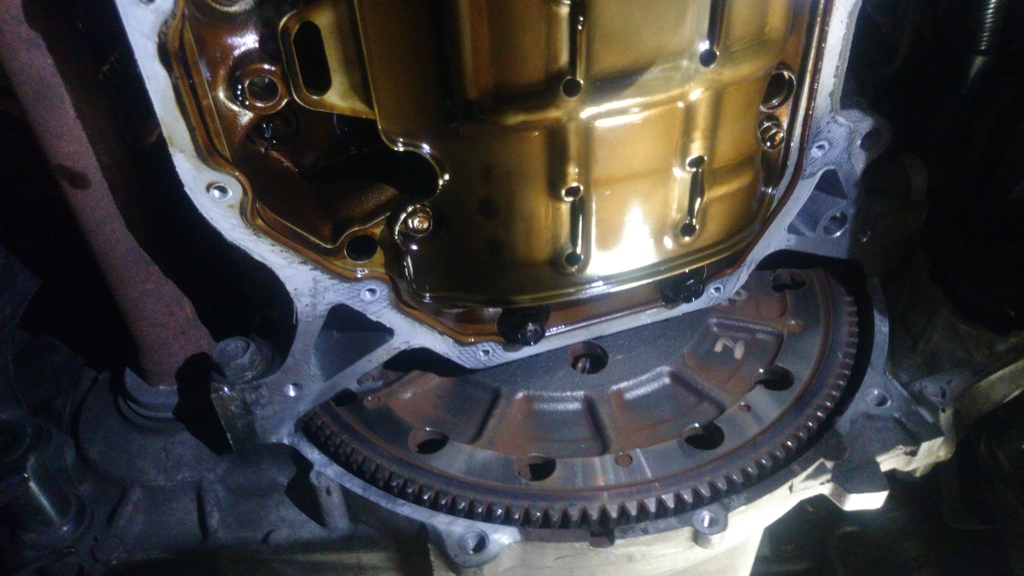

And a final one of the flywheel for the hell of it. Facelifted EP3s get a lightened flywheel as standard which is nice. :smile:

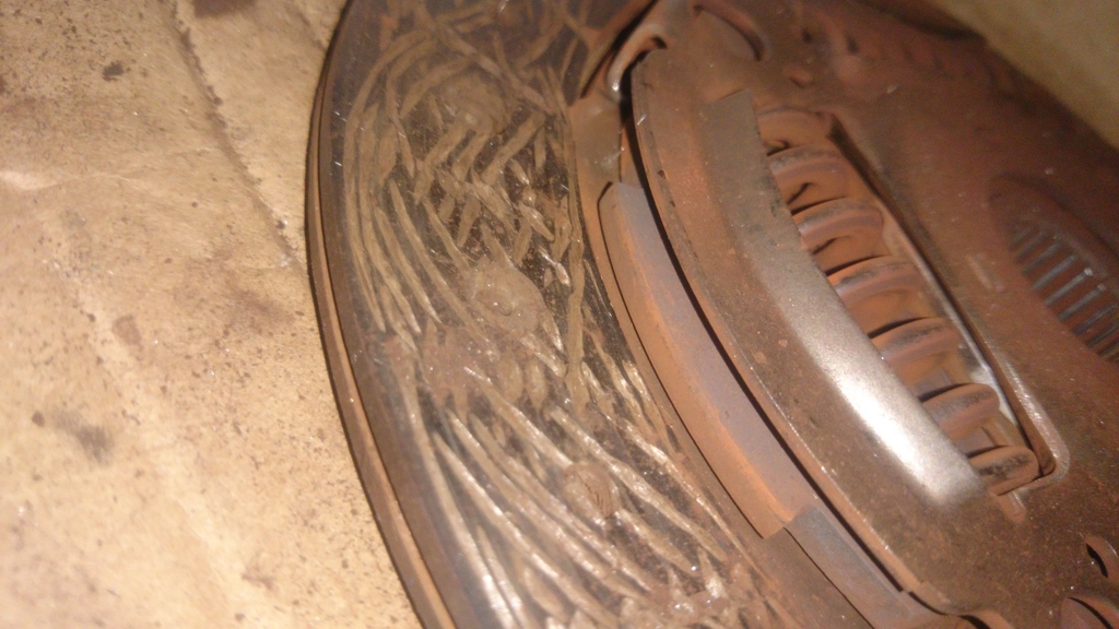

Until the afternoon on the 10th of September the Civic was completely fault free until I was on the local dual heading back to work.
I was accelerating in 3rd, figured I was going to run out of room and decided to drop it into 6th and lurk like a gentleman but found I couldn't drop it into anything.
Ditched it on the hard shoulder and got it going again but it wasn't happy and the box was very notchy to a point where it simply did not want to go into gear.
The fact it was all gears immediately suggested it was either the clutch or the linkage. At a standstill it fell into gear nicely but when moving it put up a fight at anything over 2000rpm. Anyway a bit of research and some prods in the right direction from the Civic Type-R forum (yes there are other forums beyond ClioSport :wink:) suggested the clutch wasn't disengaging and lots of folk suggested a spring was probably rattling around in there.
Did a bit of research on a DIY clutch swap and it looked a dick of a job to do on the driveway.
See for yourself here.
I know it's a link to a DC5 site but whatever it's the same engine bay!
TL;DR - To get at the clutch the whole subframe needs to come off, ARB, battery & tray, exhaust, the lot.

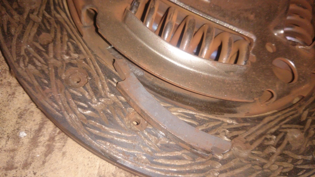

Anyway a friend of a friend likes to race Hondas and is regarded as an expert so I left the car with him on Saturday and he smashed out the clutch change in under 4 hours. :fearscream:
How the clutch is meant to look.
How mine looked. The owners club was spot on.
The material had another good 20k left on it - it had done well considering the 10 years of abuse it's had to put up with.
Fair play to the man though, the car drives like a completely new machine and the clutch is now very light. Absolutely blown away by the machine all over again. Upshifts are as smooth at 8650rpm as they are at 2000.

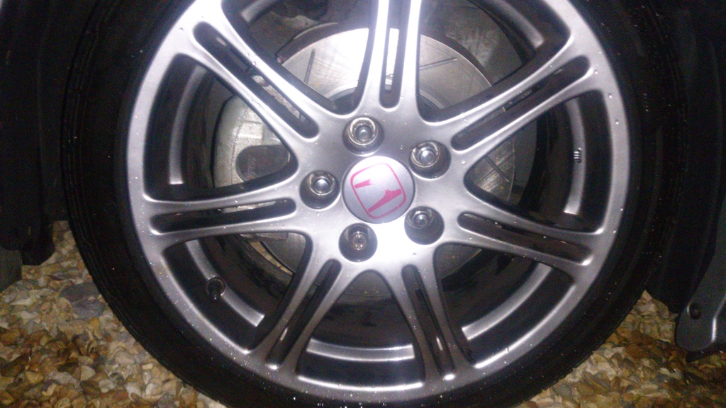

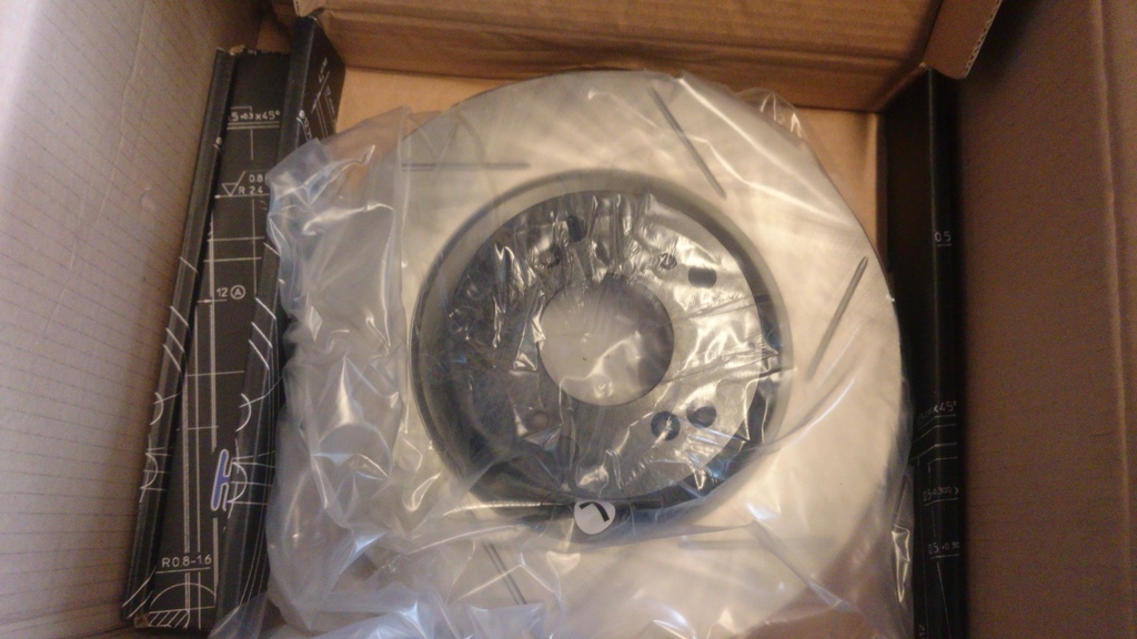

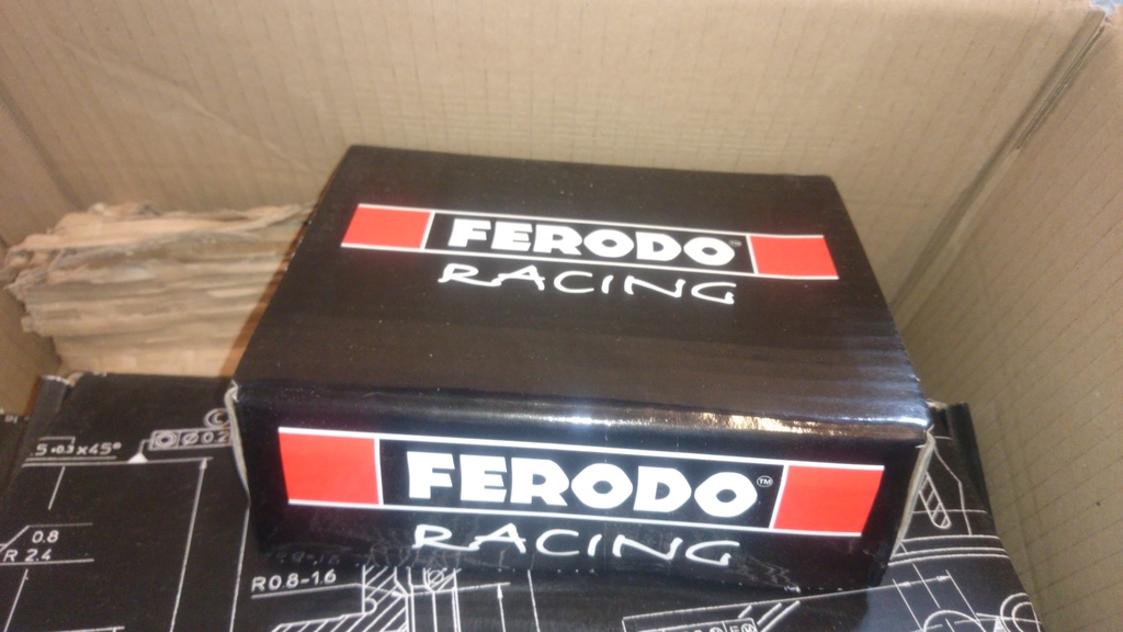

So another kind friend popped round and smashed out a brake change.
Brake set up is now:
  • HEL braided lines all round
  • ATE Super Blue Fluid
  • Stoptech discs on the front
  • Ferodo DS2500 pads on the front
The combo is about as good as you can get using the standard callipers.
Yay goodies!
Really should have taken a shot of it minus the wheel, but I forgot.
Jobs take 2 days rather than 2 hours if you take lots of photos!
The more observant of you might have noticed the TRW shim.
