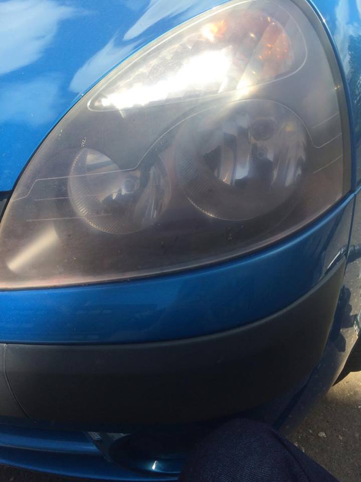

I've just had a though, if a wet and dry my headlights good and proper and polish them, will I have to use some sort of UV protector/sealant after the polish or is just a polish good enough?
leeds2592
  Bean 182 + E70 X5
You're best off using a UV sealant as with time they'll end up getting bad again as mine have done.

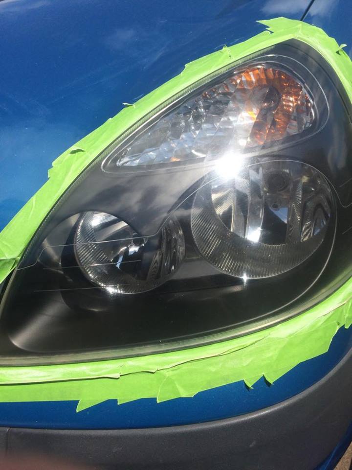

[Update 4] – Lights are restored and airbag light is fixed!
On the list, today:
- Wet & dry the headlights to restore them.
- “Renault fix” the passenger airbag.

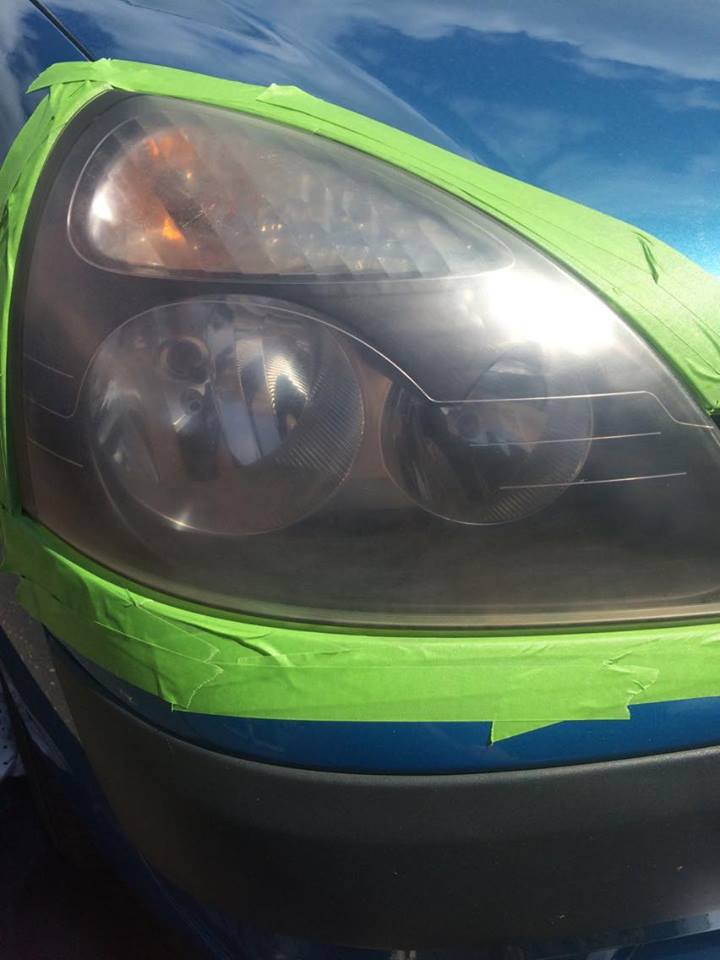

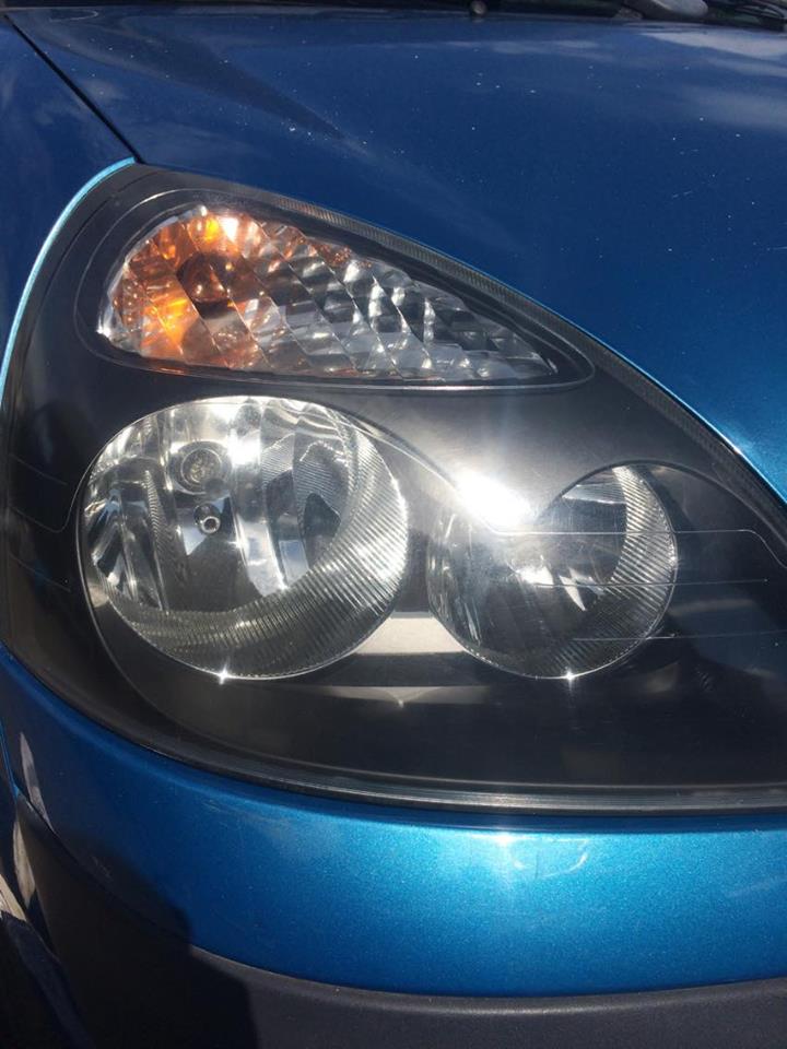

Lights:
Decided to pick up the Auto Glym restoration kit, BEST £25 IVE EVER SPENT!
Lights were looking dire this morning in the sun so I decided to get myself to Halfords and spend some time on the lights. All in, I spent 2 hours doing them because the drill I was going to use was dead, so I did it by hand… and what a bloody result in the end even doing it that way!
Before I did anything to them:
After the job was done:
As you can see, they turned out hella good! I just wonder how long it’ll last before I need to do anything to them again?
