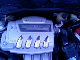

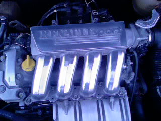

Started polishing my inlet manifold still needs some more work but have spent a while getting it to this stage.

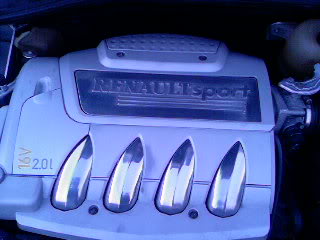

with the cover on
cheers

lee742 said:
looks good, what r u using?
its all done by hand, using sandpaper, different grades then onto wet and dry paper using finer grades till the main scratches dissapear, then metal polish to finish it off. did most of it about three months ago just doing bits at a time

looks the dogs mate!! good lil project you got goin on there!!! :D Im thinkin about doin my Manifold and Rover Cover on my Valver!! Wat tools did u use.. brush on a drill????
  Valver..
ggggg..... is one arm now bigger then the other!! he he ! wat kind of sand paper..wet and dry.. or emery cloth using corse then movin onto fine???
  Golf R/Leon FR
yeah just used really corse sandpaper to get the abrasive stuff off then kept going to a finer grade then onto wet and dry and doing the same,

clio head said:
good job... do u have to put a coat of laquear on it. to keep it shinny?
no just polish it with some metal polish then with normal polish i use autoglyms super resin polish.

i took it off now and then but havent for ages, i had the inlet off for a bout 3 days to do most of it with sand paper, but just leave it on when polishing!! just take the engine cover off.
  Golf R/Leon FR
yeah ive not had any problems doing it my dad did it for me the first time as i was buying the sandpaper!!

howie p said:
how long does it take to do, hours wise....
to get it to that stage it took me about 12 hrs all in all.
as for using a detail sander i didnt have one but enjoyed doing it that way!!
