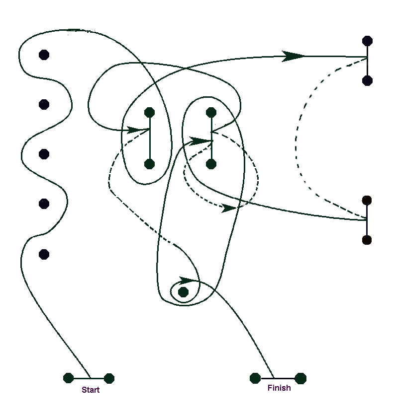

That looks awesome! Never seen auto testing before. What are the rules of that kind of event? Can they do anything, or do they have a set requirement of things to do?
  172 Race Car
You will have to come along to the next one bud, good fun to watch and cost nothing to spectate. They have to memorise the test from a plan (a skill in itself) and are timed doing it. The test will look something like this... iirc the dotted lines mean it must be done in reverse
