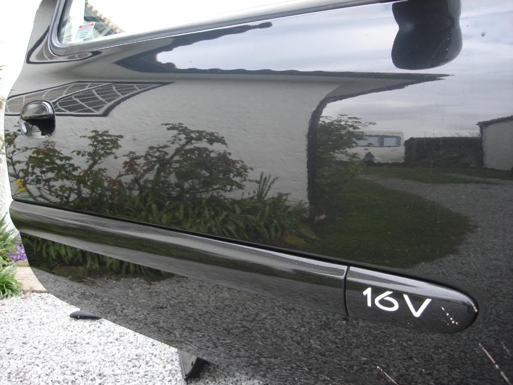

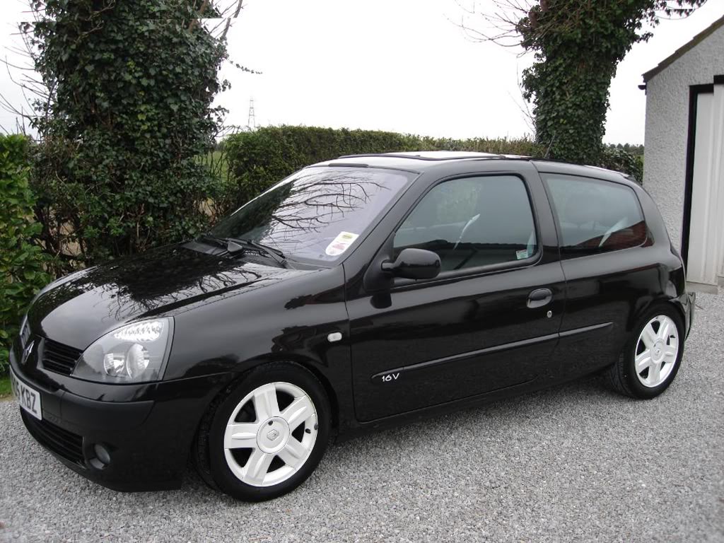

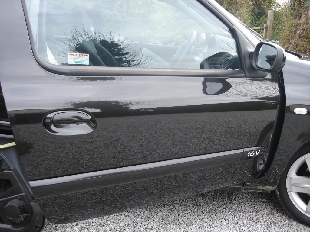

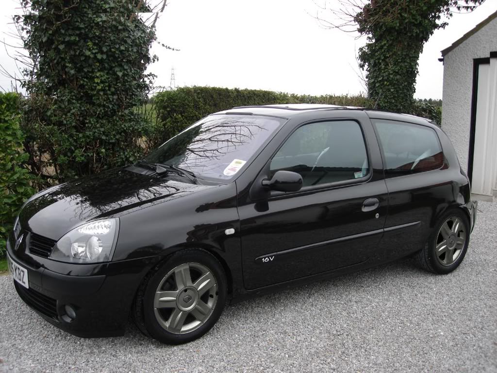

Right im getting better at spraying shizzle. If my door handles end up okay ill do my wheels. Cant decide, prefer anthraicite but i like white also :cool:
  Shed.
lol ok. Door handles need laquer applying now but i might wait untill wednesday to make sure they are completely dry.

Painting is difficult actually, ive not sprayed before, ive managed to bodge something up in one way or another and need to start again, and my inserts are not perfect so i may redo those at some point.

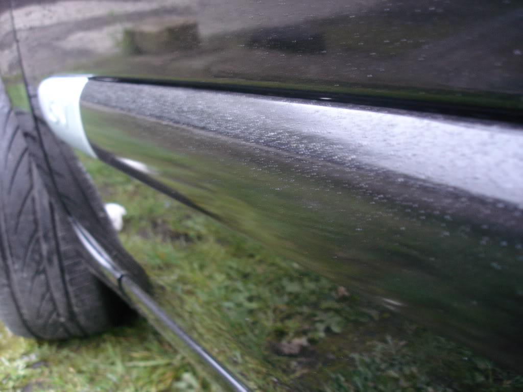

Funny laquer, it goes a bit milky for some reason. had a word with Fm last night, i think its too cold for spraying as im doing them outside in a railway carrage.

too cold defo you need to bake them and they will turn out loads better and then polish them with a cutting compound

yer, applied primer right now, so im guna wait untill its a little better, ive got a halogen lamp which ive been using to heat up the room lol.

i had the same problem the first time i sprayed my side strips. everything was hunkydory until i laquered them in an old damp garage at my grandads house ...ooops! re-did them outside last summer and they came out great! its a f**king learning curve mate!!

Just been and redone mine today, one is just short of perfect and currently drying, the other i bodged up yet again, and is no being primer'd, agian. lol

Go for the white refurb mate :)

when mine went milky i used rubbing compound and t-cut to take the laquer back a little clean it off and sprayed another layer of laquer over the top. no need to sand, prime, paint and laquer all over again!!
