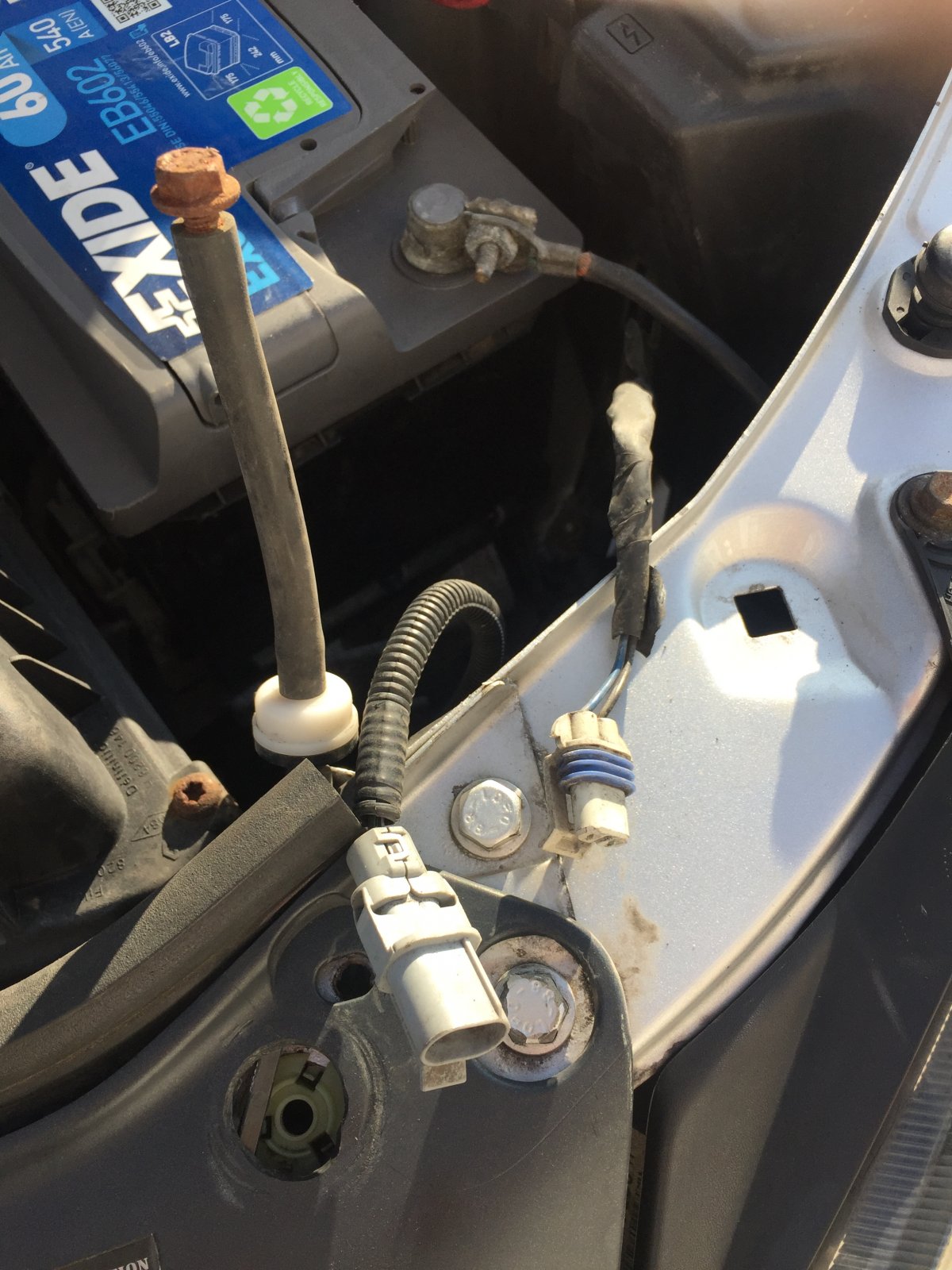

Ok so I have found these 3 leads under the bonnet. Any ideas what they are and should they be plugged in?

They look like the plumbing for the acoustic valve, and possibly a fog light too, in which case you don't need them.

Thanks for the replies.
