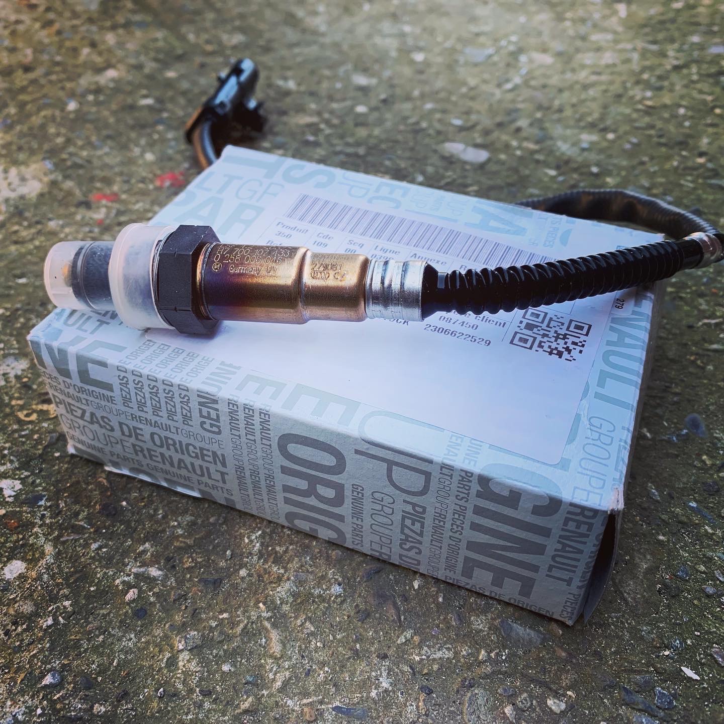

Would anyone have a part number for the Bosch o2 sensors?
Part number 0258006046. These are mine which I bought from my local Renault dealership but it’s effectively a Bosch sensor.
