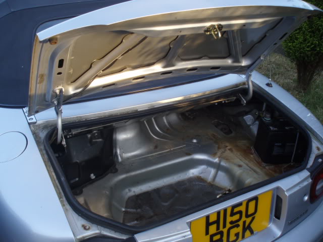

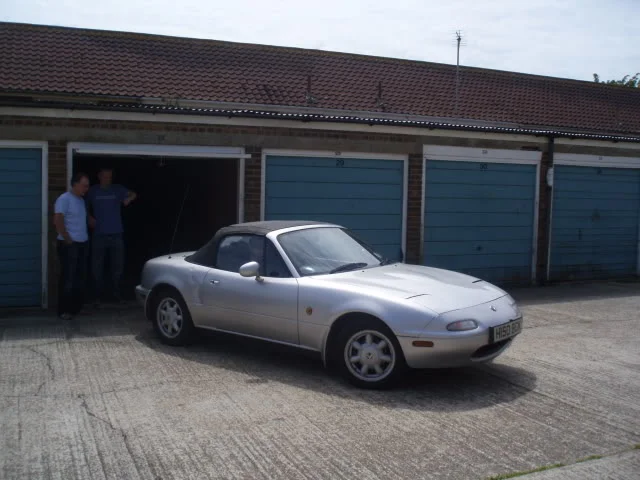

My brother and I went halves on a car we can dedicate purely for track use. A guy at my brothers work was selling this Eunos roadster.
First things first, stripped the boot...
Old newspaper I found!

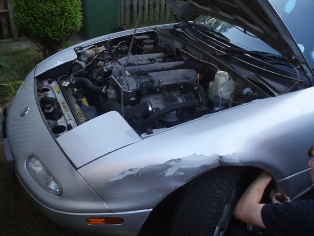

My brother in the process of getting the wing off, new one will be on very soon.

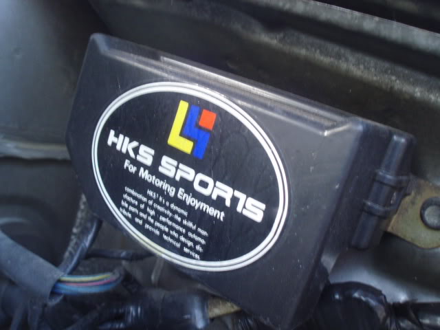

Anyone know what this is??

Have a read up on the MX championship if you fancy going racing. It's a low cost race series that attracts big entries. Great way to get racing.
  182 Cup
To be honest I dont know much about the possibilities. My brother said there is a big following and lots of parts available. I just want it track worthy and to have some fun in it for now!

Looks good. Any ideas whether its got a long nose crank or short?
Just renewed the tax on mine so I can enjoy it for 2 more months of summer before stripping it.
  My trusty lil 182 :)
Great little cars. Not easy to tune without going the turbo/supercharger route but even that's much cheaper than for clios. With it being a eunos, a simple trick is to have the timing advanced. The timing is set for japanese fuel which apparantly isn't as high ron. Frees up a few hp. Also be able to run it decat at that age which helps.
