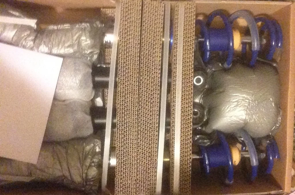

It's only done a few 100 miles since as I've been away but in that time with the advise of CS.net I have bought some AP coilovers.
Worlds worst quality pic below.
So I'm dropping off the car tomorrow back at APS to get these fitted.

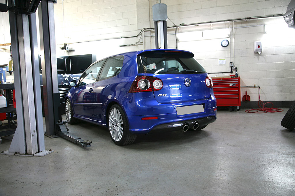

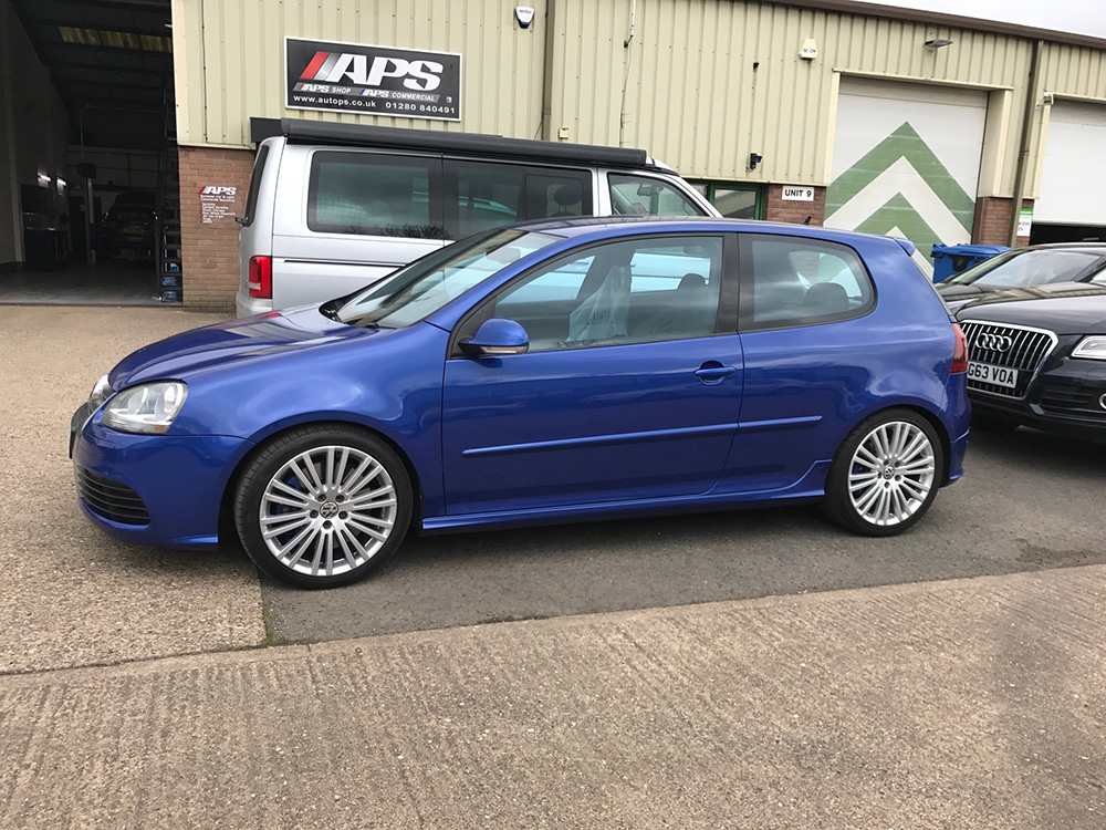

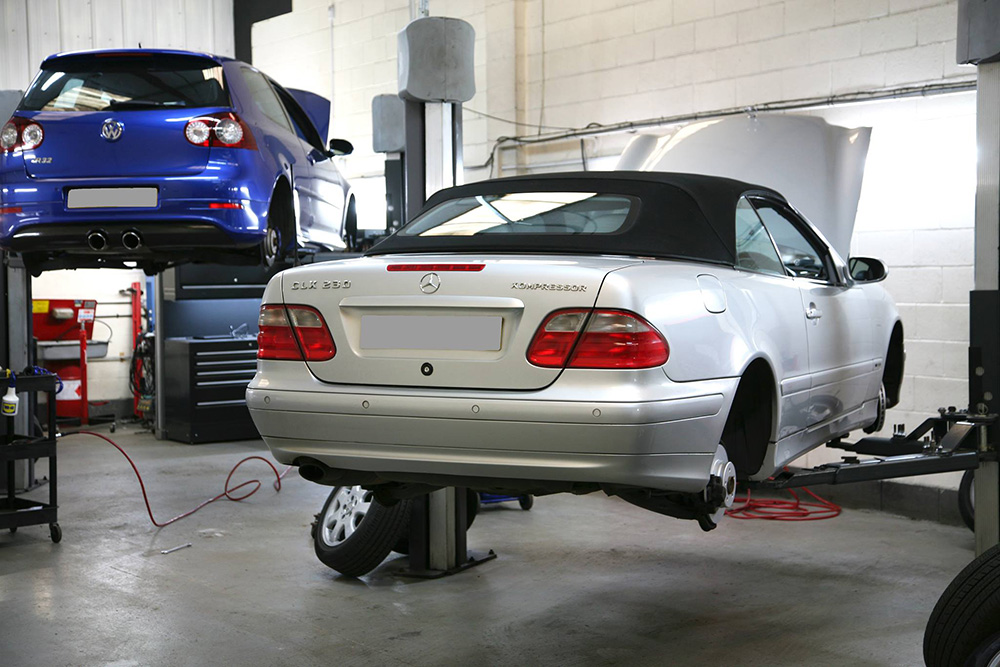

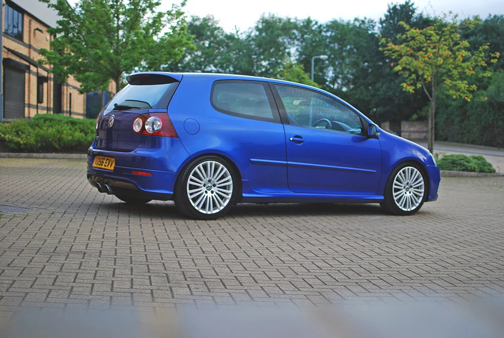

In the mean time I asked for some photos while it was there of how it was say, so here it is. Not 100% sure on height, but I know it'll settle another 5 - 10mm and it's always difficult to tell through photos.

Looks similar height wise to mine at the front, although yours is a little lower at the rear.
_Tom
Looks great although I'd either drop the front a touch more or raise the rear. ( Like Daves above)

Ride height 100% needs adjusting, the OSR seems lower than the NSR and the front needs to come down a bit I think as I'm sure it won't settle as much as I'd want.
It's no bad thing that it needs adjusting as APS would have never got it bang on perfect height without me being there and also they have offered to adjust and re-align FOC which is good.

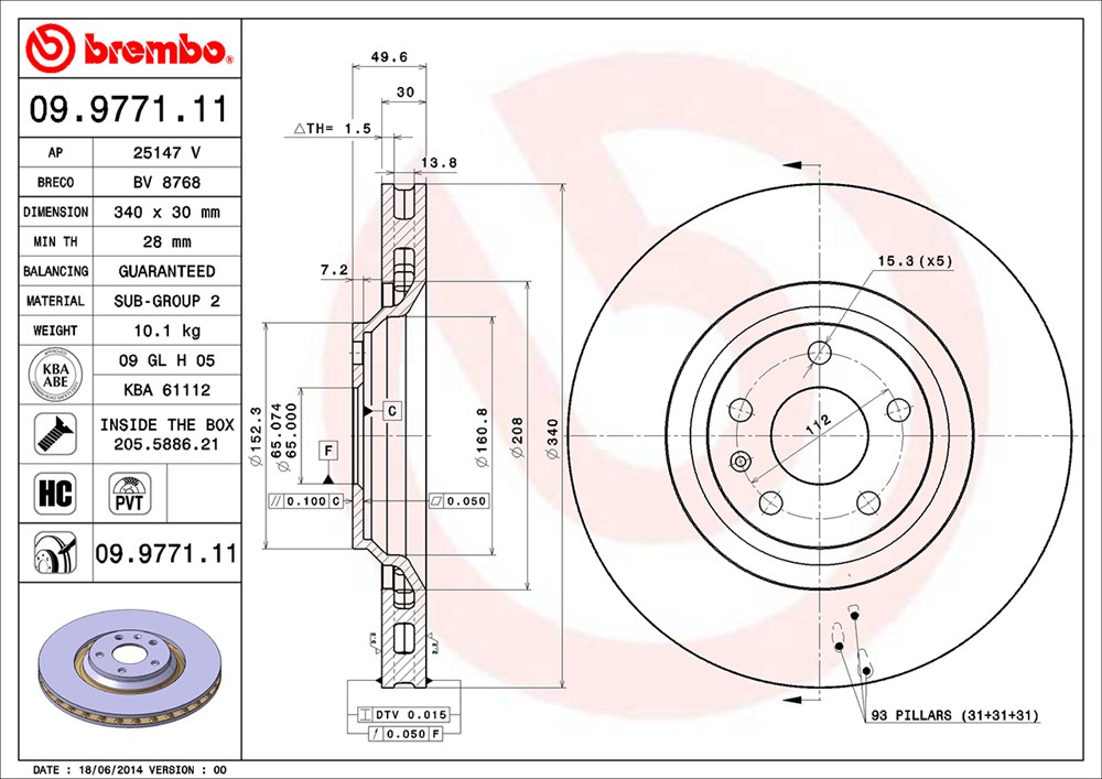

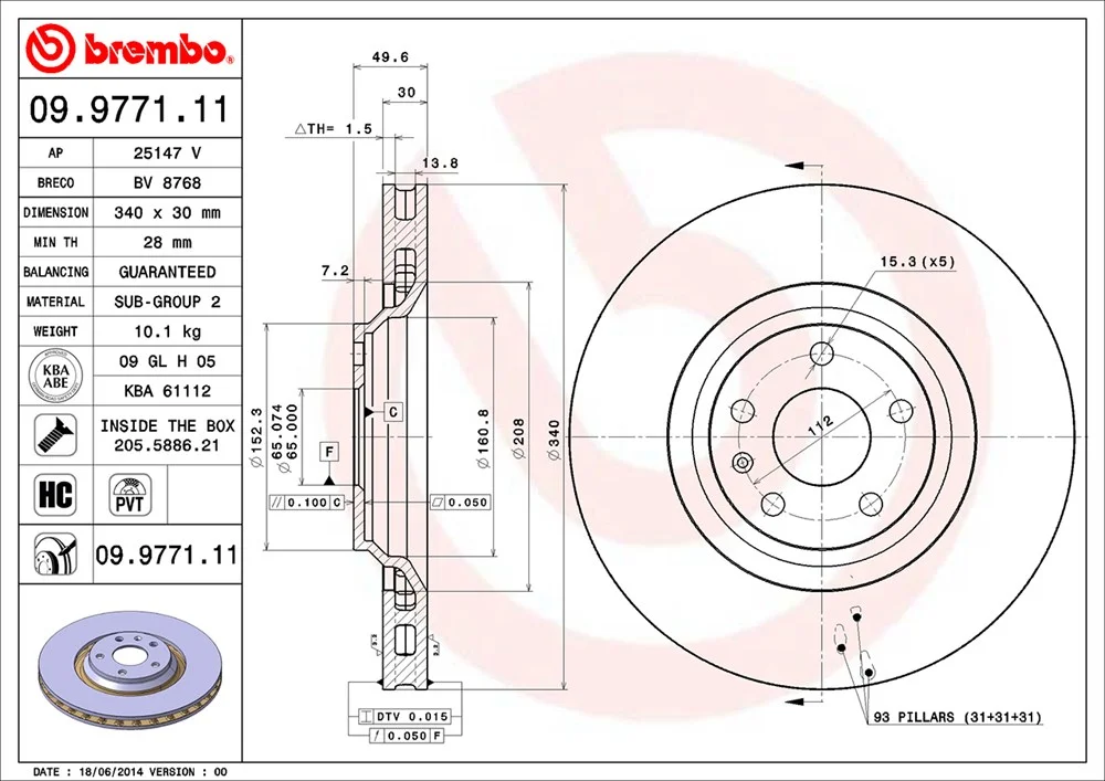

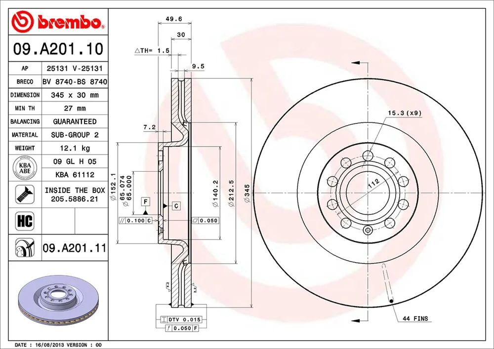

Another easy mod to make the front end more pointy is by fitting 2008-2014 AUDI TTS front brake discs which are 5mm smaller in diameter 340mm V's 345mm, but a useful 2kgs lighter, 10.1V's 12.1kgs,
reducing unsprung weight. Both cars use the same brake disc and an added benefit of slightly smaller diameter disc is pads run up to the edge rather than sit inside it making a lip as the disc wears down.

Would definitely do the discs, although unless I keep the car for "future classic" purposes, the current discs will easily last the life of my ownership.

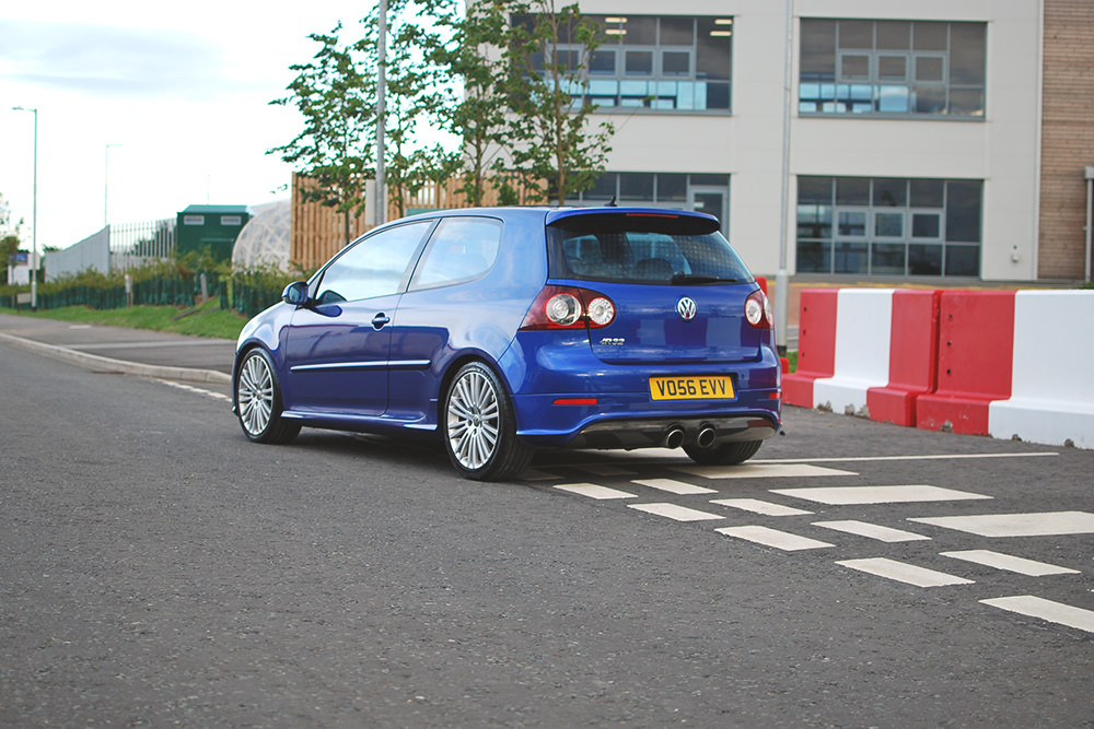

Lowered the front down today another 10mm. I think it sits perfectly now, will get some photos tomorrow.
One thing I noticed is that on the front side to side there was a difference of 2.5mm, do you think this was on purpose (driver/GB/engine offset)? Or sloppy installation? I also noticed that one of the collar locking gubbens was missing and that the other side, it was not tightened, just sitting loose in the collar, could the heights have changed from these lockers not being tight? Or do they not do much?
Went out for a blast after dropping it down some more to make sure it wasn't scrubbing and I only got a little hit when turning hard left at speed while going down a slight dip. So pretty happy with that.

That looks great now! Sitting perfect.
Thanks, I'm happy with it now, just need to get it re-tracked and it'll be reet.
