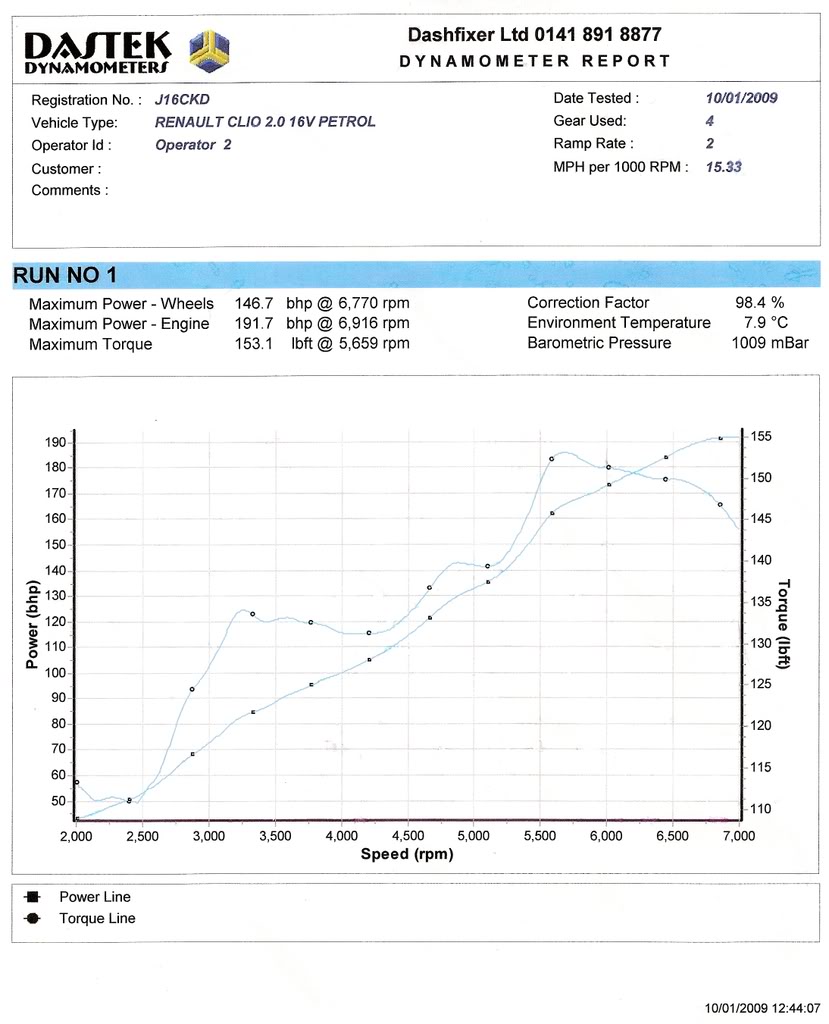

Those results look good
What remap do you have ?

GRRRR!!! i took it to a good dyno....paid the money....seen it done....got this print out!!!! i,m no f**kin dyno technician

in reality that's probably putting your flywheel power in the mid-to-late 170s.

Panel filter and a custom cat back system but ave never bothered putting it back on a dyno, dont really believe in them![]()
Calm down!!!
We're just pointing out that;
a) you have a good genuine ATW figure
b) in reality that's probably putting your flywheel power in the mid-to-late 170s.
power at the fly is a calculation
on the screen there was no sign of ATW bhp he said to me you have 191.7 at the flywheel we will calculate the ATW so could it be a wrong calculation in there part???
