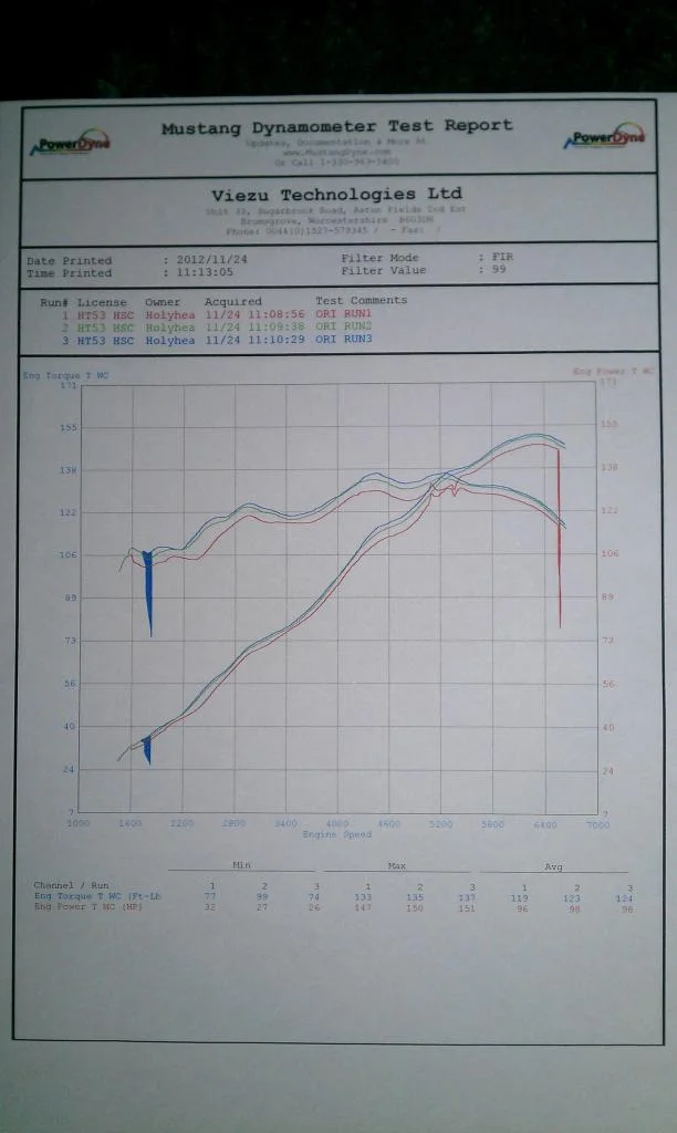

Bought my Cup about 3 weeks ago now...
she's been to Fred who basically gave her a clean bill of health but advised me to get her on the rollers.
Today i did that at Viezu, nice place with some helpful guys on hand. They told me she ran sweet as a nut, pulled in a straight line without any issues.
I had no idea what numbers she would produce at the wheels so i was neither surprised or disappointed when i was told 152bhp.
I would like to know the thoughts of the masses really about the results she turned out today, im happy with the way she drives etc etc which is the main thing.
So i guess as a noob im asking for a thumbs up as this is the norm for a 53 plate, 32k miles, BTB cat back and Powerflow Panel Filter.

you're looking at roughly 25bhp loses on a standard car (give or take depending on tyre condition and pressure, geearbox condition and oil temperature and a few other things)
that would make this one 177 at the fly, which is either a strong car, or over reading a little (I've no idea on Veizu's usual numbers)
160 ATF would be very high, I'd personally expect 145ish

Those are higher results than I got :( (also a 172 cup) so I'd be quite happy with that :)
As mentioned above we had a rolling road day there with West Mids group a few months back, afaik a few members did get a bit higher but iirc they also had rs tuner maps and such like.

Sounds about right when we had our meet at viezu most 172/182s ran from 148 to 156 atw.

RSTuner is a great bit of kit well worth it imo. But it only improves the overall driveability not BHP (Maybe 2bhp if you are lucky) it raises the rev limiter slightly too. when we all went to viezu every clio was run to peak power 6650rpm iirc.
So there was no benefit of having an RSTuner map over someone who didn't.
