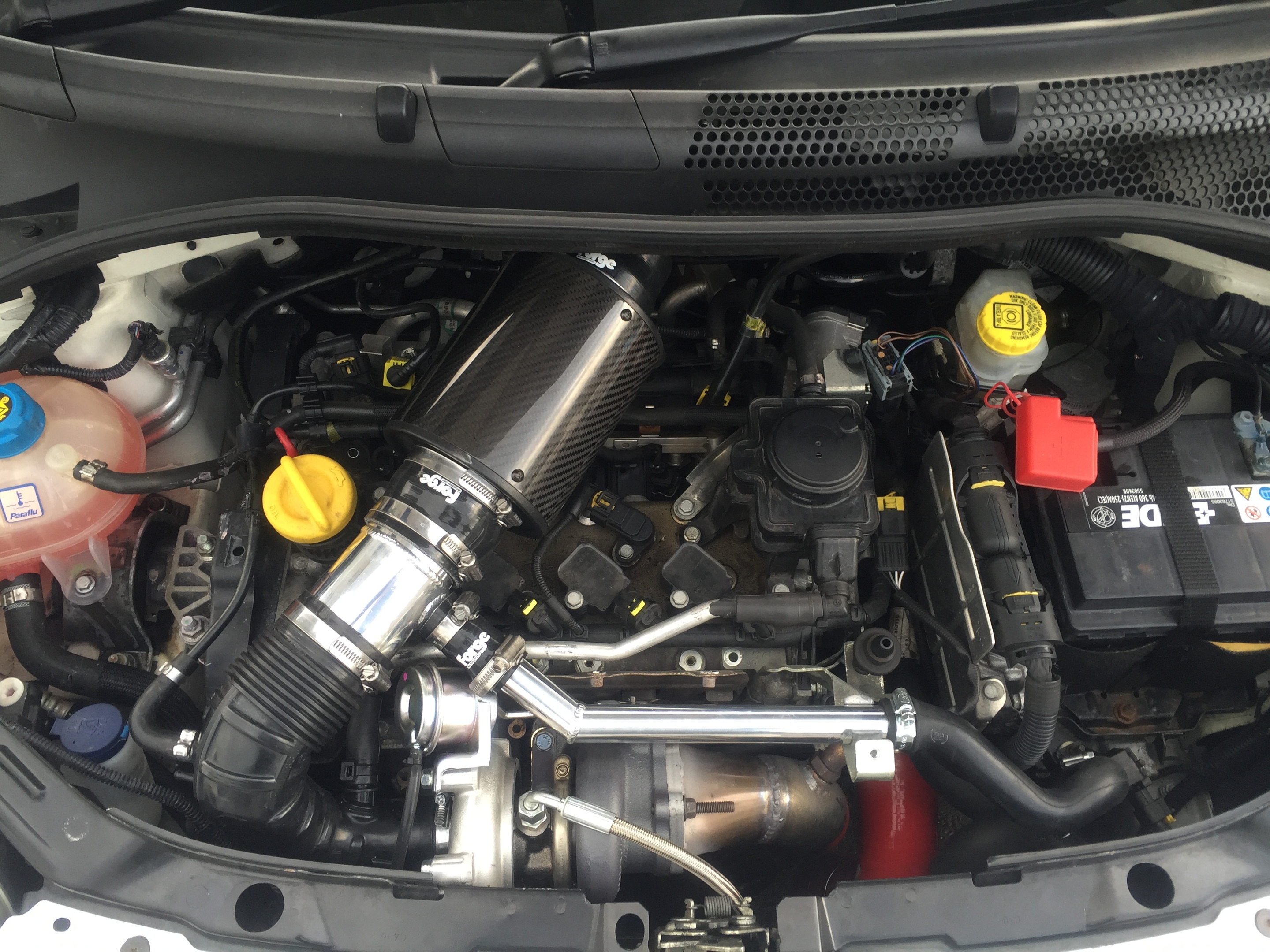

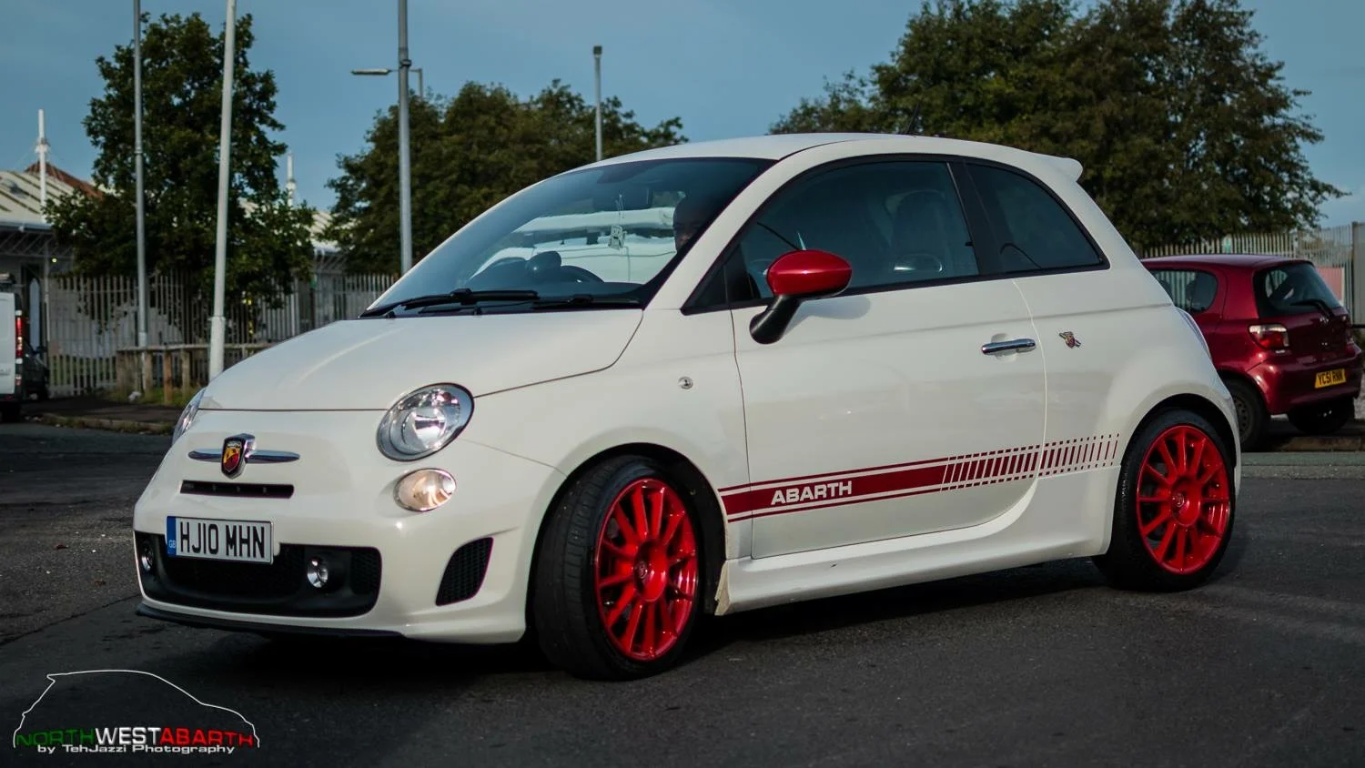

Had my Abarth 500 SS for 18 months now but only recently started fiddling.
Had the wheels sprayed red and then got a TD04 turbo, 200 cell cat, 2.25 inch stainless exhaust with a middle silencer, Forge Induction Kit, Airtec FMIC, uprated injectors and Assetto Corse boost/MAP sensors
Work and mapping were done by ProAlfa in Watford, these are the go-to guys especially for mapping on these.

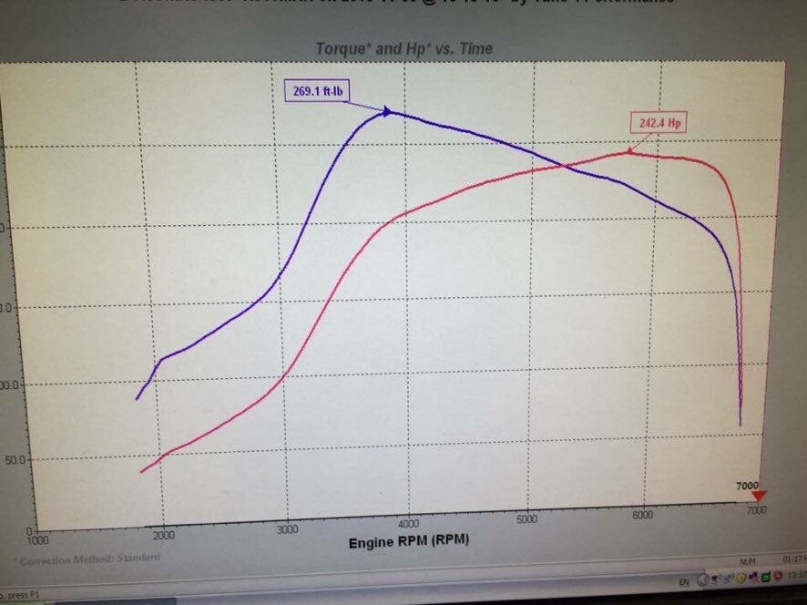

I always loved these even when I had my Inferno. It was a healthy 164bhp/216lb-ft when I last had it on the rollers and went well. It's a little animal now though!
Next up is a brake upgrade once I've finished these off, and Bilstein B14 coilovers :D

They were standard SS white before but I recently had them done in red to compliment the mirrors and stripes.
The front tyres are Falkens which are ok but don't have long left on them. It's managing to put most of it down without too much hassle when the road's dry. I reckon it'll be no problem once I get some fresh rubber next year, probably PS3s
They were standard SS white before but I recently had them done in red to compliment the mirrors and stripes. The front tyres are Falkens which are ok but don't have long left on them. It's managing to put most of it down without too much hassle when the road's dry. I reckon it'll be no problem once I get some fresh rubber next year, probably PS3s

I'd have thought you'd be at more power with the different turbo?

Really? Did you see the graph? Won't get much more without going forged. And I'm well aware that 200s are far better drivers cars. I find the SS brakes cope reasonably well when they're nice and warm and they performed fine for me at the 'ring last year (of course with less power). I will be upgrading them once these pads have died though

These can happily make more torque with 300lb-ft being about the limit for the standard gearbox. Power wise though it's in the sweet spot. If I wanted more it's an engine-open job!
