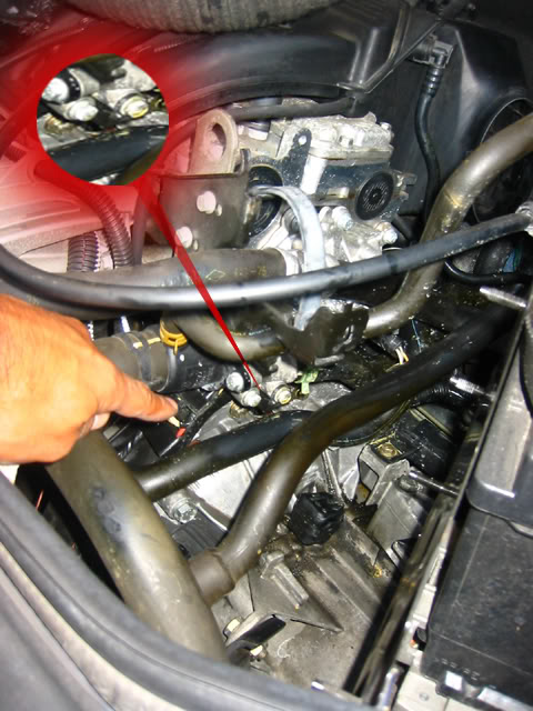

I'm a new member on your forum, and i want to say i have learned so much today already, i have searched a lot of threads but couldn't get my finger on what i was looking for maybe i didn't look well but i'm asking you to help out on this issue i have a tunned Megane that i just installed a Clio cup 172 engine in it i baught everuything i might need from gauges to interlanal wiring and the engine wiring and off course the engine with ECU and the ignition key, i'm facing a few problems but let's take it one by one i was looking for the cranck sensor for this engine can anybody tells where me i can find it: does it come on the gearbox or n the engine ? and if any pix is available to help out i would be more than glad.

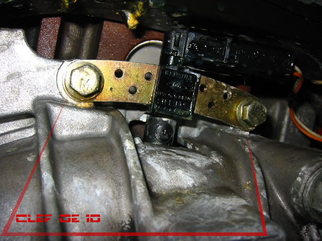

Crank sensor aka TDC sensor is ontop of the gearbox bell housing, tucked up against the engine, near the airbox.
Thats what it looks like, these aren't my pics but Hope it helps
