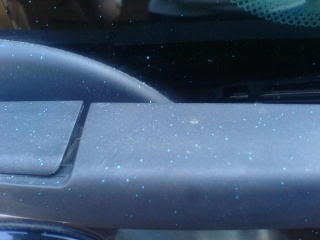

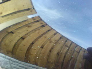

A while ago my little bro decided he would try and spray paint some parts on his bike whilst my car was in the drive :mad:
As a result i now have a 2 tone boot can anyone help me with how to remove this?
I did a search but didnt know whether or not the rules for general overspray applied
Any help is greatly appreciated
Pics: Sorry about the bad quality (camera phone)
I would think an agressive clay for the glass, maybe some Auto Glym Tar Remover for the paint work?
Not sure what to use for the plastics.
try using a bit of white spirit on the window and wiper arm, donno about the piontwork tho. i used white spirit to get the paint of mine
the paint would come off with a quick wipe of thinners then a polish afterwards.
thats what id try first
failing that, quick wetflat then a mop with g3
definatly use g3 it is really great stuff but be carefully as it will burn through the paint really fast use water pevent too much friction! good luck
+1 if its just arosol then it will come off with a bit of elbow grease and some thinners on a rag and on the glass try some wire wool
