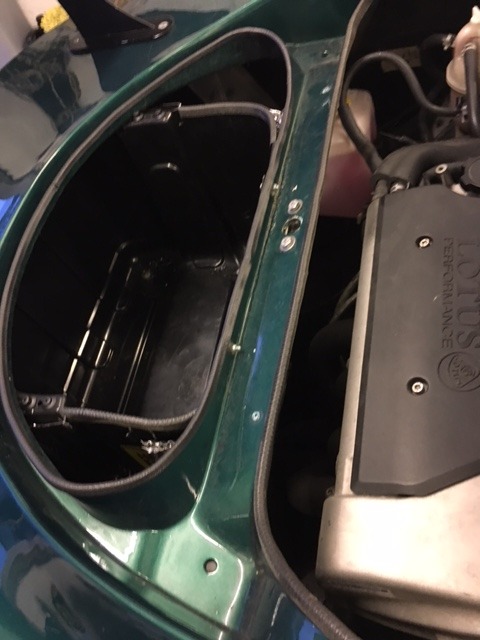

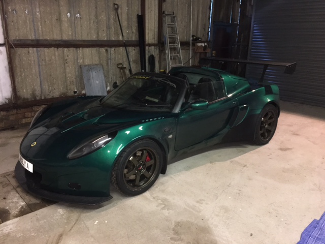

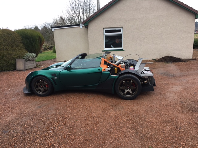

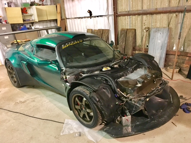

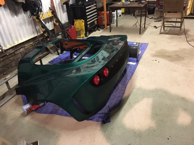

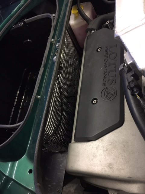

So today the car came to bits, and is now in the rebuild stage complete with now having a boot/storage space .
Looks cool with the roof off.
Rear spoiler,roof and rear clam removed
Rear storage box , front is covered in a double layer of heat barrier with around 2" of clearance from the manifold. Still have access to the battery and have air flow either side to allow heat to escape through the rear vents.
Rebuild started with new seals around the top of the clam

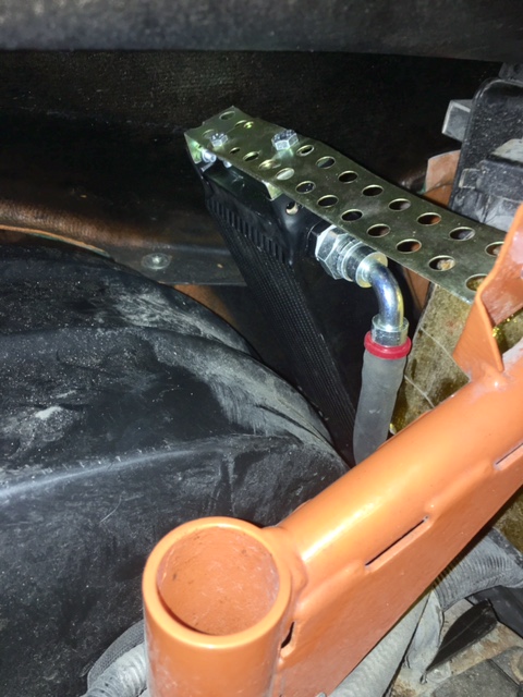

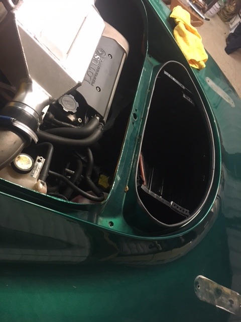

I have also mounted a 16 Row Mocal oil cooler in the nearside vent , and fitted a baffled sump . Cooler take off will be here tomorrow then I can get the piping finished for that.
neil a
Oil cooler is now fitted in the nearside rear , I will monitor temps and if needed vent the arch liner to increase flow.

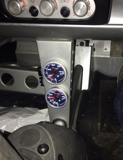

Gauges now fitted and wired

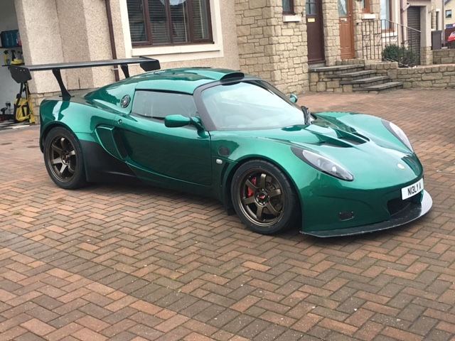

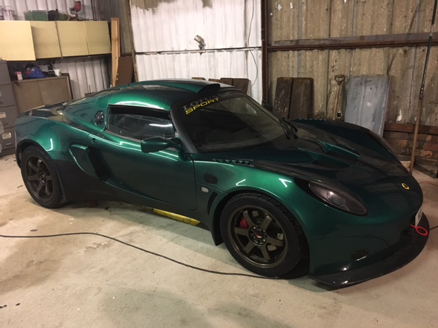

Ive also added extra bracing to the front splitter as it was flexing above 80mph and actually hitting the road, I also had to modify a front tow post to work with the gt3 clam.

Had the car out today and happy to say the front end no longer flexes and hits the road and can now stand on the splitter .
Ive still to make two little trim pieces for the side of the boot box, but atlas now have somewhere to put stuff if going for a run or to a track day.

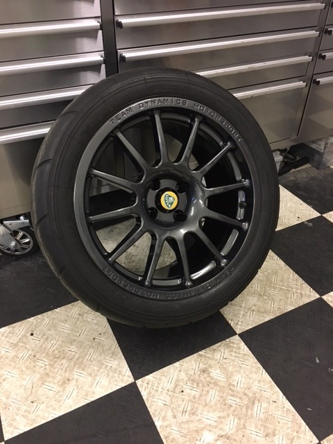

Another big thanks to wheelcoat for the 2 day turn around on my wheels even though I said no rush lol

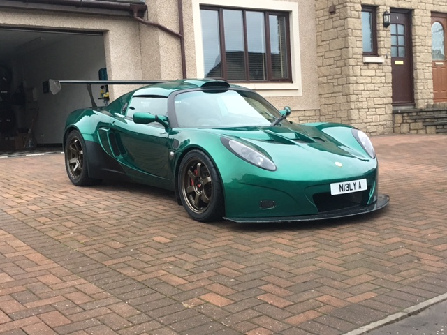

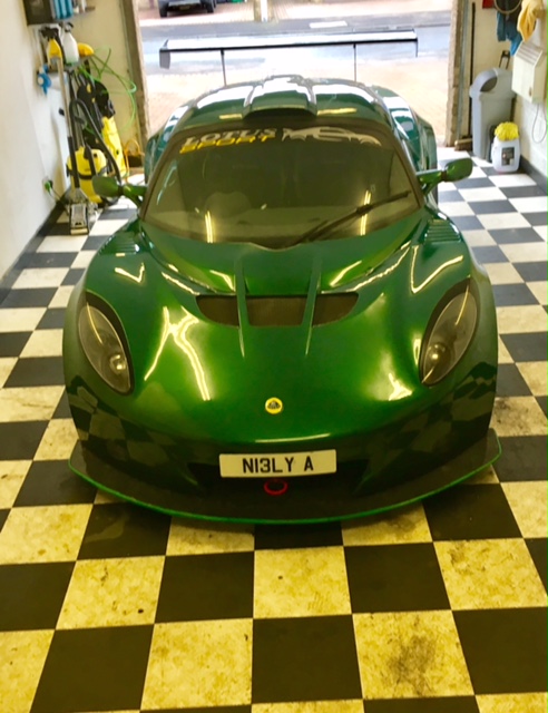

Tried something a little different on the front , mainly to cover up a bit of damage to the front splitter from where it has hit the road not sure if i like it or not .

Lol. That splitter is just ridiculous.
It is fairly huge but actually not too bad on the road I clear the same speed bumps that I did in the Porsche. The splitter leads onto a full flat floor and rear diffuser. I now have the mid tray fitted under the engine with naca ducts to feed air to the sump and gearbox.

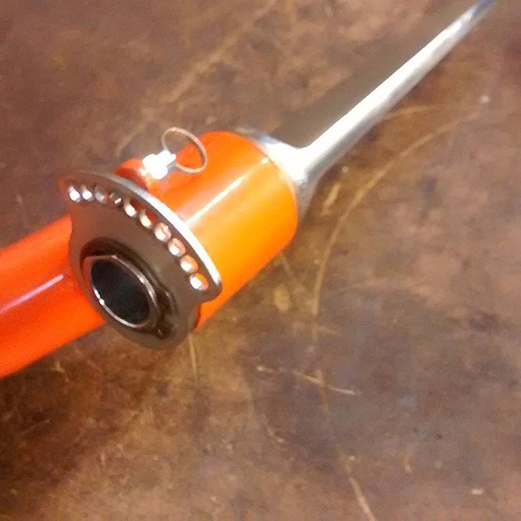

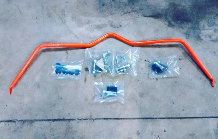

When I bought the car I new the previous owner had the Nitrons revalved and spring rates change by corneringforce , what I didnt know was this was only part of the package it should have had.
The package Corneringforce had put together was meant to run adjustable front and rear roll bars , standard they dont run a rear. By running adjustable bars you can run springs that are a lot softer than would normally be used to give the best mix of road and track use.
Front bladed bar can be adjusted in second on the car
Rear is 3 position adjustable like the whiteline clio ones

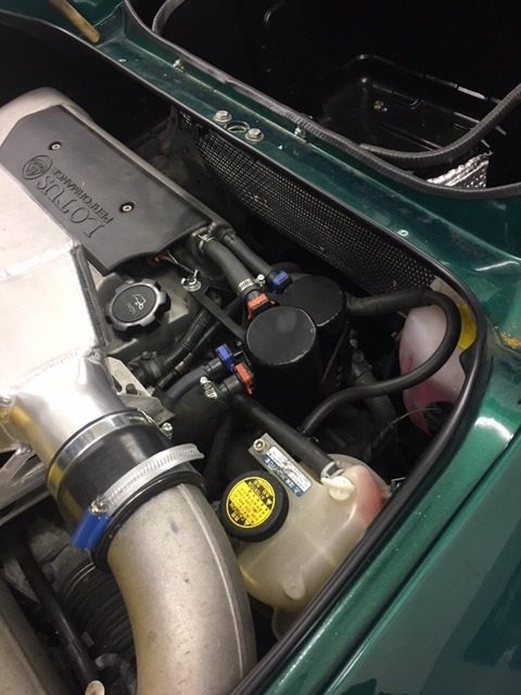

I had heard about these engines breathing heavy so thought i would be better to fit catch cans if I'm going to track it , went with Sector11 quick cans.
Look to be well thought out as far as separation but not overly impressed with the fit, I'm not sure if there as meant for NA cars as one of the hoses rubs on the intercooler mount bracket so will have to mod that a little.

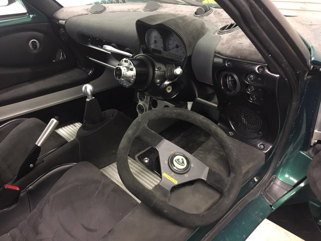

Also fitted a removable wheel to make getting in and out a little easier.
