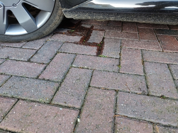

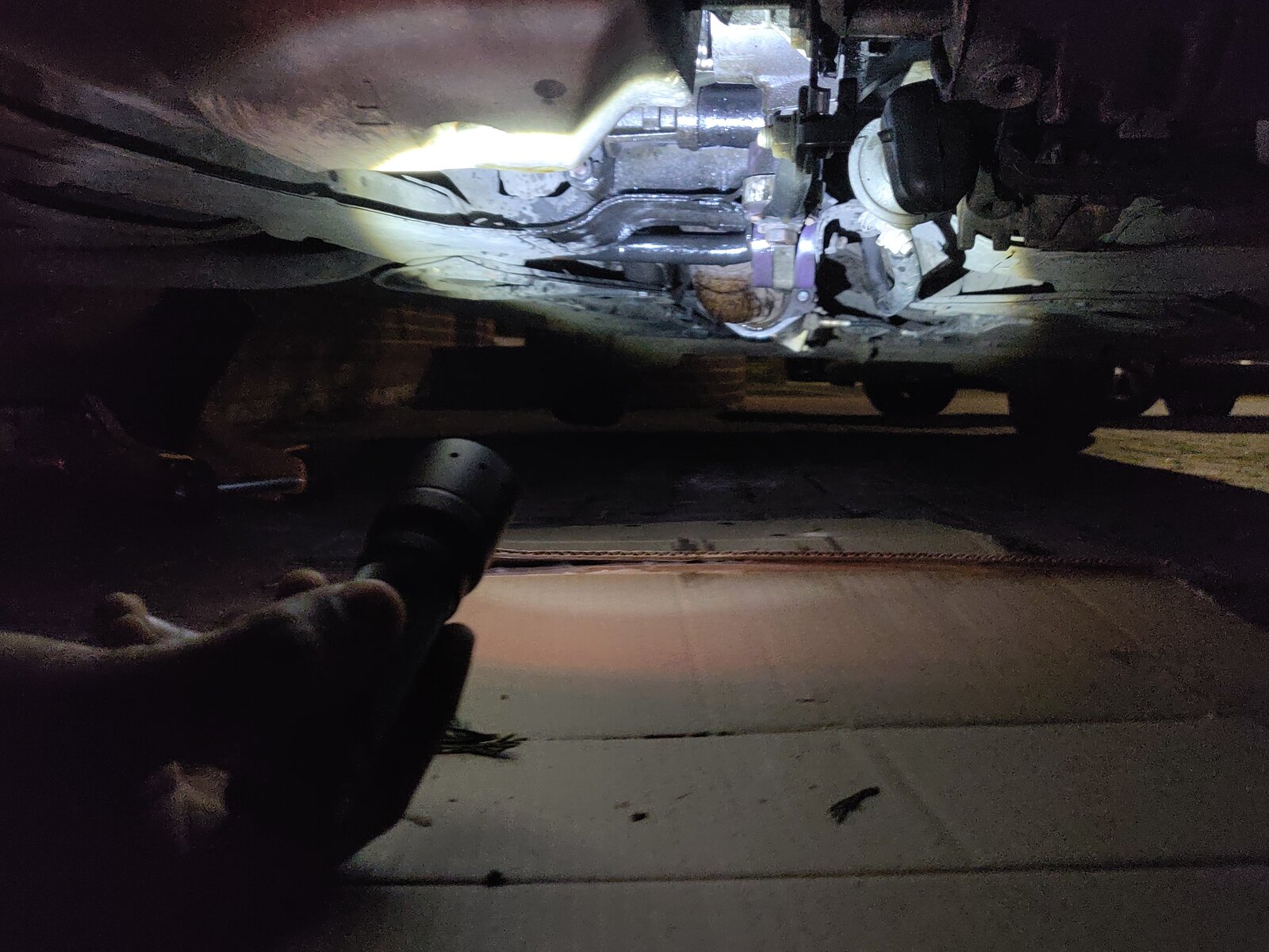

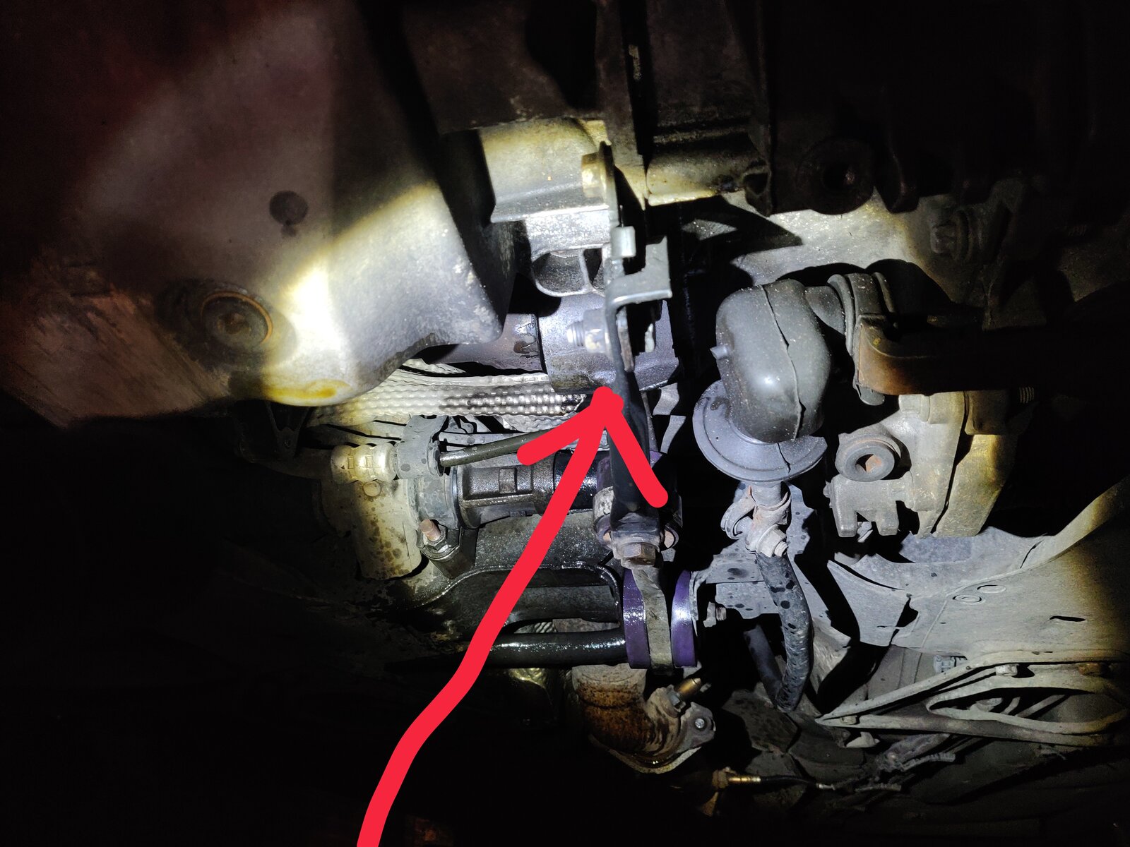

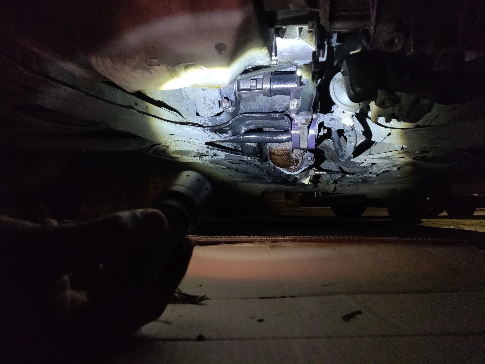

I picked up a 182 today, everything looked great no leaks and a comprehensive history. I had a really enjoyable drive home, a little over 100 miles.
When I pulled up on the driveway, I could smell fresh oil. I looked under the car and oil was dripping at a high rate and there was a pool of oil. I can't see anything from the engine bay, but the underneath was caked in oil. I've taken some photos to try and show where the oil is dripping from. Does anyone have any ideas where is could be leaking from? Are there and common places to check first?

Hi. Does the oil absolutely stink? It looks like gearbox oil from the colour. Possibly leaking from the driveshaft seal? It should not be pouring out! The gearbox only holds 3.1ltrs of oil so I would not advise driving it until sorted. Low oil kills the boxes.

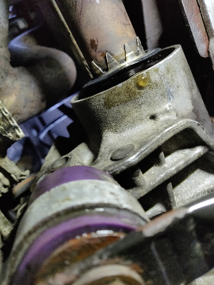

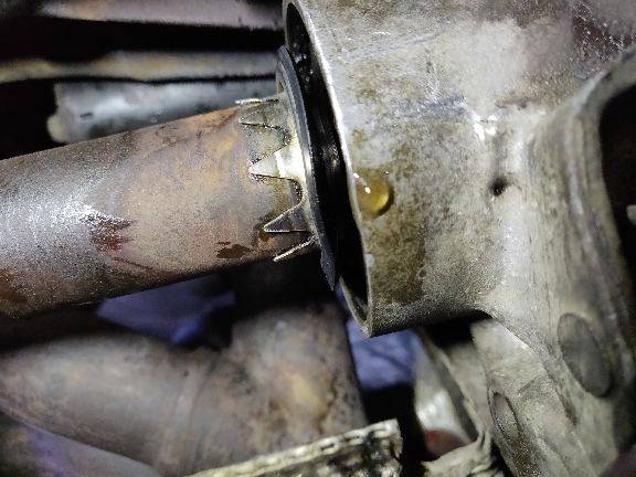

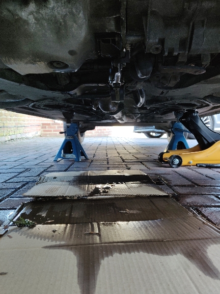

Came out this morning and had a look at the extent of the leak overnight, looks like a fair bit of oil has come out. Checked the fluid levels in the engine bay and all were ok.
Got it up on axle stands and had a clean up, it looks like the leak is coming from the driveshaft seal.

Man that's sucks, it's going to be gearbox out more than likely, on the way home did it crunch into any gears 2nd n 3rd are the usual ones.
Maybe @NorthloopCup can shine some light on the extent of work required to change the seal?
Looking at your pictures it appears that way but have you looked topside of the gearbox to make sure it's not something leaking above and dropping off the box
Remove the driveshaft, drain the gear oil and remove the output shaft seal. Put the new seal on and carefully tap it into place. Refit shaft, refill with oil and road test. Check for leaks - all ok? Jobs a good un. If it leaks again then you’ve potentially got something creating an issue.
