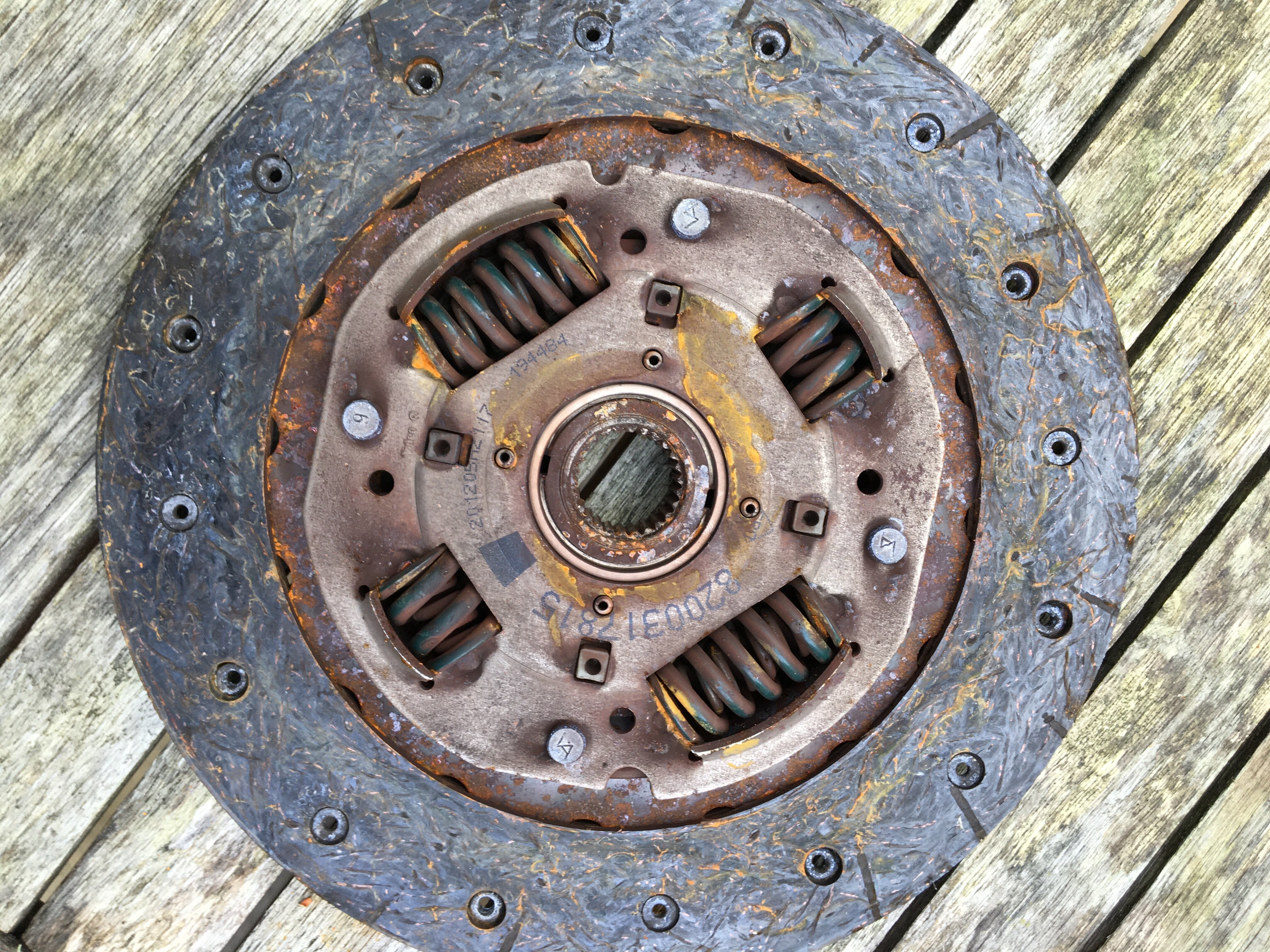

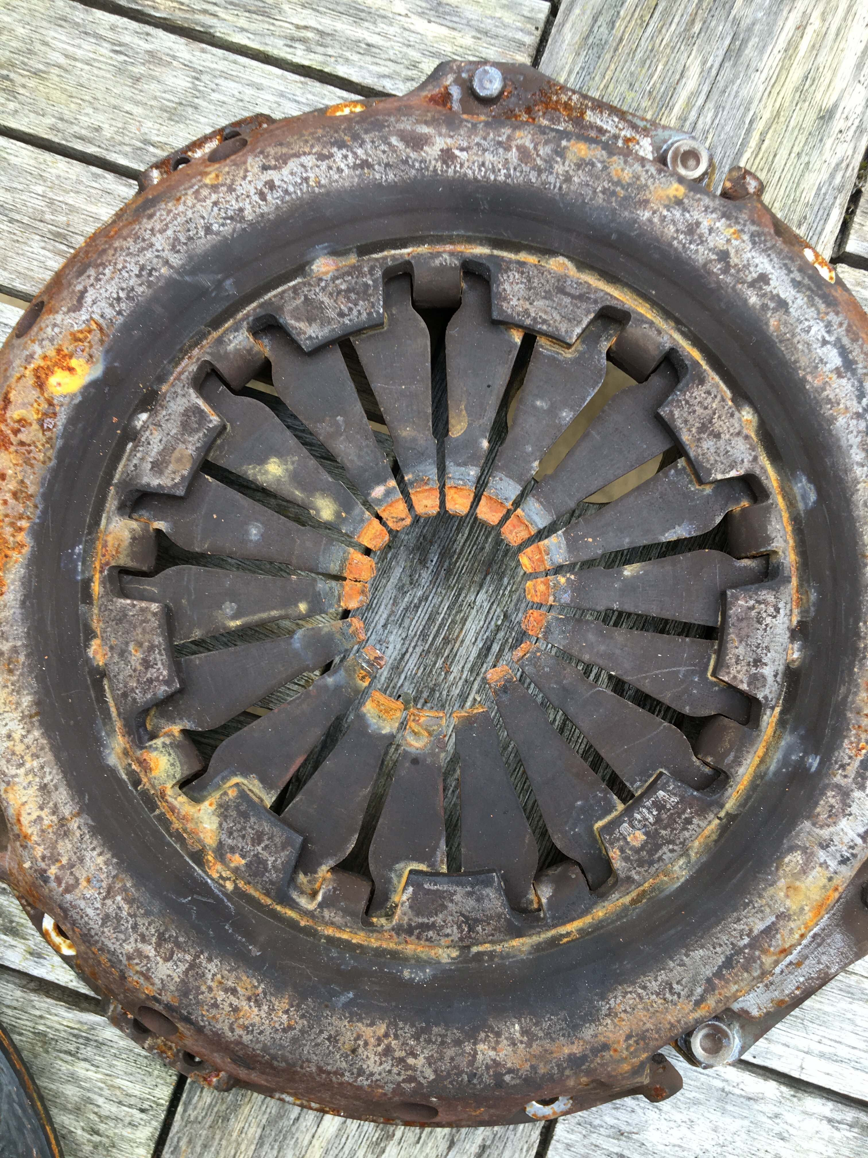

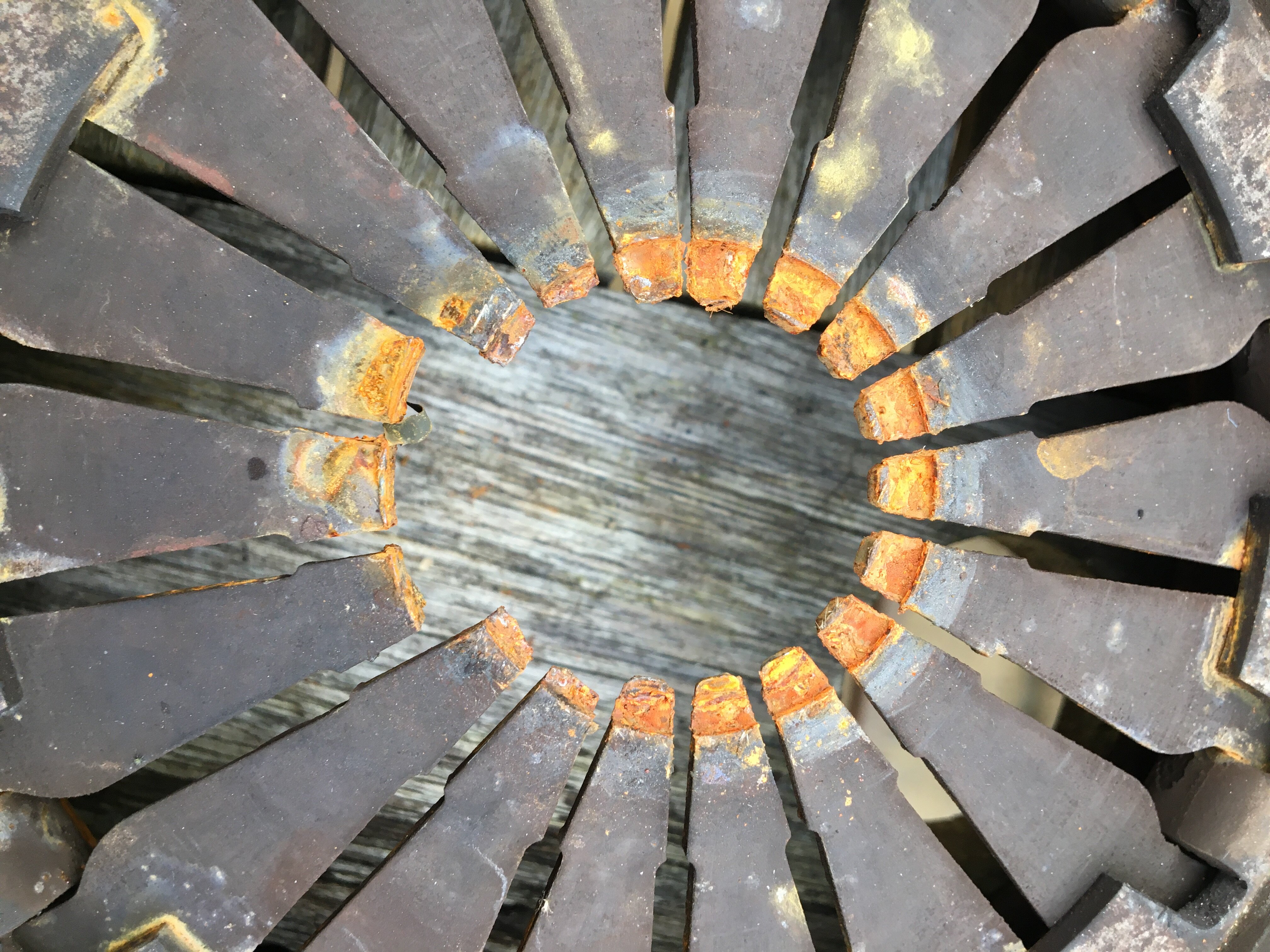

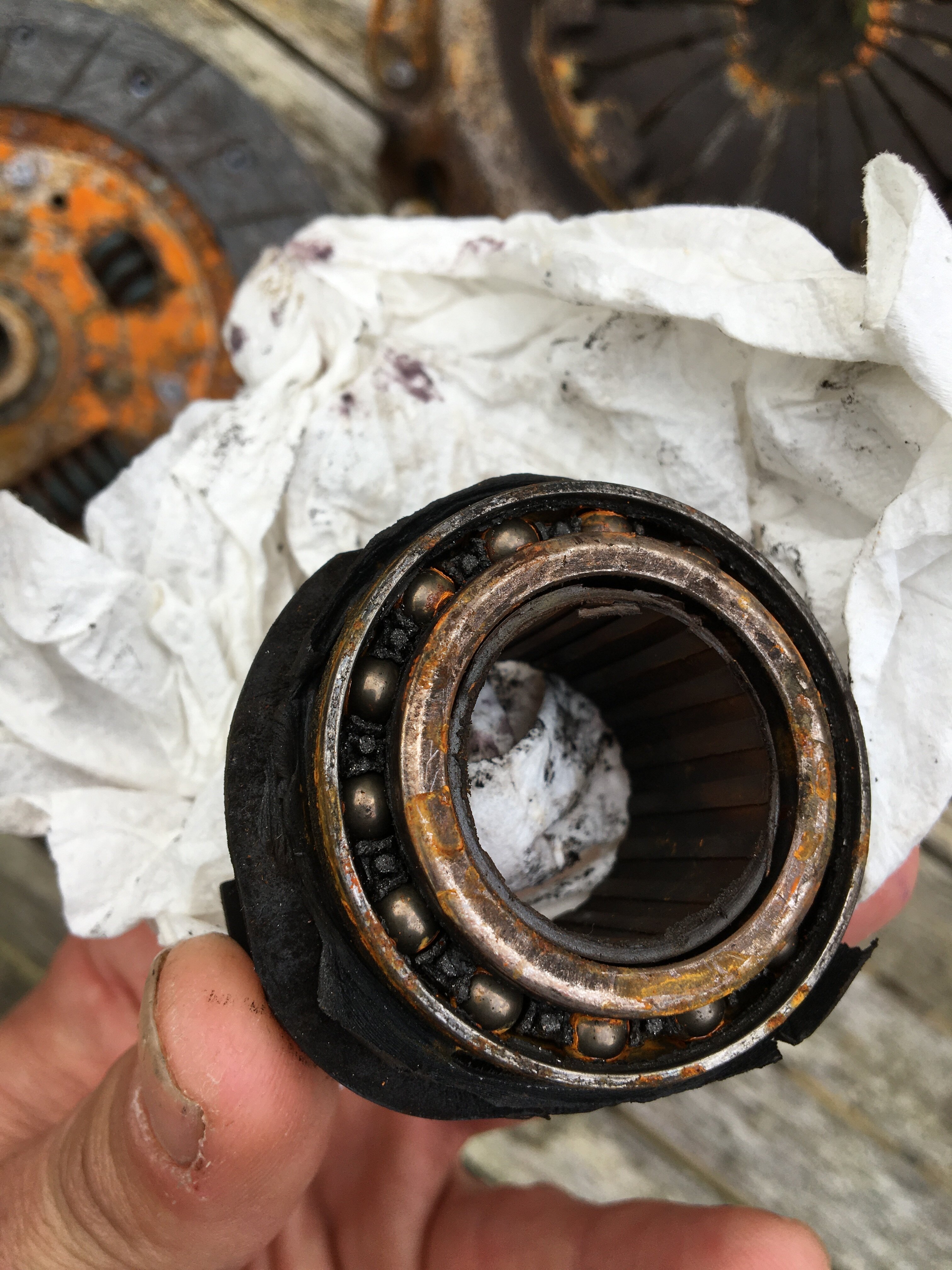

Not for the Clio but the internet suggests it could be an input shaft bearing, could that be the problem? If that was the problem would it not show symptoms in other ways? I already said it drives smooth and nice, nothing to suggest there is a problem anywhere?? When I took it in I couldn’t select reverse gear but got to the garage ok. I have included pictures of my old clutch, the rust is just where it has been outside for the last few weeks. C372F618-D2EB-4A05-B435-2171D31D0EE7.jpegD504BD90-B49A-4422-A2E8-11B936BD0A04.jpegA4101E93-30CA-4BEA-9EFD-409DD0CD9D65.jpeg0C731A27-5EA3-45BC-B510-70DD6BE00083.jpeg
Would the damage on this clutch have caused damage in the gearbox, even though it drives fine nice and smooth etc??

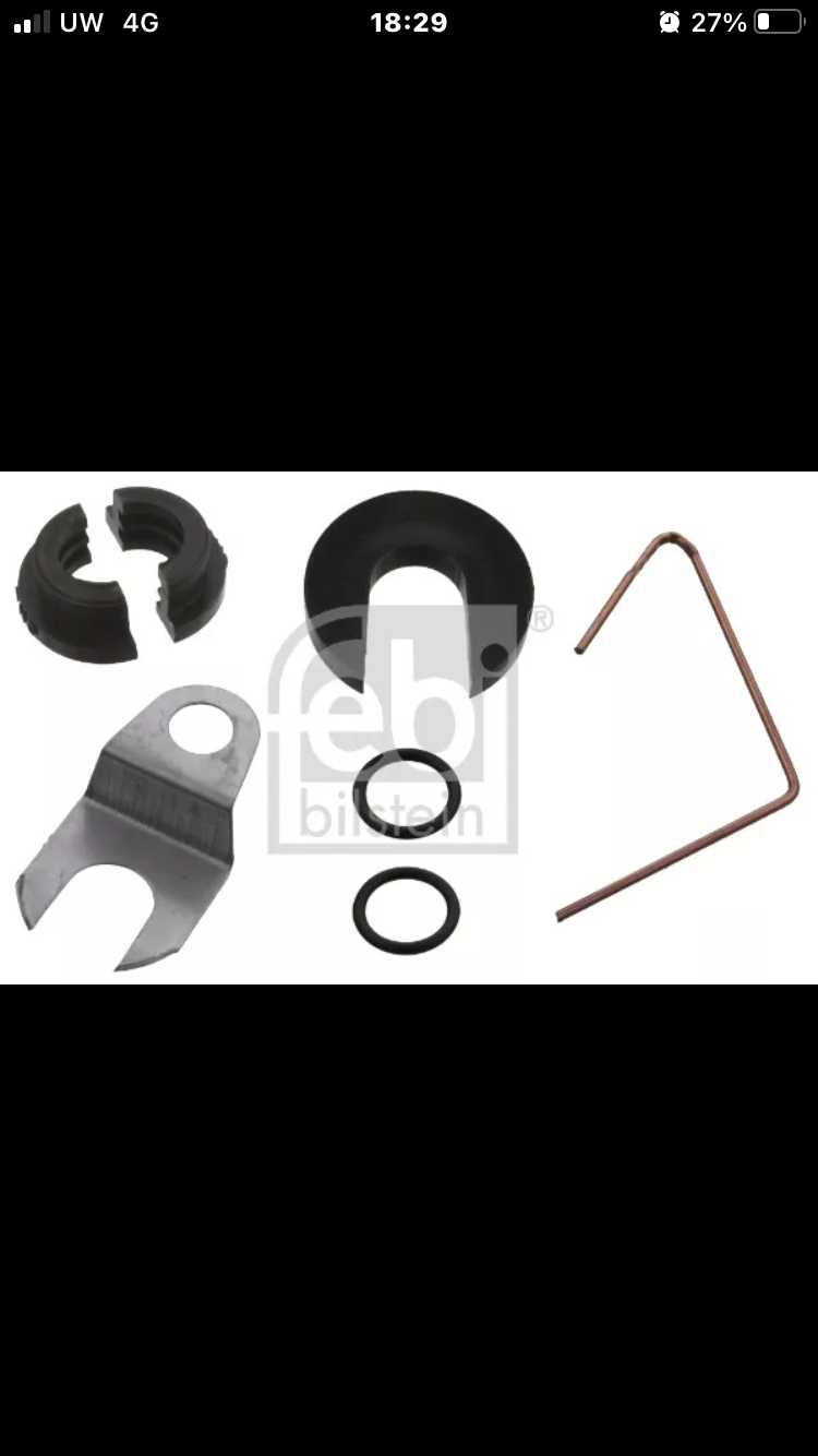

Hi hoping someone explain what this part circled in red is and where about it fits in with the clutch kit
I’m wondering if this part is missing or incorrectly fitted, would it cause the clatter noise?

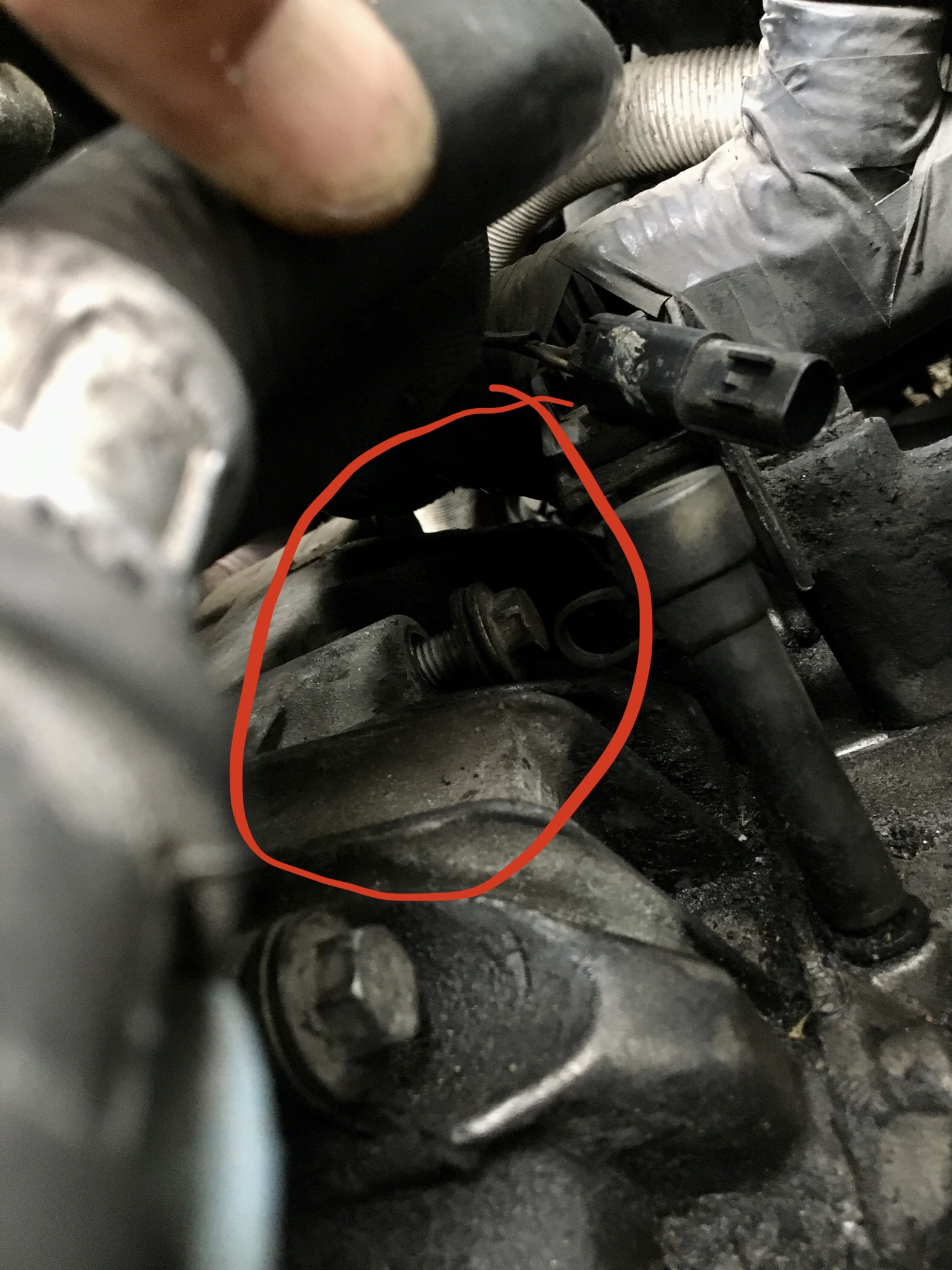

Apologies for a late reply and thank you. Since my post I have driven many miles and not had a problem. The noise is intermittent, sometimes loud sometimes not at all. I took it back to the garage and they reckon it is gearbox related, however driving the car suggests there is nothing with the box at all. This past week I have had starter motor issues. I was looking at the crank shaft sensor and noticed the top gearbox casing bolt was completely loose, rattling around. Only today have I managed to tighten that bolt up, and the noise wasn’t there after, but like I said is intermittent. Thanks again
I’ve done a new video today I would say that there is still chatter noise but definitely doesn’t sound unpleasant/alarming. I’m not sure if the noise is normal mechanical noise now, when pressing to clutch in and out. You can’t hear it inside the car only with the bonnet up. Tightening the bolt up seems to have reduced the noise considerably so I’m hoping it was that, maybe there is another loose bolt?
