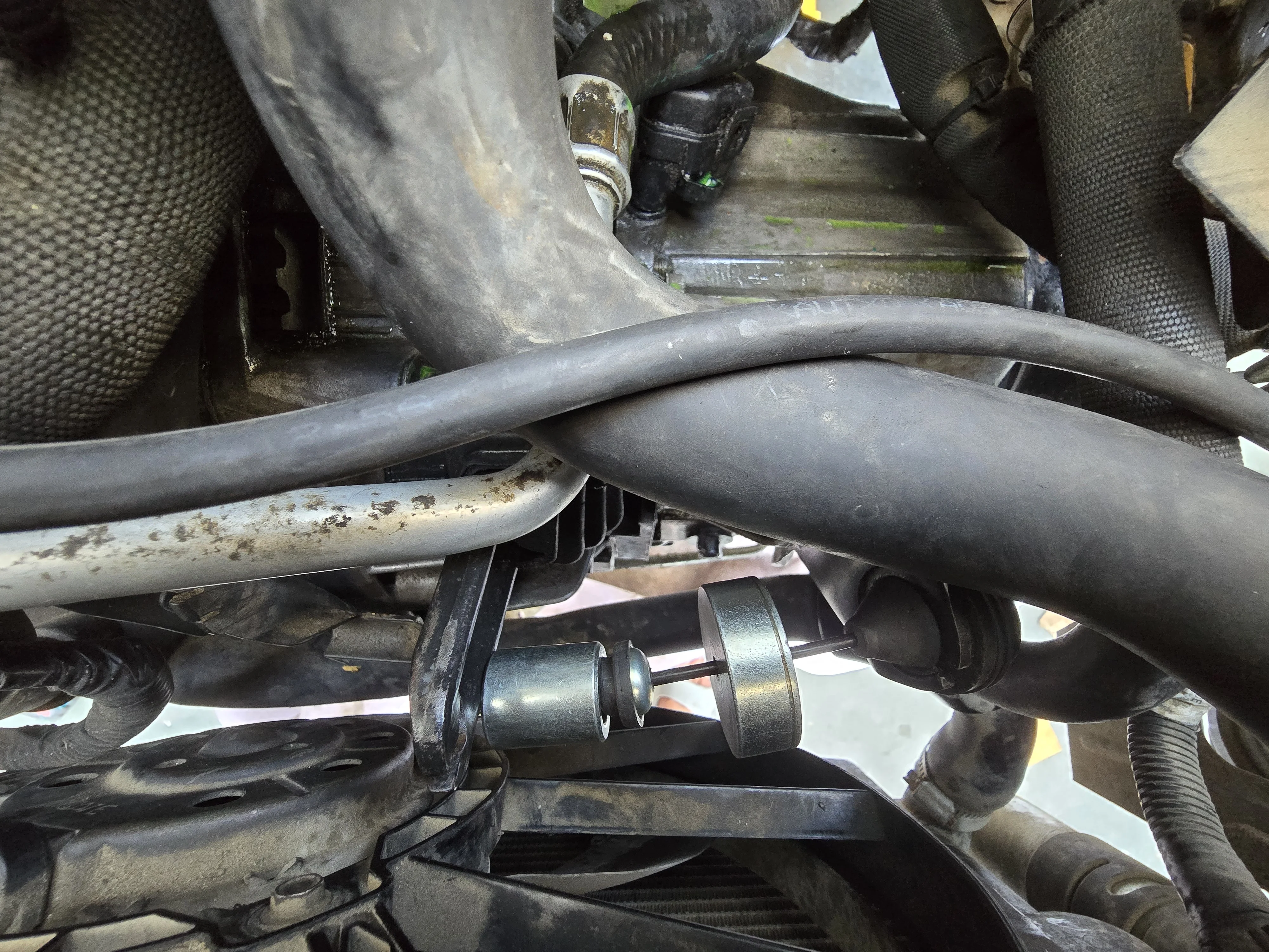

Can't fit the new clutch cable after flywheel, clutch kit + release bearing replacement.
No matter what I try the cable seems to be too short:

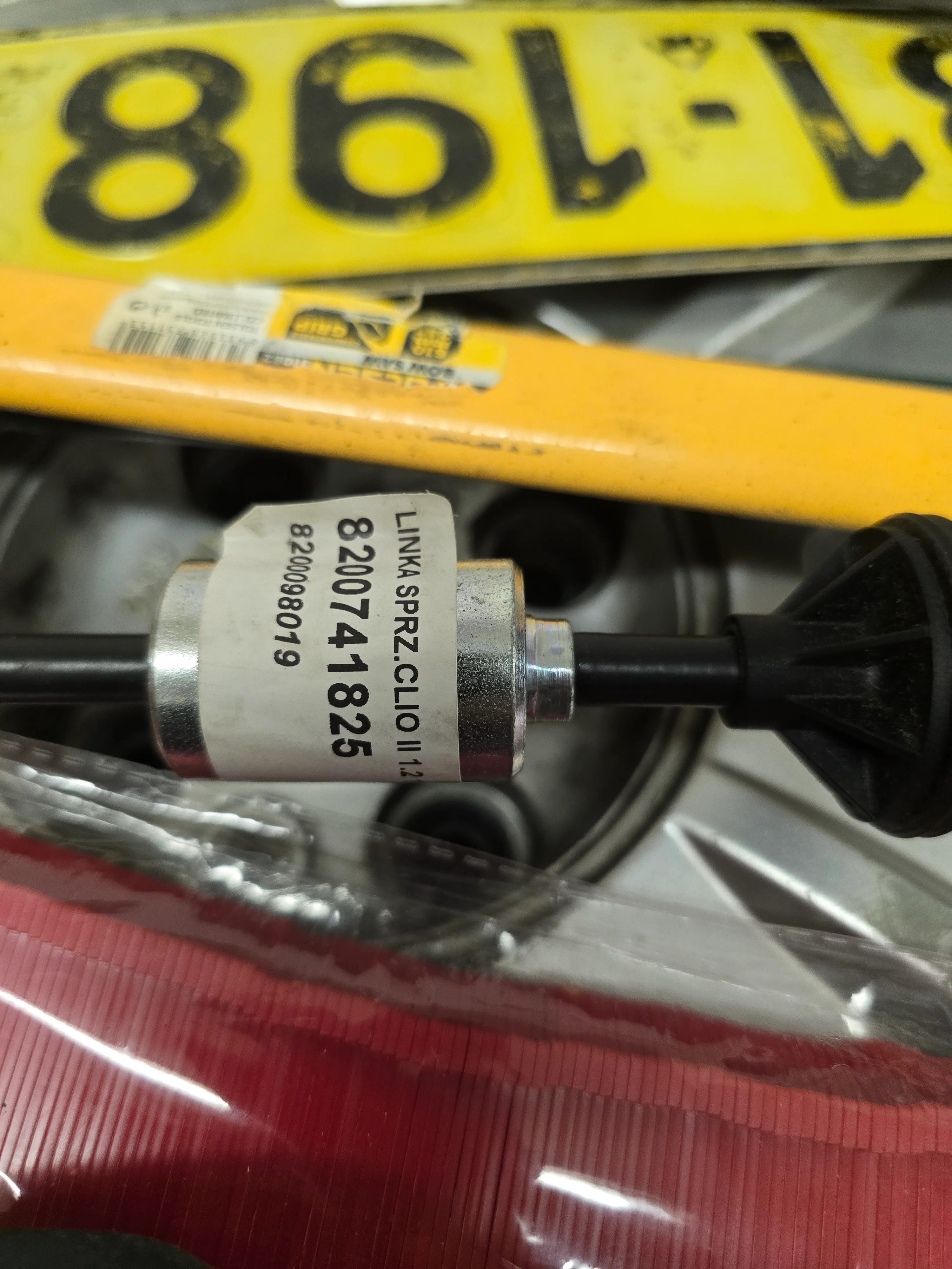

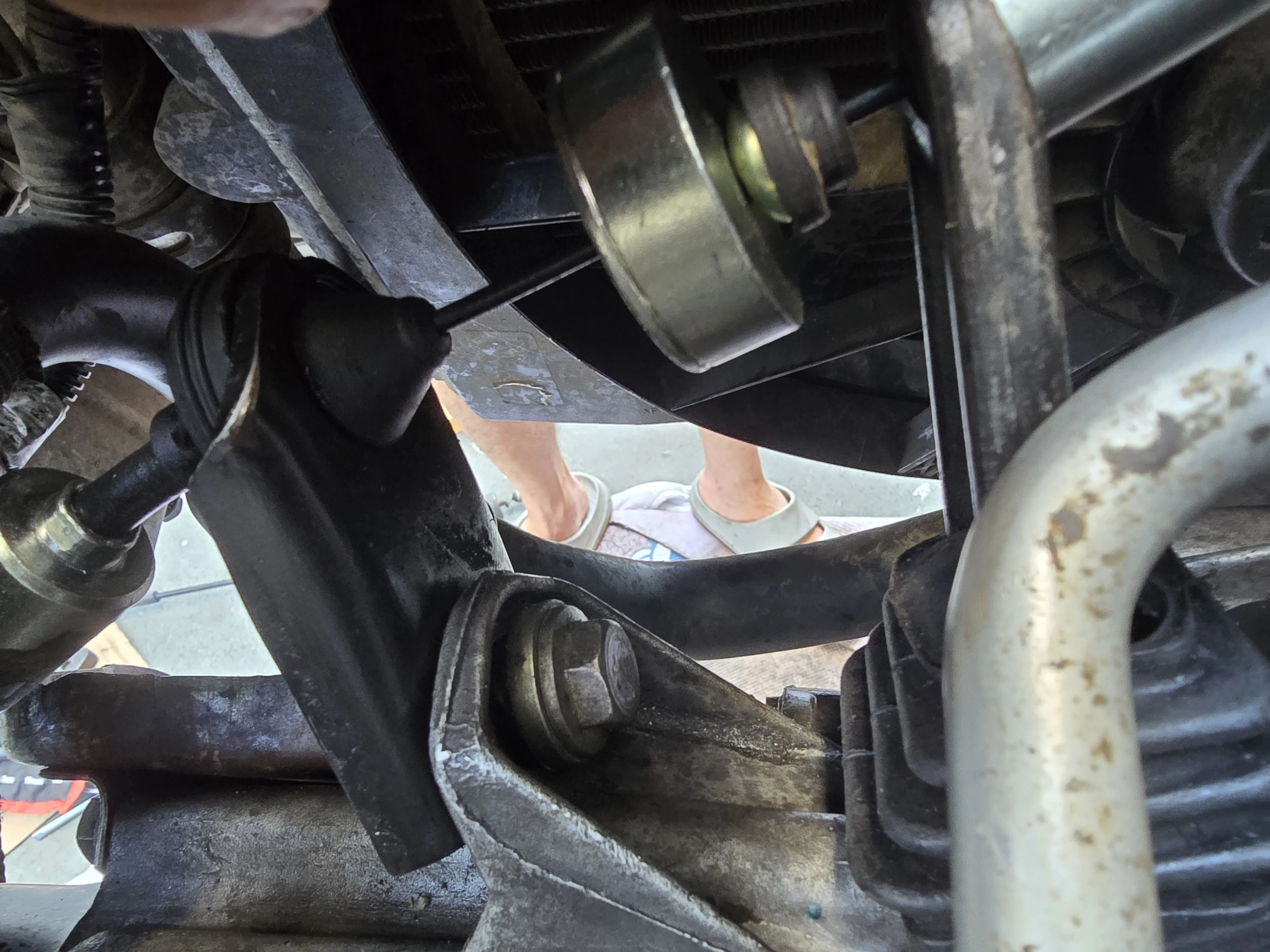

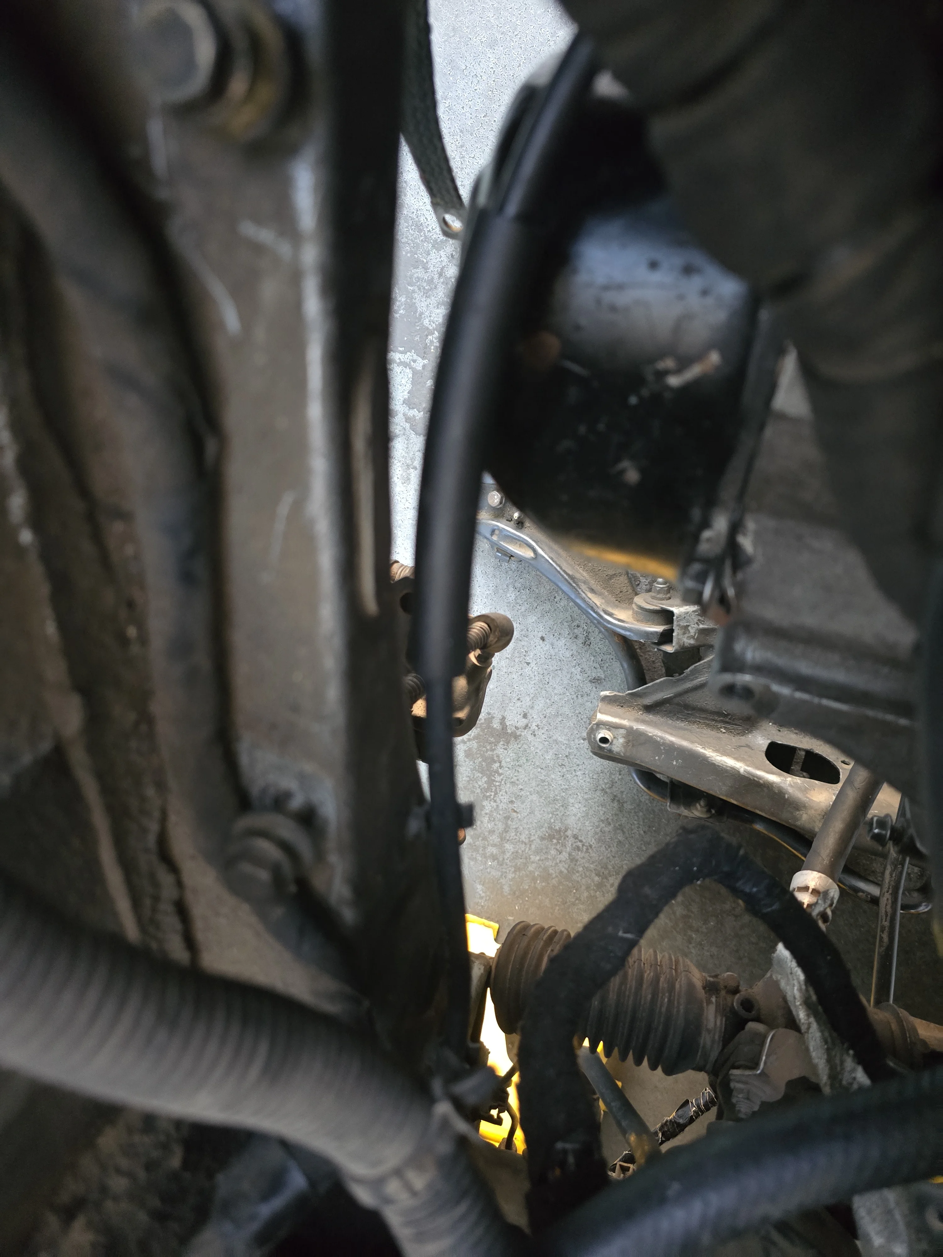

1. Can't be seated properly on the fork gearbox side - not enough slack on the cable to put the rubber grommet and the metal cone at the far side. [See pics]

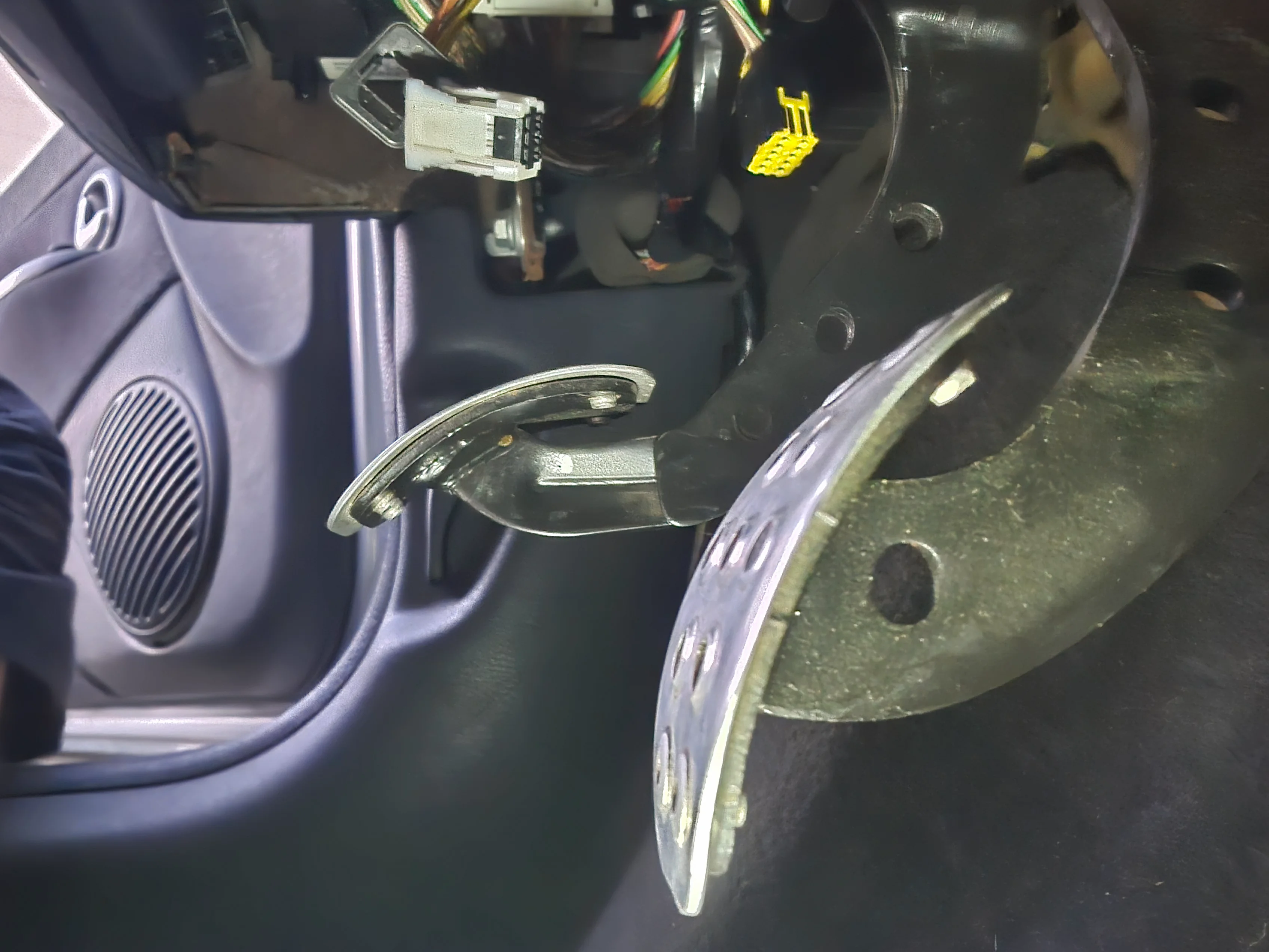

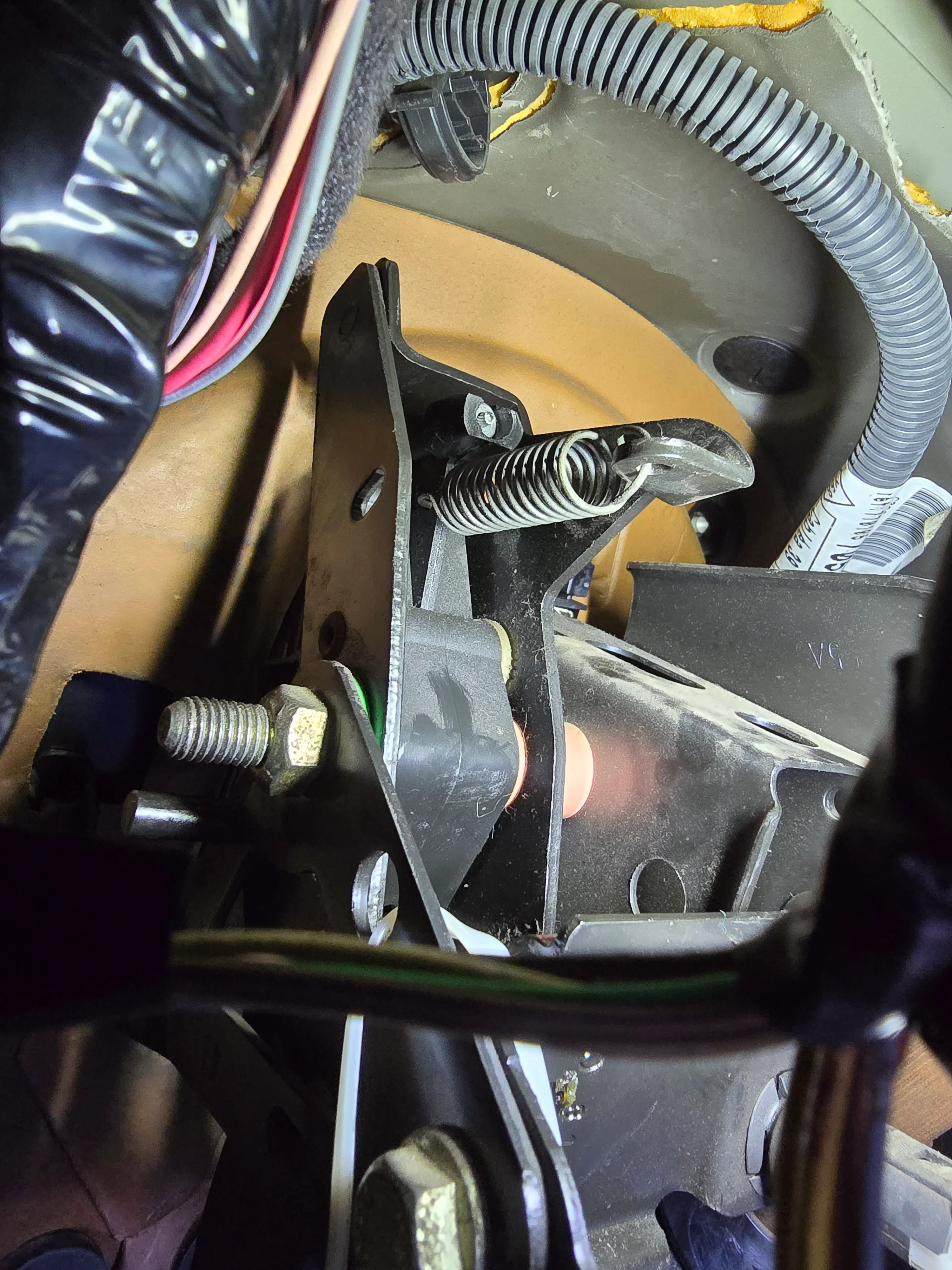

2. Even without the rubber grommet (cone only) at gearbox side , when the cabin side cable connected to the pedal - the clutch pedal remains super high, well above the brake and gas pedals .I think the clutch would not work properly. [See pics]

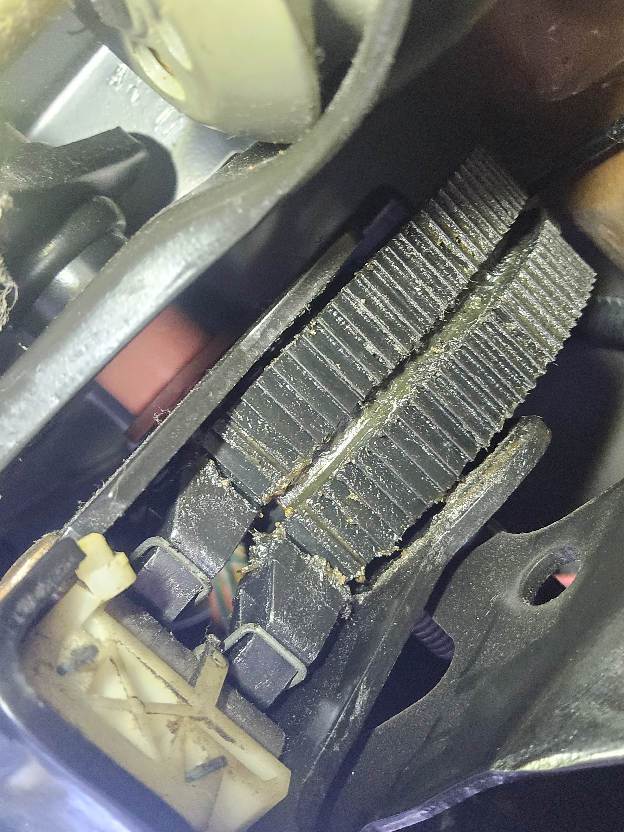

1. Reset the pedal clutch cable adjustment ratchet - even in position zero (maximum slack on the cable) cable length is not enough to seat the gearbox side properly ( cone + grommet at the far side of the fork)
As soon as the ratchet is released, the pedal just clicks all the way up to its high position [see pics].

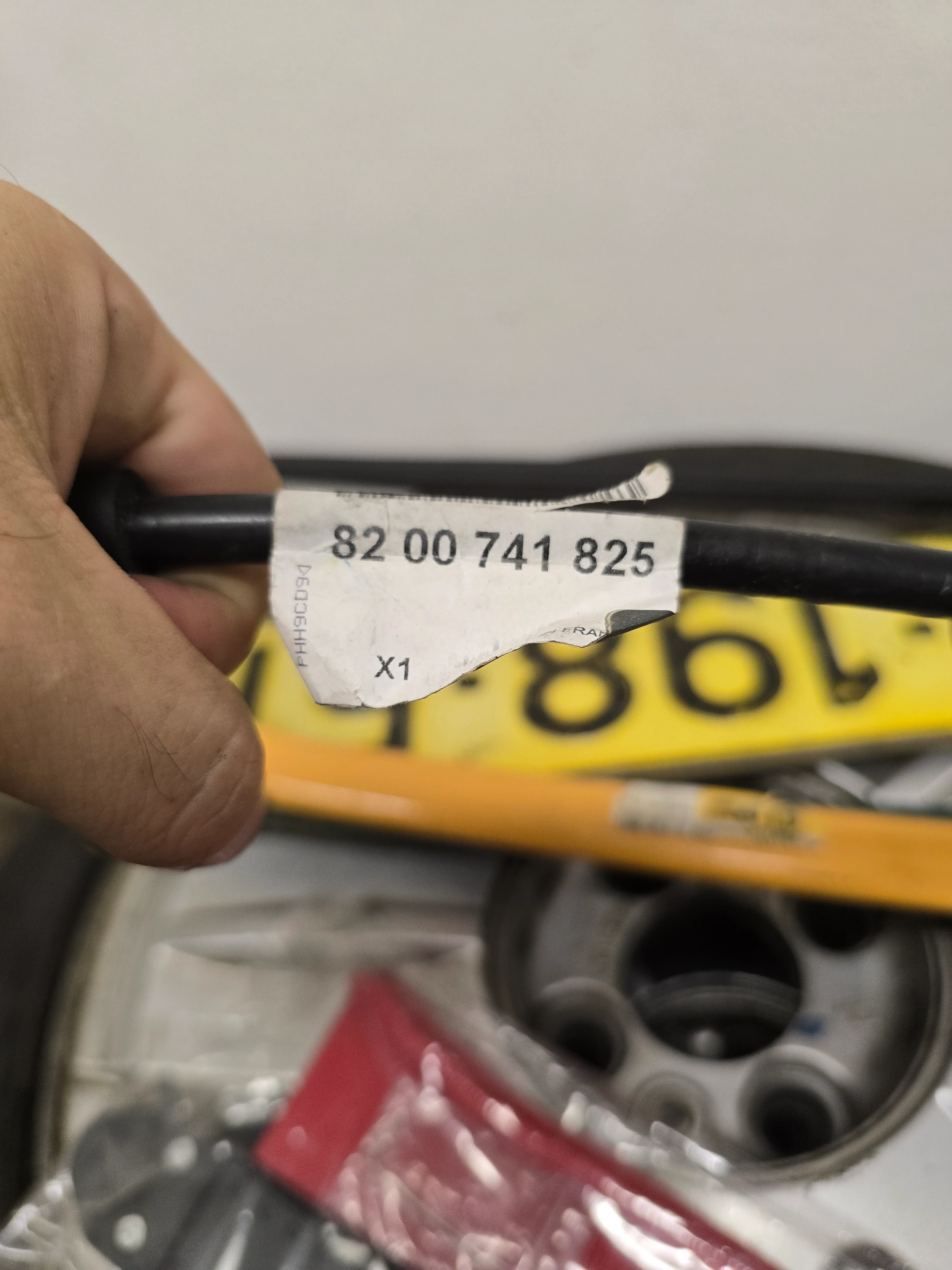

1. Wrong Clutch cable ( mine is the correct RPD, left hand drive SKU)

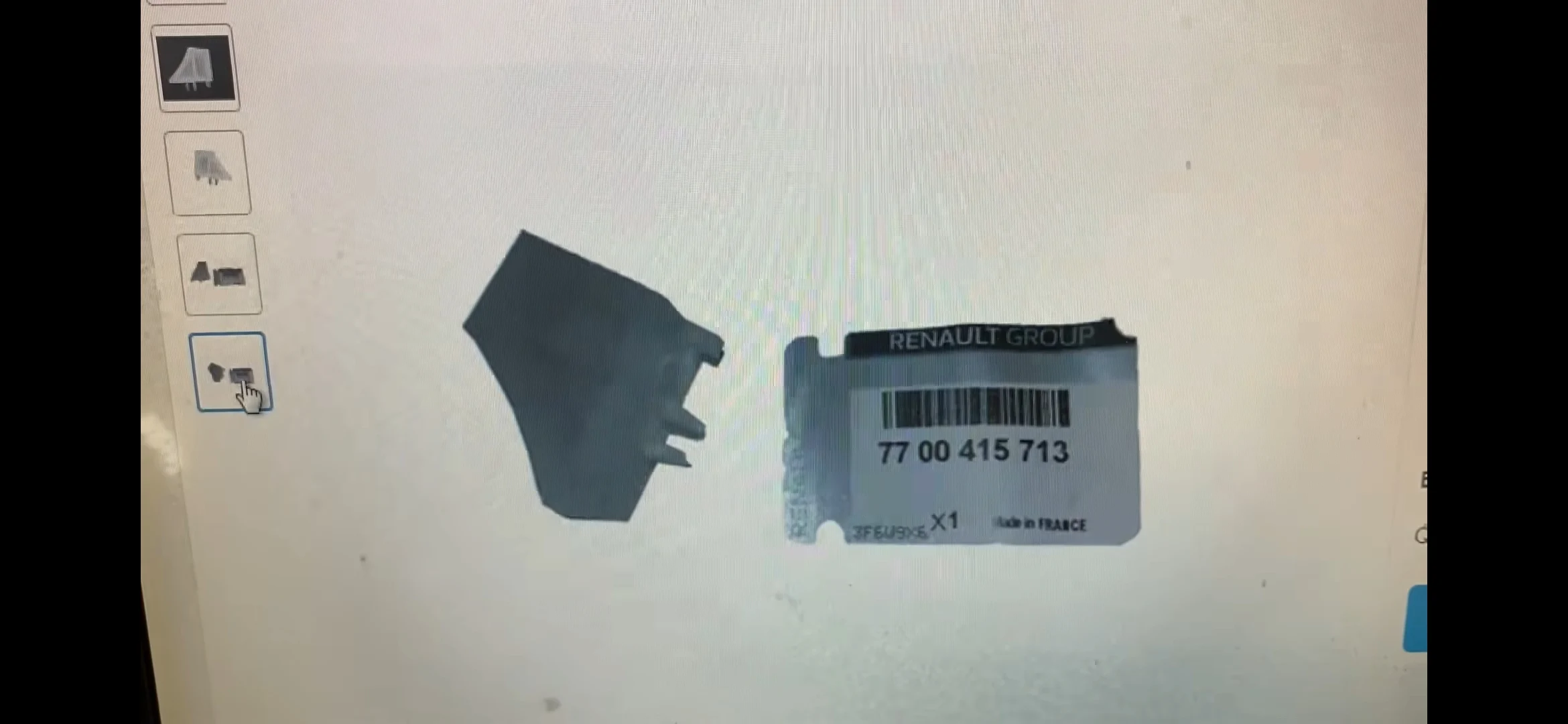

Watched a few YT videos, I think I am missing that plastic bit that supposedly limits the pedal height and should fix that issue for me
However,
The cable is still too short too reach all the way on to the fork..
Or should this part somehow solve that too?

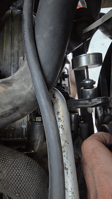

Better picture of the fork side cable situation - I can't get that bottom rubber grommet and steel cap on the far side of the fork together with a cone:
Does it mean the cable is too short? Or I am not doing it right? Or the fork is misplaced inside the bellhousing? 🤯
8200741825 is correct.

The cable is not pinched, it moves freely, just appears to be a centimeter short..

Tried from both ends( disconnect and pull on) even with cabin ratchet on Max slack ( all the way down towards the floor) - a centimeter too short..
Can put only the metal end cone on the far fork side, not enough length to put in the rubber grommet

Compared the cables, look pretty similar. The old one has all the rubber bits squashed/compressed so I guess that freed up that miaaing centimeter of cable length and allowed it allowed it to go on on the fork.
The only solution i can think of is trim that rubber bush on the new cable to allow this to somehow slide on the fork.
But that would pull the fork to the extreme tight position.
Would this allow the clutch to operate normally?

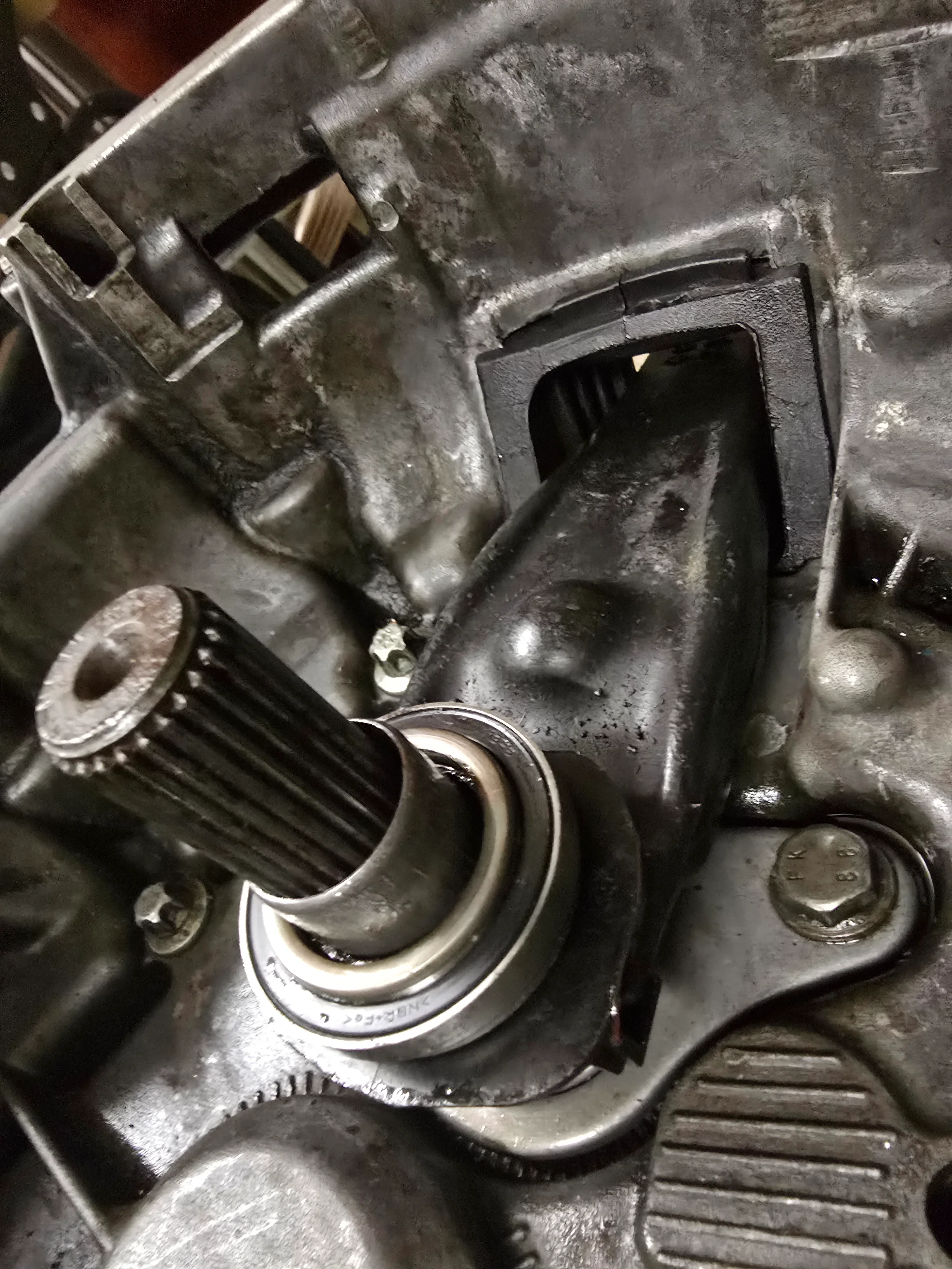

Can it be the fork/release bearing within the bellhousing that I messed up when putting the box back?
See GIF -Ill re-upload, is that range of fork travel normal, anything seems off?

Fork Movement video:
Does this look right ? Range of motion, etc?

Looking at the fork movement vid above, anything odd popped to your eye?

What if I just don't hook the rubber grommet on the far side of the fork? Is that a major issue?

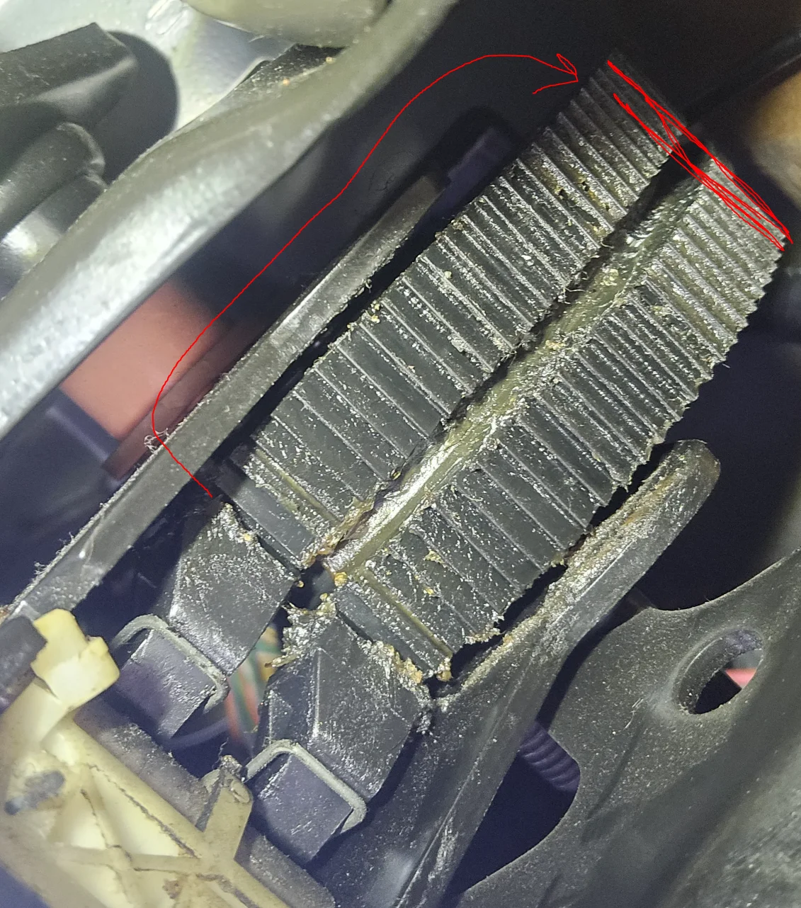

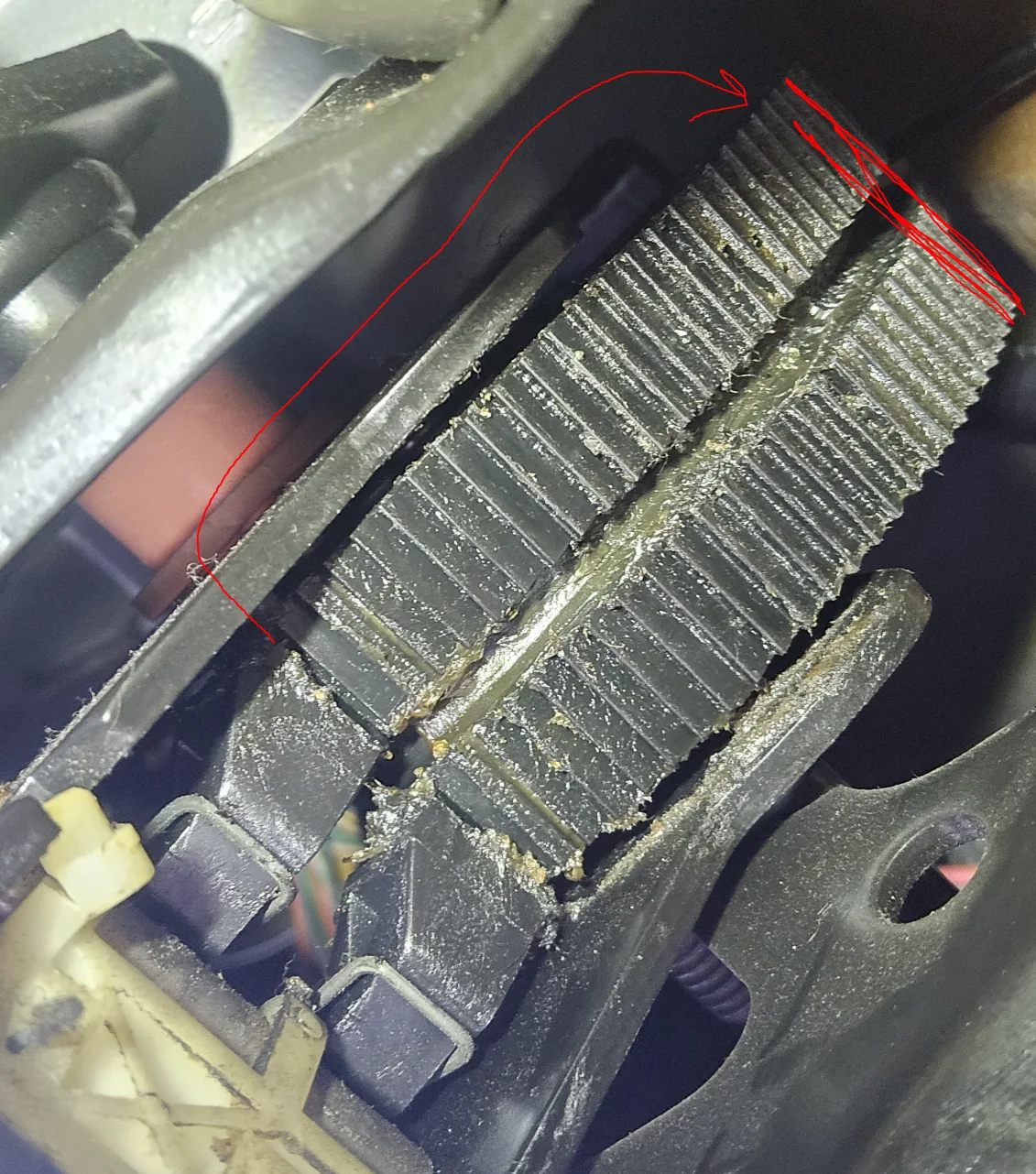

Based on the direction of the teeth, the ratchet mechanism looks like its a full extension? And the locking tabs should be where the red line is?
As @Brigsy says it's self adjusting, so if you can get the cable on it should adjust itself to match (assuming the clutch has been installed correctly)
Correct, but even in that position (all the way back -max slack) there is not enough length on the cable to hook it on to the pedal (when it is attached as it should to the gearbox side fork)
So how critical for clutch operation is that rubber grommet to be on the far side of the fork? I'm ready to give up on it, if it's not a biggie.
