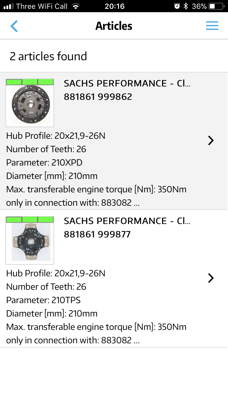

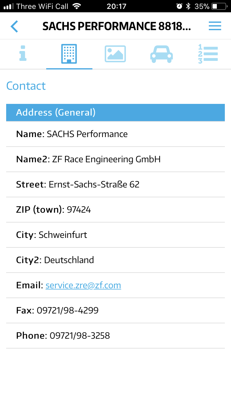

You could try contacting ZF about their 4 paddle clutch, see what thickness that is?
Daz...
  Inferno 182 Cup
If you have any trouble finding out what it is I can ask at work on Monday, we deal with LUK, ZF, Valeo etc.
