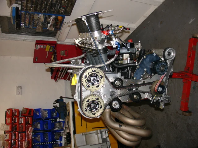

Thought this might be of interest.
It's not going in a Clio but it's an F4R.
I've just got the engine back from the Dyno and here are the figures.
Xtec Engineering
Tel. 01922 454 858
DYNO TEST
ENG No FR engine on TB
Test No NS FR TB-1 Test Date 18/11/2010
Engine FR2000 Customer Nick Skidmore
E.M.S. MM Disp 2.0 Litre
ECU No DTA Fuel Type V Power + 20% 114
Map No. FR2010 Oil Type Millers RIO
RPM Limiter 8000 rpm Plugs Spec
Pot set Idle Min / Max
Break In time 1.0 (Hrs)
Run Time 2.9 (Hrs)Idle Speed 1400 (Rpm)
Oil Deg. C 101.0 (Deg C max)Trumpets
Water Deg c 82.3 (Deg Cmax)
Loom No DYNO
Coil No N/A
RPM BHP Torque
4000 122.3 160.5
4500 138.1 161.2
5000 155.8 163.6
5500 186.7 178.0
6000 198.3 173.6
6500 214.1 172.9
7000 228.4 171.3
7500 218.9 151.3
  TatuusFR2000
Sadev 6 speed sequential transaxle.

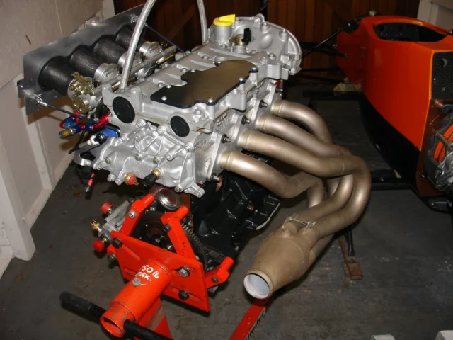

Engine spec is CR12.7:1, Cat rods, Cat Cams 5502552 on solid lifters and Vanos delete, Cat Pulleys, Ported head, Billet rockers, Iapel pistons, dry sump, Orbisoud exhaust, Hayabusa TB's and self made inlet manifold.

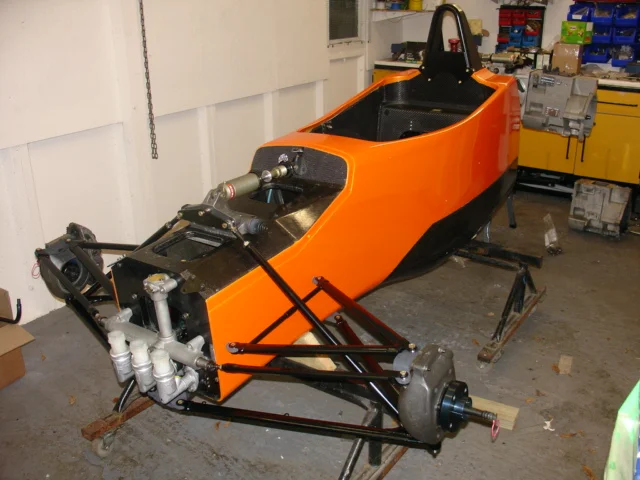

I'd guess its going in some kind of single seater/Locost/hillclimb car - pic looks like a Tatuus FR2000?
Hyabusa bodies as well possibly ...
Edit. Beaten to the spec by the OP. But i clearly reek of geek ;)

lol @ 160bhp - That's a bang tidy looking build and Aero-quip pornography to match!
Need to ask; what's the water pump setup?
Mick
MicKPM
ClioSport Trader
  Clio16v/Zoe Z.E.50
I can see that you Welsh tart... I mean't who makes it & who made the adaptor plate cos me likey?
  TatuusFR2000

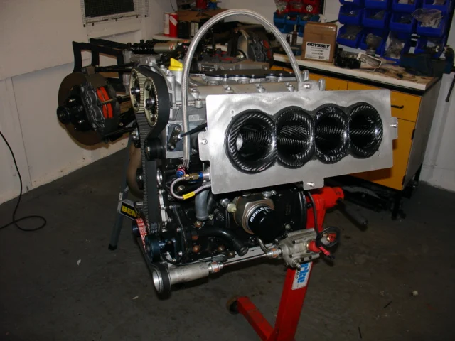

The water pump is a Davies Craig elastictrikery one.
The blank plate and oil pump belt tensioner were handstitched by me (as was the inlet manifold).
The TB's were a lot of work as gas flowing them and fitting the bell mouths is time consuming, if I did it again I would use Jenvey bodies on my own manifold.
Engine was pricey as it was Pro-built but not as expensive as estimated.
  TatuusFR2000
what management does this run? what work had to be done for the busa bodies?
DTA S40 PRO the TB's needed a custom manifold, respacing, machining so the bellmouths would fit (have to remove butterflies - PITA), highflow fuel rail and gas flowing to remove sharp steps.
  TatuusFR2000
The Black plate on top of the engine, where is the hole for the pressure to escape from the cam cover?
The engine is dry sumped, there is a breather from the bottom of the block to the oil tank and then 2 breathers from the oil tank to the catch pot.
As a general rule with dry sump systems breathing is done via the oil tank so no need for breathers on the engine.
