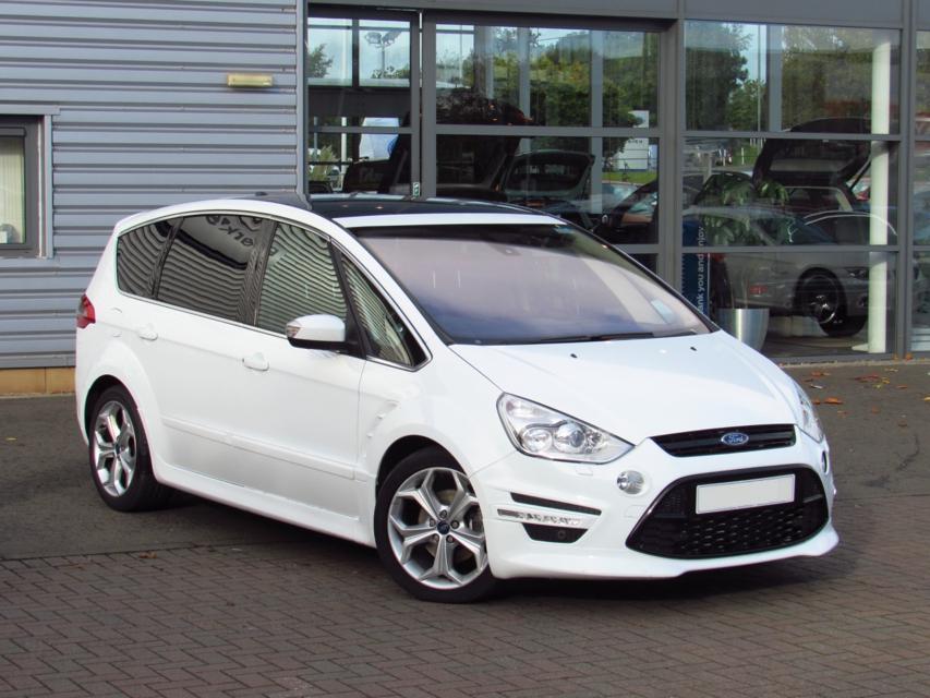

I wish we had that engine in our family bus! Sadly ours is just the 2.2 diesel (200bhp), it is a Titanium X Sport tho so looks kinda ok (pic from google)

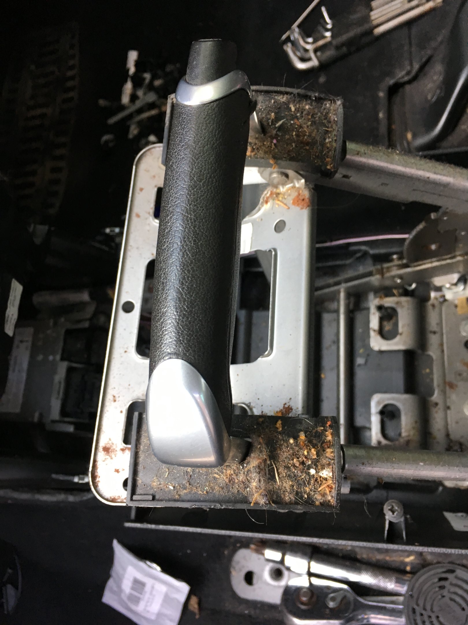

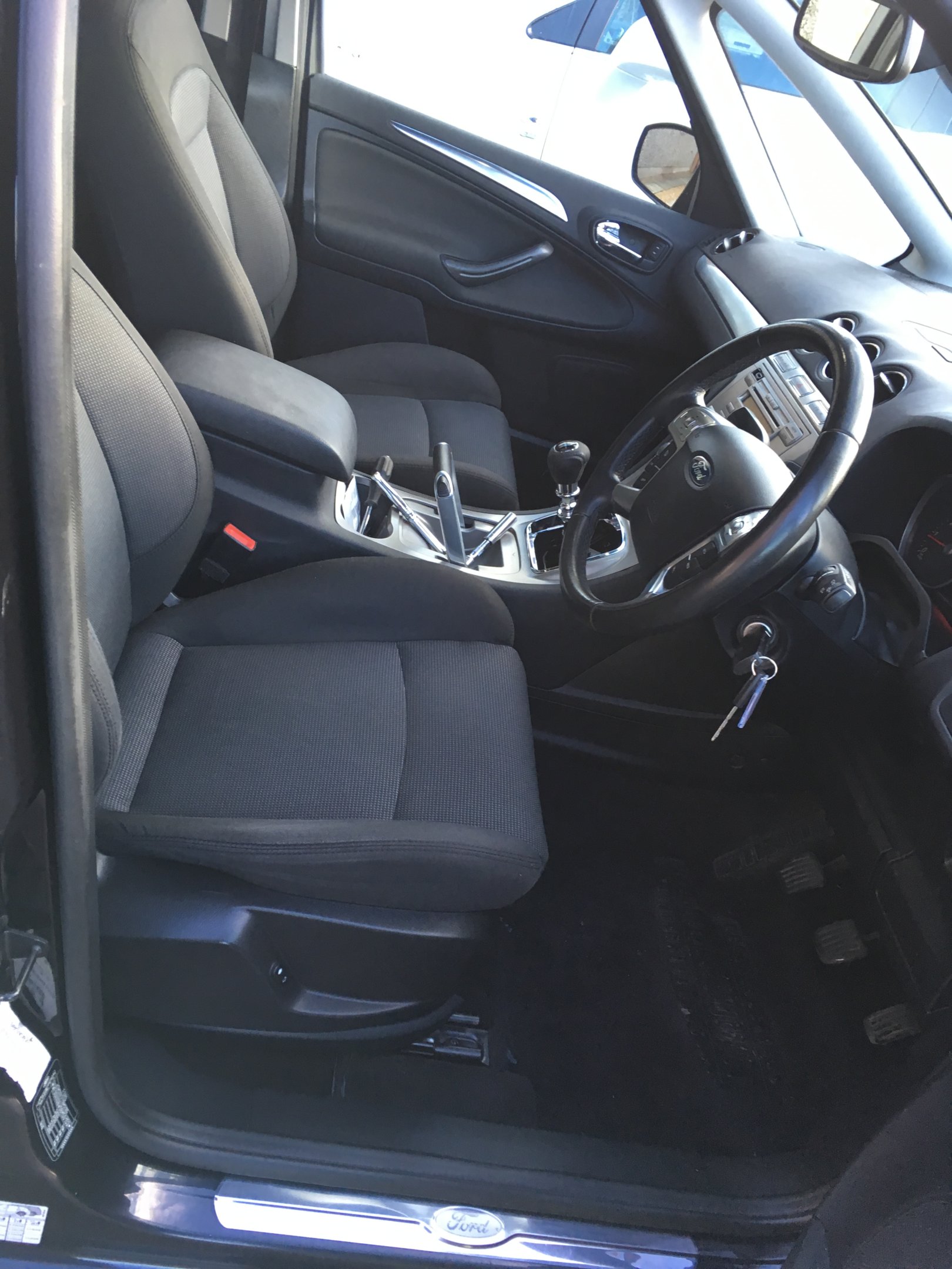

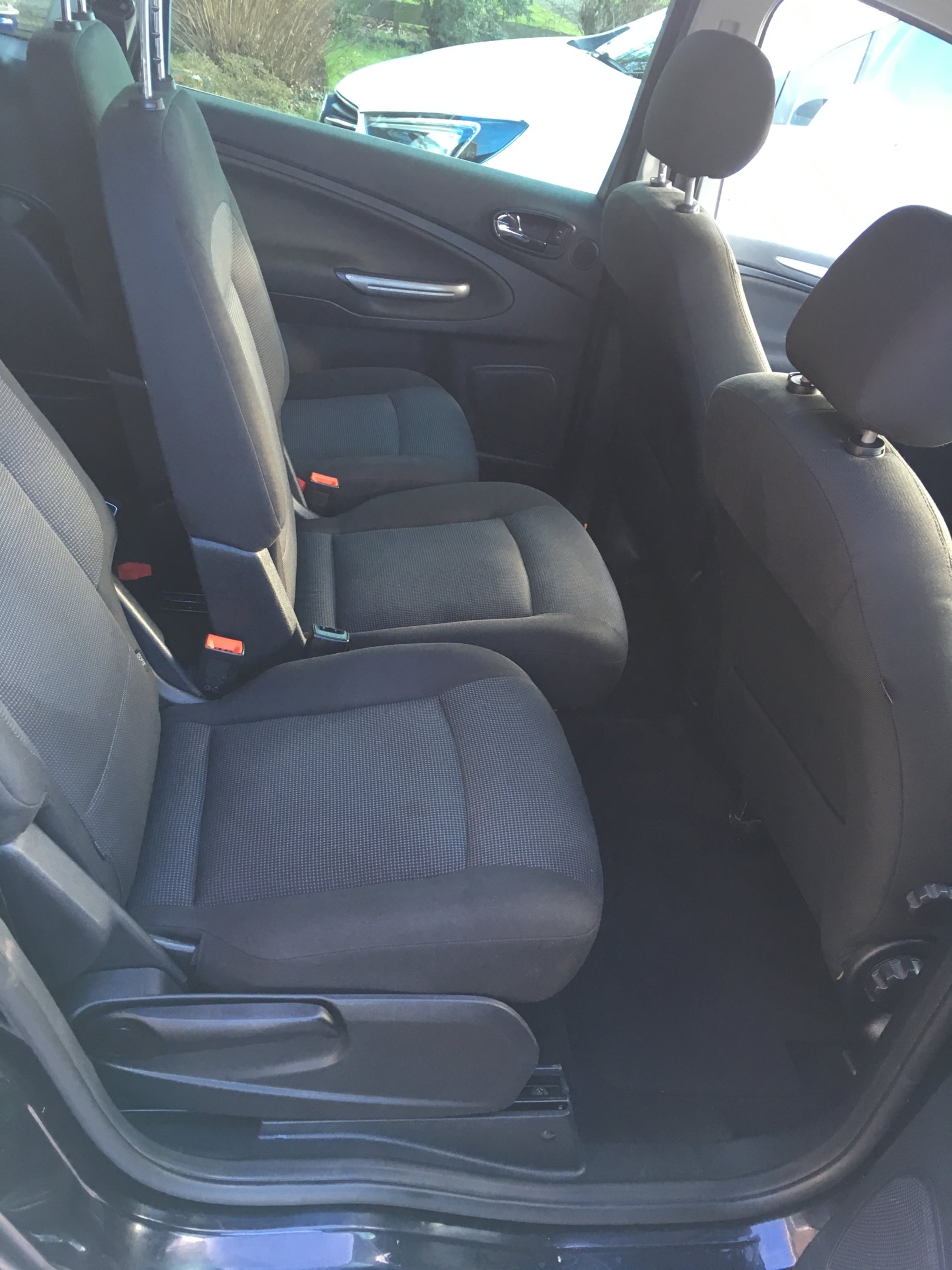

Got it cleaned up the other day but conditions were terrible so not many pics of during.
Went a bit overboard the day before though
Worth it IMO.
And looking better but only smelling a bit better
Seats were still damp in those pics but now they've dried it's much more even.

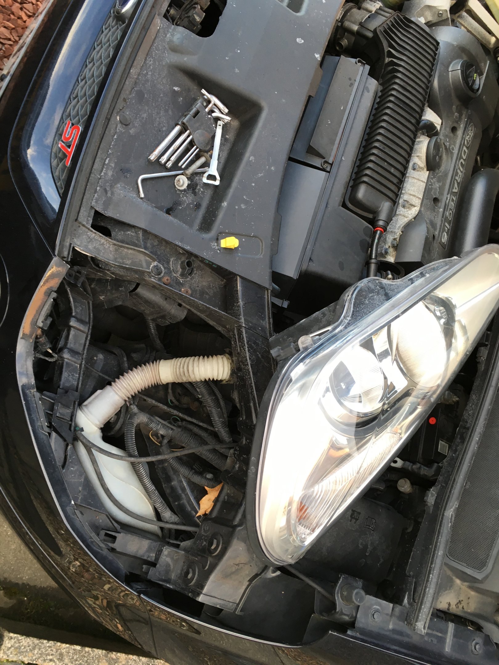

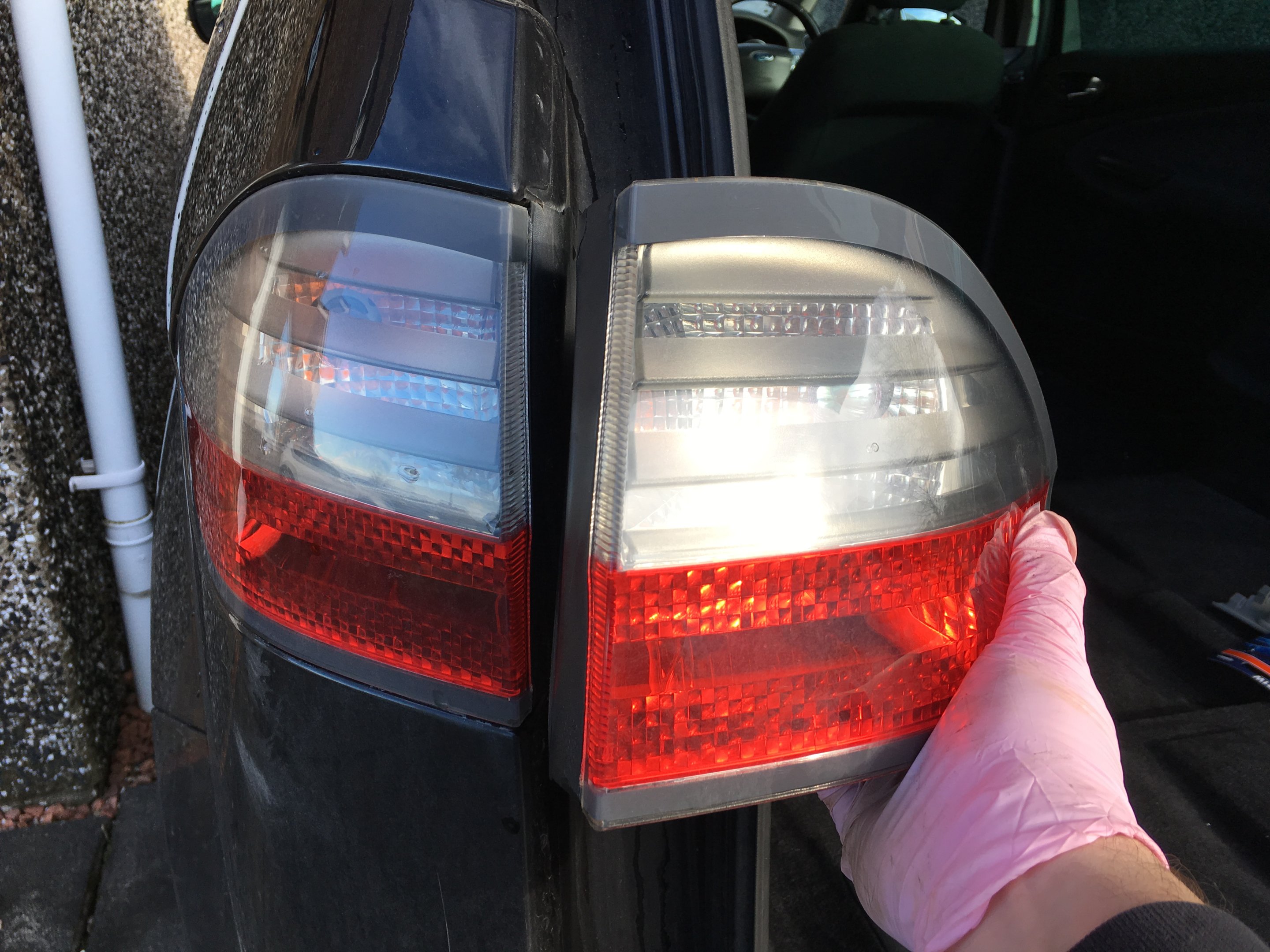

I chucked some uprated bulbs in and Renault could learn a thing or 2 in this aspect

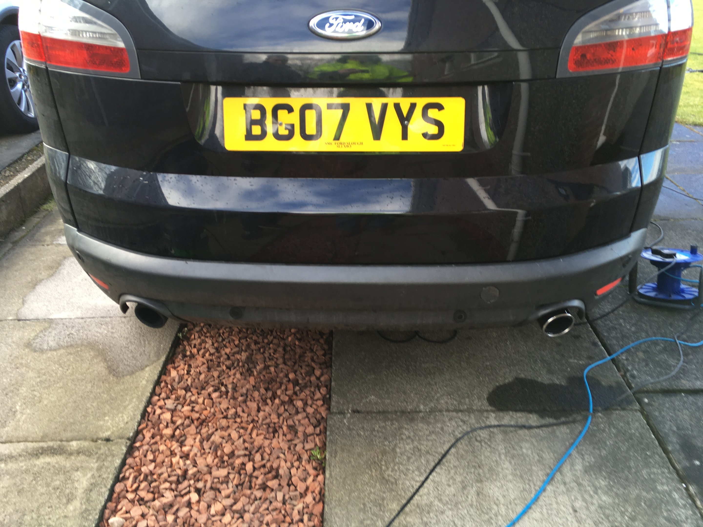

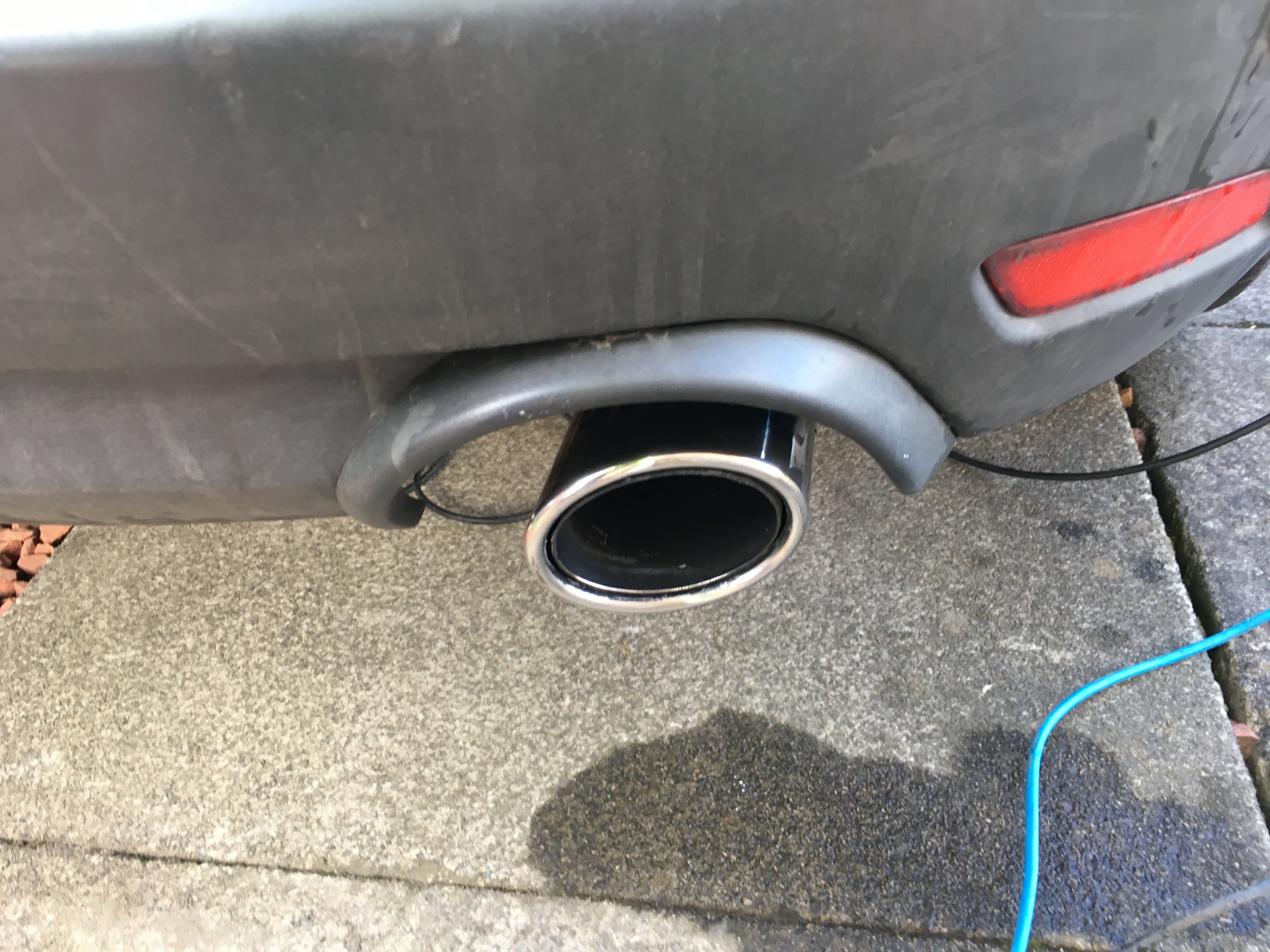

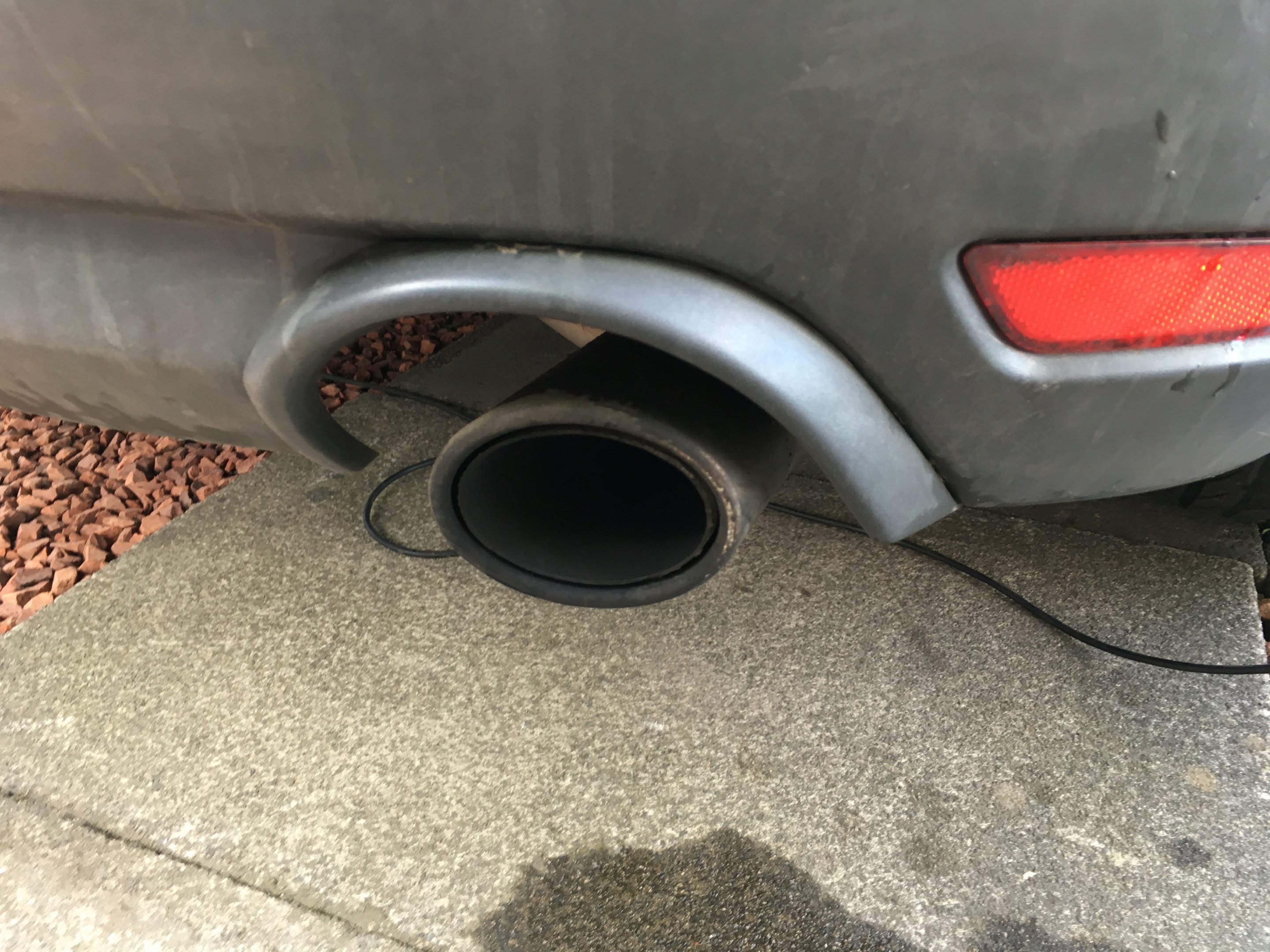

I also gave the exhausts a really quick metal polish

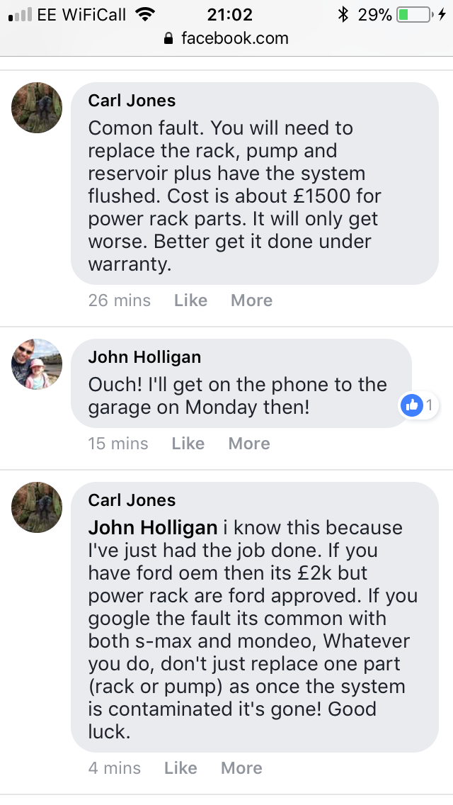

Cons - neither of us find the seats comfy, there's a low speed, part throttle hesitancy, the power steering is making a hell of a noise and is occasionally heavy as f**k.

Our galaxys the same with regards to the heavy steering every now and again, great cars as far as people carriers go, going to run ours into the ground!

You ever looked into why? It's under warranty so atm I'm not arsed but we'll see how it gets sorted out.
  535d / t5 caravelle
Yeah i did about 18 month, cant remember what they said it was, it was an expensive fix though, and i think it was a main dealer job, we decided to leave it and see how it went, never got any worse, so we never bothered sorting out.

We had a 2011 insignia in the other week. Steering would go light then normal, then hard. Bled the system a lot, changed the rack and job done.
Dr HMS Derv Destroyer
  MK1DTi/vivaro/corsa
Was going to say, done a few where I've just replaced the PS tank and done a flush/ fluid replacement. That's assuming it's a belt driven pump, not the EPAS fluid pump.
Also worth checking which fluid it takes , ford for some daft reason on certain years used green type fluid and other years standard Dextron 2 pass fluid

See if it was my issue that's probably what I would do. But it's not, sonI'd like it done however ford recommend.
  535d / t5 caravelle
My power steering is now getting quite bad, to the point its giving up on us through mid bend, going to get it booked in. Expensive me thinks!

Well mines survived the last 1000 miles with a new pump. Ford wanted over £1000, think it cost the garage I bought it from £300 odd and some labour. Which the 'mechanic' was f**king useless at so I've had do some more to it.
Wish the circumstances had been different and I could've got it down to the garage within the month to just get a refund tbh.

Had mine booked in at a local garage, turned up with it, and he told me his mates galaxy just had the same issue, it had to go to Manchester for a new rack and coded at a main dealers £1700 ffs! Think the advise is to get a new pump also.
On that note I drove away, got it booked in at ford tomorrow to confirm it’s a new rack that’s needed and get a price, spending that kind of money on an 07 plate galaxy is mental in my eyes, will see what they say, then decide what to do, shame really it’s been a great family bus.

Looks like will be keeping the galaxy! £850 for a new rack fitted, pretty happy with that tbf from a main dealer.

After the above it’s now whining and making a funny fan belt noise, spoke to a mate who said it will be the power steering pump being starved of oil ( which they just replaced along with 4 f**king racks, f**king retards! ) so I have now booked it in with my regular garage to confirm this before I go back ranting at the useless fuckwits at ford main dealers Blackburn.
