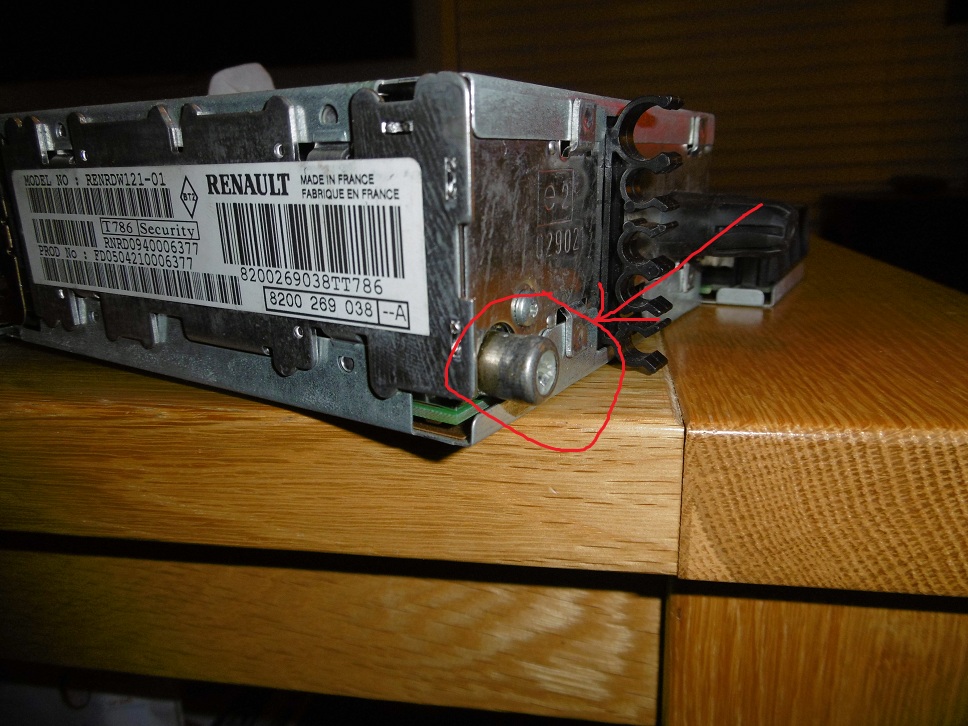

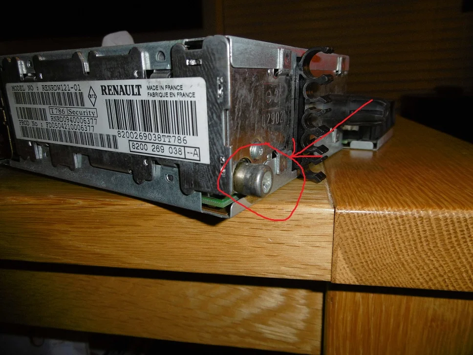

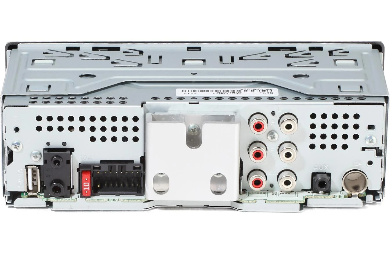

just checked and you WILL need the aerial adapter, look at the back of the pioneer,
Then look at the back of the renault radio at the aerial socket ive ringed in red.
  Clio II Phase 2
Thanks for the heads up. Then I´ll go with the MVH-X560BT.
