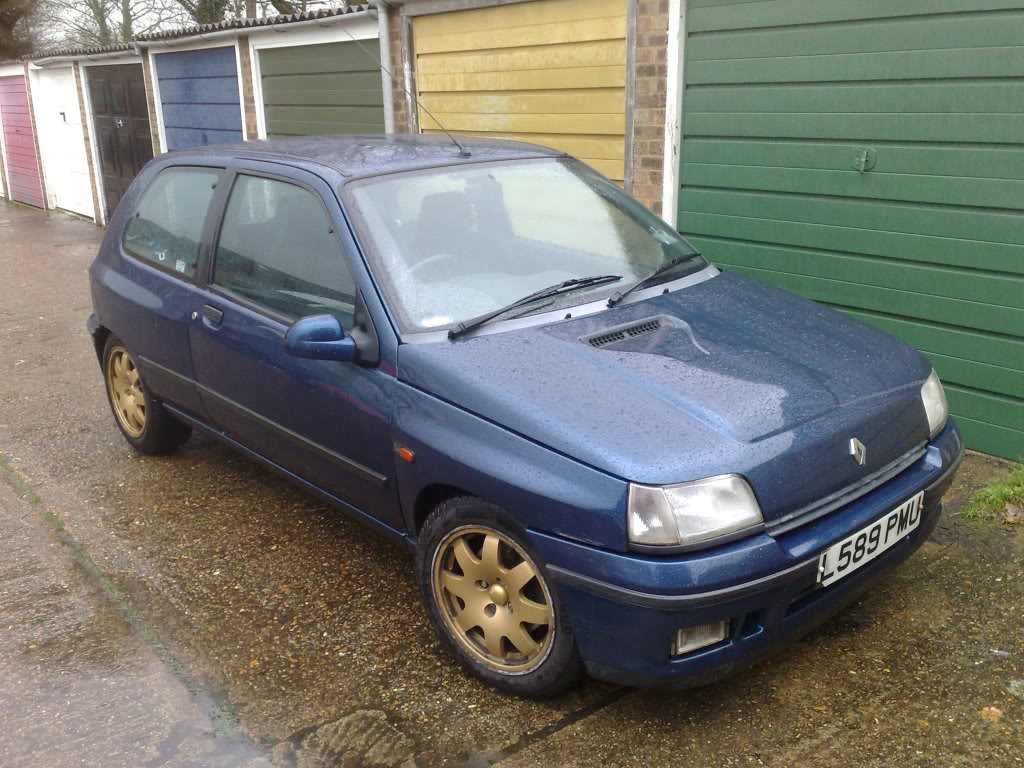

hey guys new member-first post.picked my new car up this morning i think you may like it:rasp:

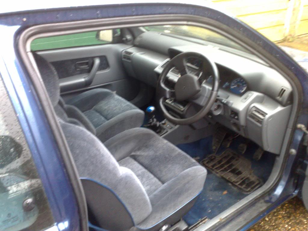

carpet [cos theres stilletto holes in it lol!!]

............other than that its got no rust at all and the seats are mint.

also guys the exhaust tailpipe is touching the back bumper recess and resonates.all the rubbers are fine so i was wondering:did the valvers have longer exhaust rubbers to stop this and mine may have standard mk1 ones??

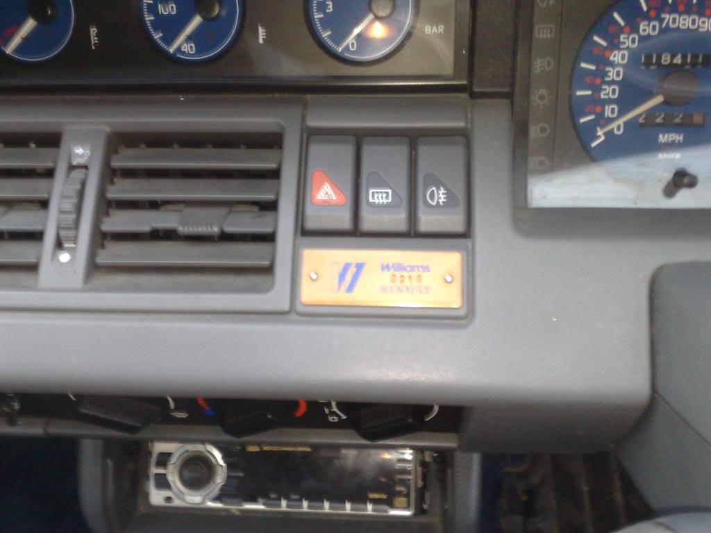

and the oil level gauge doesnt work.......any ideas??

oil level will more than likely be the sender unit, its located at bottom front right of engine block as u look from front of the car, included temp sender aswell as one unit. these can wiggle loose, or just break and need replacing.can also check connections to the clocks themselves behind the dash, just whip top dash off and check the plug.
exhaust may not be hung straight, is it aftermarket? looks like it in pic. best bet is to get under there and undo the clamps, wiggle the system around till it sits correctly and then retighten the clamps. rubbers are same across the mk1 range so unlikely to be that, just check they are all there and in good nick, if ones fallen off the other end of the back box it may be hanging low there, tipping tailpipe up into the bumper.

oil gauge has suddenly started working again as per french car standards ! exhaust is hung as normal.no hangers bent or anything its just touching the recess in the bumper so it might not have the correct hangers!??!

lol at the oil gauge thing, must be loose connector then, probably behind the clocks, so i'd still whip dash top off, 5 torx screws and its off so 5 min job if that and worth it to check. connector at sender end is attached to oil dipstick tube, this can work loose aswell so check that n all
