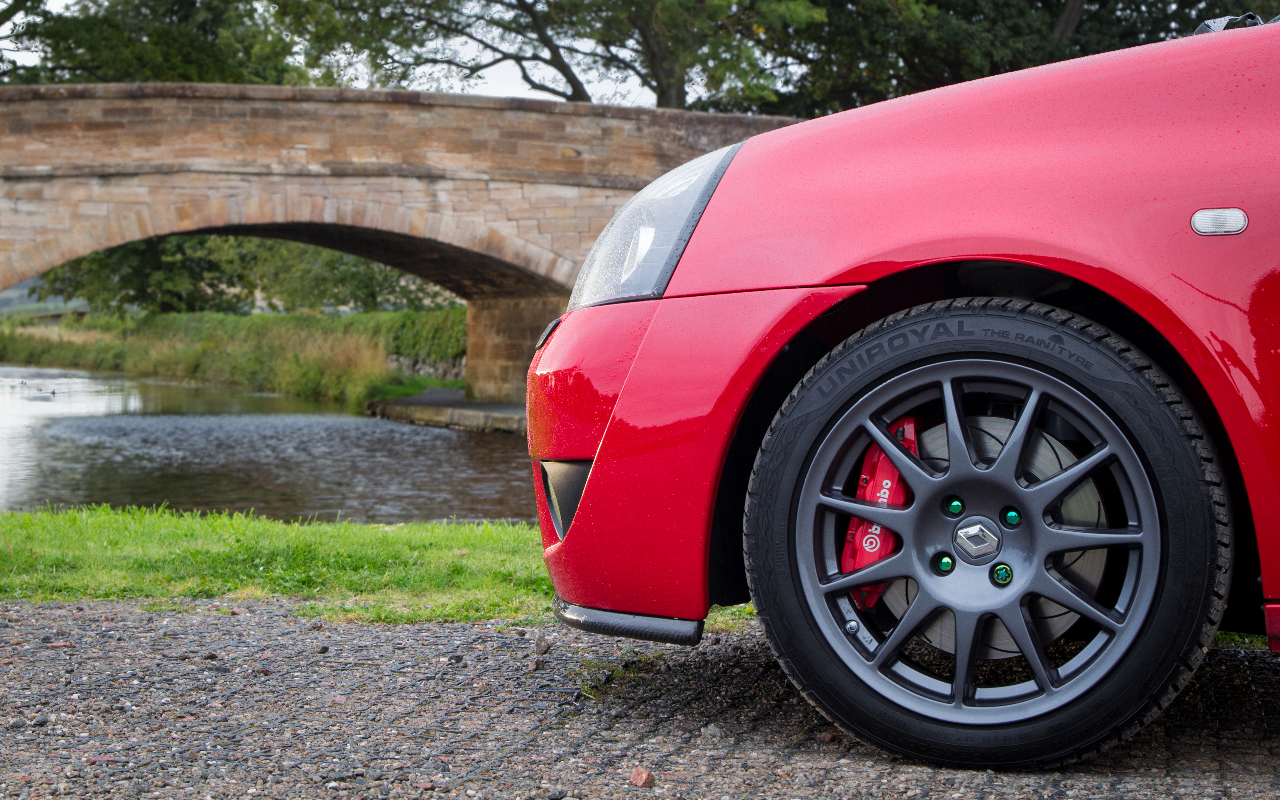

TPI Bolts are the way forward.
Been on the car for years and not rusted one bit.

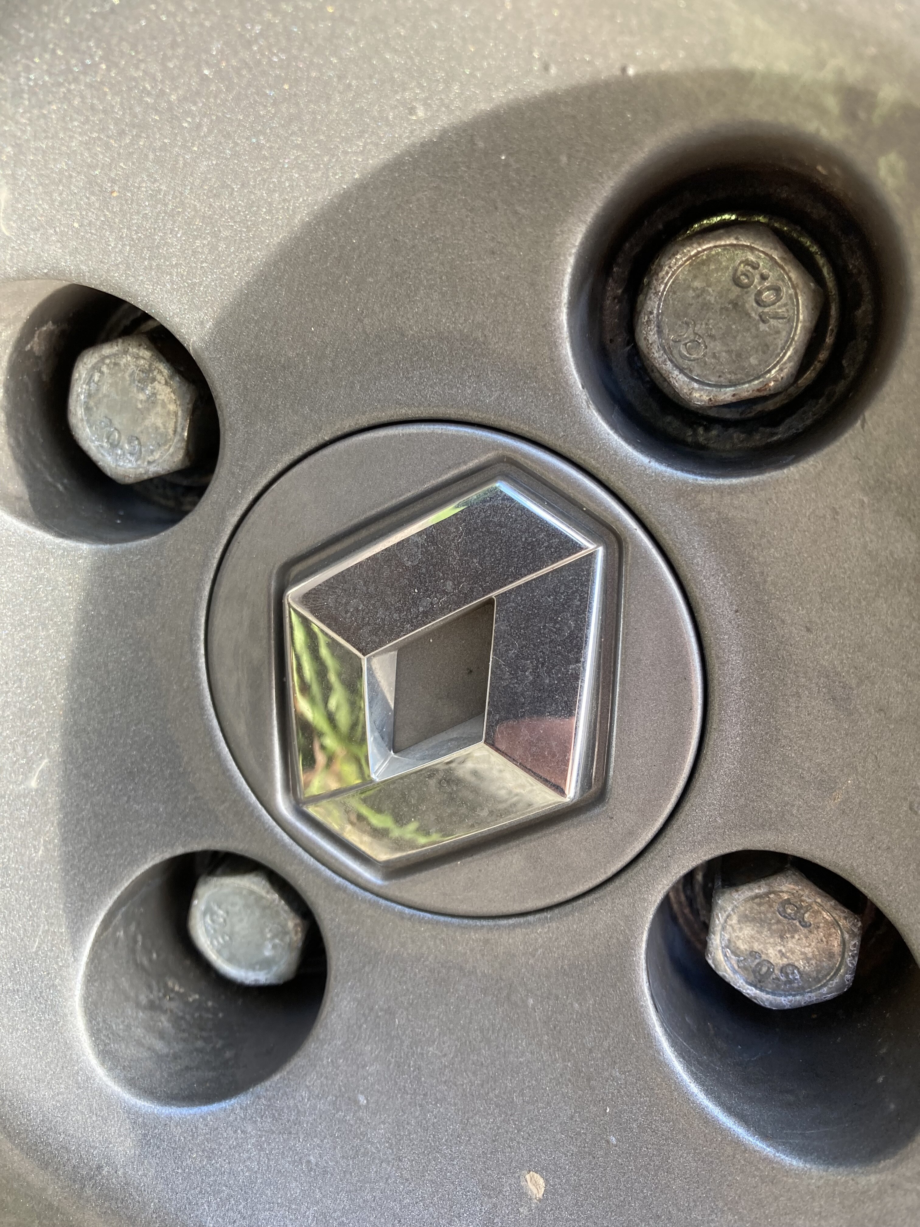

I just bought some generic silver ones to replace my crusty ones. The below specs to match the original bolts assuming no spacers etc. obviously.
M12 x 1.5, 60° taper, 26mm thread length.
