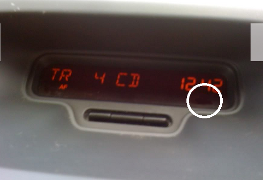

Hi can anyone help i dont seem to have a display for temp reading outside the time is there
i have different stereo in so was wandering maybe if that was the cause? 2001 1.4 16V
many thanks
  clio
as you can see no temp reading

I posted the same thread as mine doesnt display anything. Someone said the sensor is in the passenger wing mirror, so swap that with someone to see if your sensor is faulty.

I've only ever seen a false reading as a way if determining a faulty sensor.
Never seen one just go blank.
  Arctic 182
Not all non-sports have temperature sensors? You mention you have a different stereo in (although this shouldn't make any difference), did you ever have the original stereo in and if so did you have a temperature reading then?

Mine was playing up, was reading 40 degrees outside
When it gets to 60degrees it stops displaying a reading
New sensor and im back at tidy temperatures
