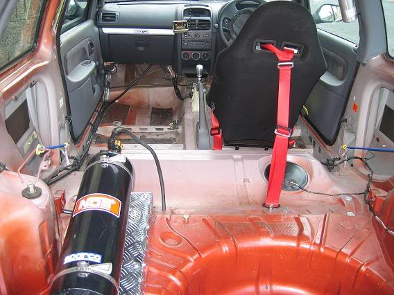

It is awesome providing its set up properly. I ran a 75bhp jet on my clio sleeper for 6 months and managed a 13.5 @ 106 mph on the drag strip. If your going to fit it make sure you use a progressive controller and an upgraded fuel pump / fuel regulator.
Old pics but all i have
