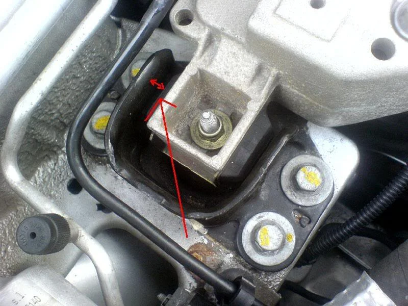

WHen does it knock, when accelerating/decelerating hard? When going round corners? When going over bumps?
Check the one under the battery, check the rubber isnt ripped, also loosen the bolts on the drivers side mount, get someone to pull the mount and engine forward and tighten. The rear rubber part should be resting on the black mount and the gap should be between black mount and the front rubber.
Failing that check/replace the dogbone mount.
one that didnt look to bad anyway, i will have to check batter one tomorrow coz of light and time, how easy are the mount and the dog bone to fit and also have you got any park numbers for both thanks
