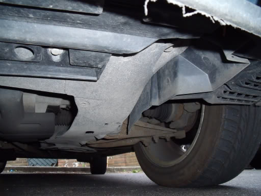

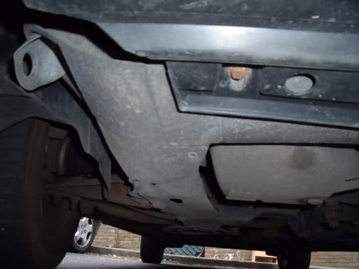

Martin i had a look under it, is the drop link the bit that is in this picture looking unattached?
I think the other side looks ok:

ah will take another look tomorrow, dug out the haynes guide for some bed time reading, and i think both those pictures line up with how it should be... Also know where to look for the anti-roll bar now too!
Martin_172
yep that ARB is fine.
give the suspension a bounce up and down, when you bounce it down it should come straight up on the rebound and then settle and not keep moving. this isnt the "best" test you can do but it shows obvious issues.
