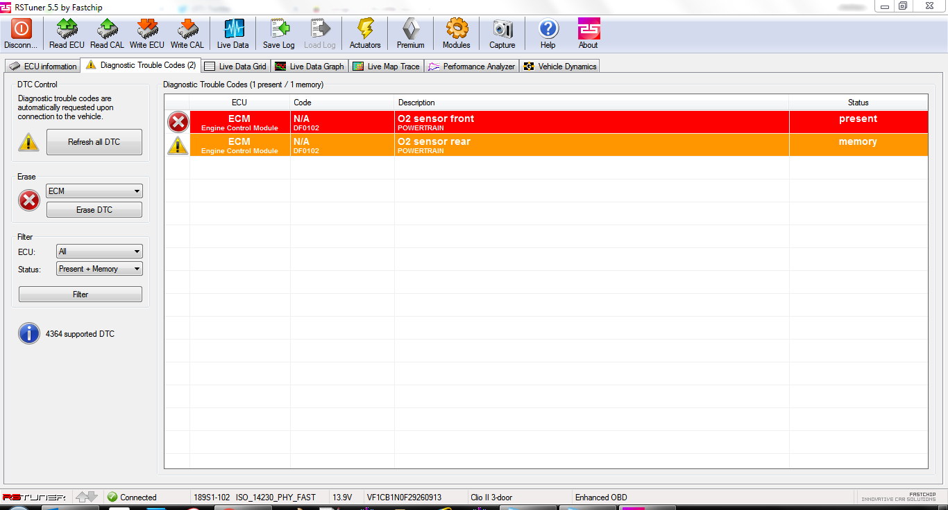

Today however, the EML came back on and as soon as I got home, I plugged in the RSTuner to see what was what and I will be honest, I am a bit confused/worried.....was hoping you could give me some thoughts or pointers?
So firstly, I read the codes and saw the following:

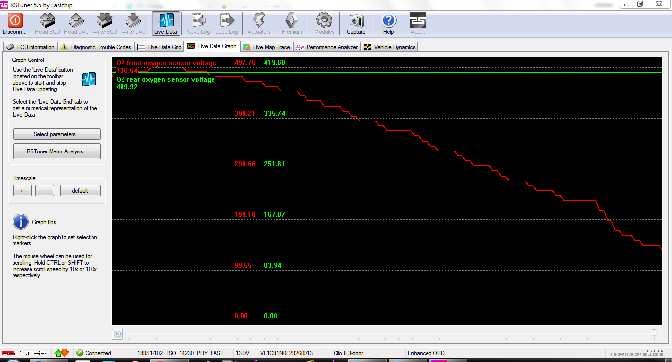

And then I decided to do a live trace of the O2 sensors and see what was what:

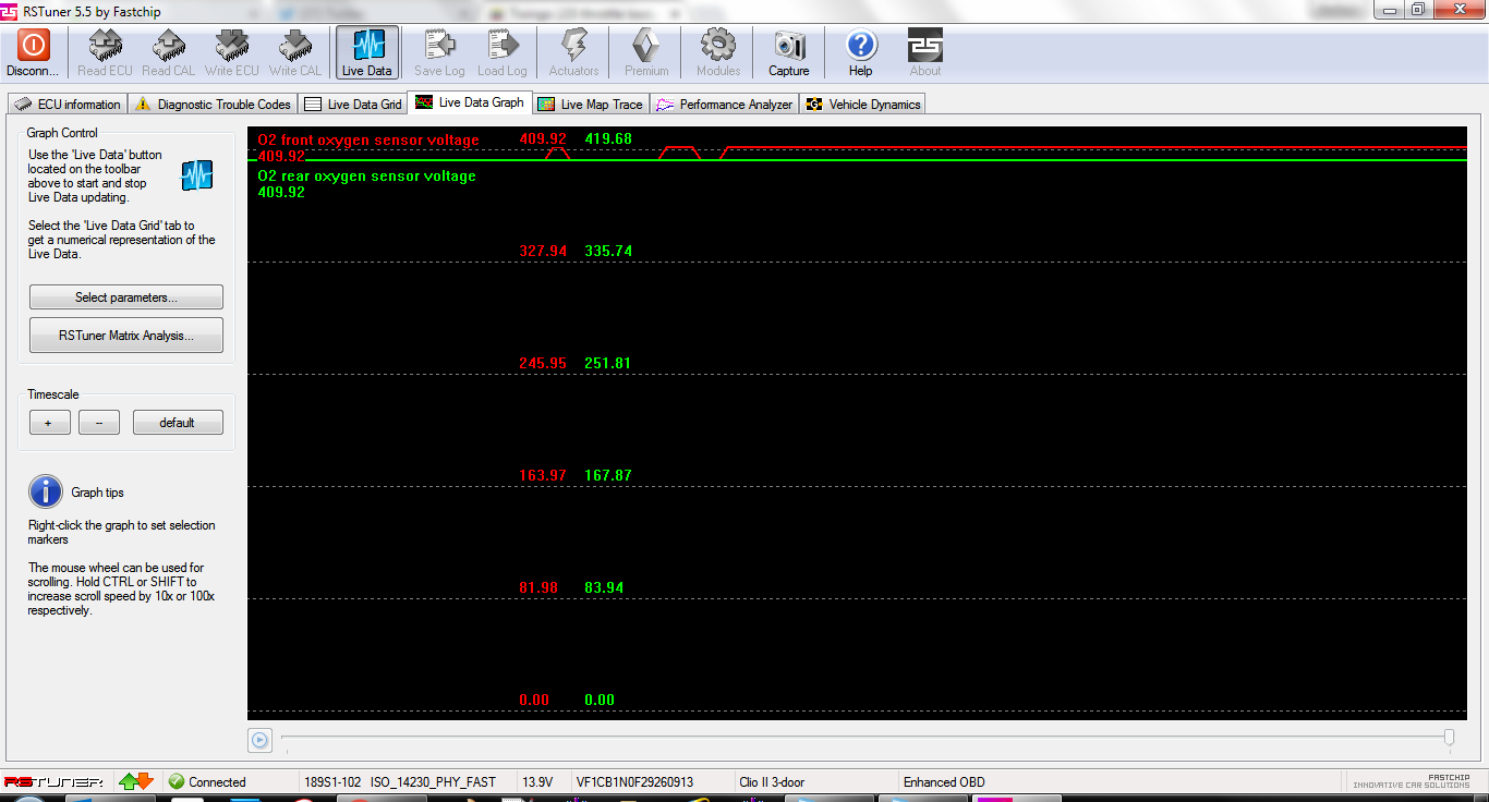

Ignition just turned on and I can see the front O2 sensor ramping up, which i thought was odd:
Ignition still just on and it settles like this:
So when I start the car this happens, front O2 starts to drop:

OK, so. I'm no expert but it looks to me like the lambda is functioning correctly. It's just switching between closed loop (where the ECU uses the narrow band lambda sensors reading) and open loop where it uses preset values. Usually open is under acceleration and closed for idle, light acceleration and certain rev ranges. I think the ramping up you're seeing is the warming of the lambda sensor.

But, no EML light......and after a fairly heavy hoking......same as before, but the O2 graph looks like this

I pulled the HAAS sensor as I have no confidence in it given the lack of movement in its values.
I put the original one back in but swapped it with the rear O2 (which was basically fused to the cat might I add). So right now.....both original O2 sensors in but swapped position and the results are as I posted above.....with no EML light.
I am pretty confident that the HAAS one is borked. Was doing some internet reading (dangerous) and the O2 sensor should definately be showing a sine wave at idle which it wasn't. The old sensors seem to follow proper behaviour (sine wave at idle and constant running with the front O2 going flat at WOT).
I think if there was an injector problem causing rich/lean running......it would have affected the old sensors the same which does not seem to be the case.
