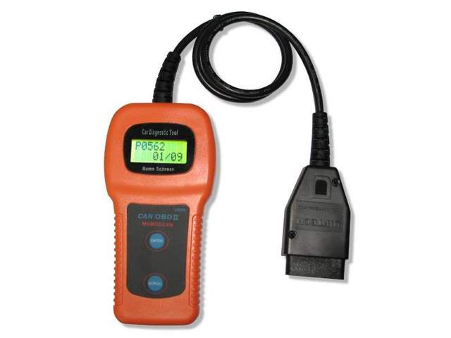

I'm looking for a cheap scan tool to remove the emission light caused by my de-cat. Any available which are guaranteed to work?
They'll remove the light but it will come back on almost imediatly.
Are you sure it took 8 months for the light to come on the first time.
If I had to reset it every 6-8 months I wouldn't mind.
There are a few on ebay from £30 upwards. Do I need a can-bus version as I have a late '05 model?
Its completly random when it wil come on might come on 1 second later might never come on.
You want on with ISO 9141 I think from memory.
I got one from him, he's slightly cheaper on ebay.
It arrived today and I'm pleased to say that it removed the emission light.
Been driving around most of today and the light hasn't come back on!
RESULT!!!!
