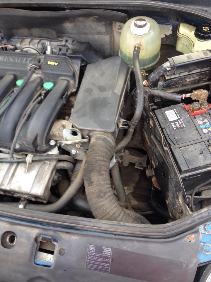

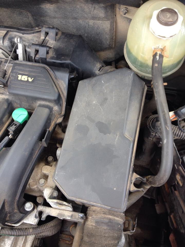

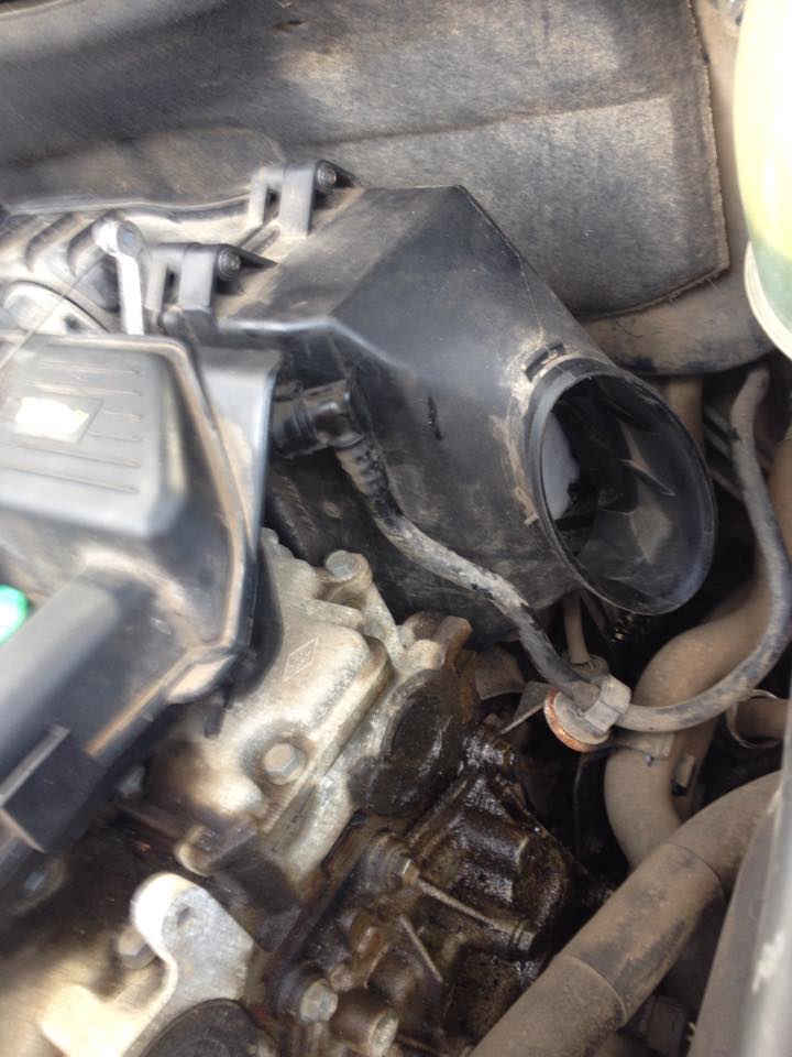

i have the exact noise on my clio alize 1.4 2001 and i mean the noise is exactly the same could you tell me where this breather pipe is located on the engine or even better supply a pic i would really appreciate it.
There should be a small diameter hose that connects to the air intake, it will be close to the throttle body. If yours is just standard then It could be blocked or squashed. Pull it off and inspect.
is this the pipe you mean under the air intake? thanks for the very fast reply very much appreciated.
