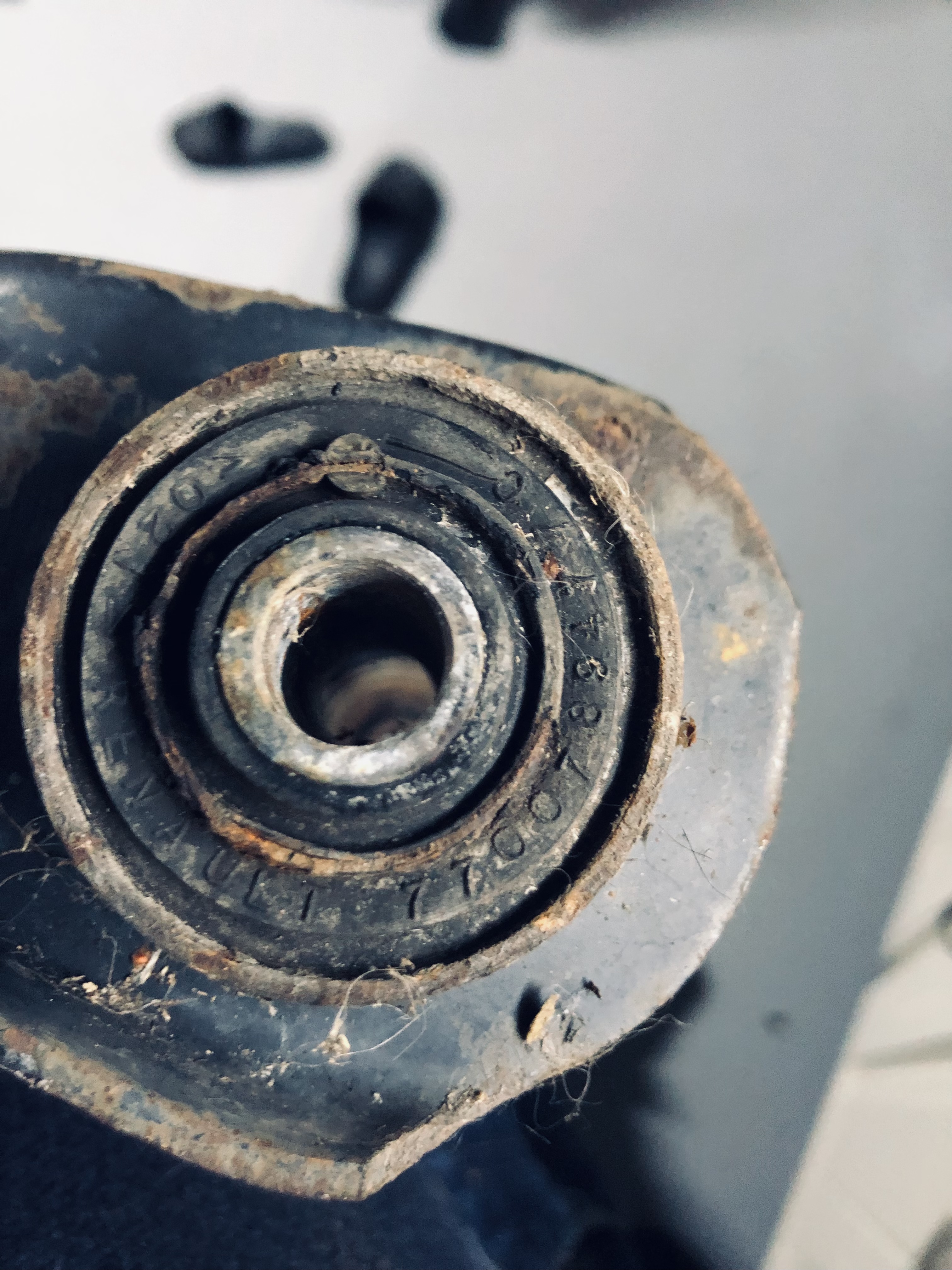

On a used set of extra caster wishbones the bushing has part number 7700789477 C. have now ordere FAI SS5266 based on new part which look right.
These look exactly like the ebay specials that I am replacing on the car atm.
I don’t claim to know more than ktec but all other sources say the aftermarket ones do not have the extra caster. Copy and paste job maybe? You can usually see the ball joint comes out square with the wishbone, the extra caster ones crank the ball joint forwards slightly.
Anyway just updating to say the FAI SS5526 fit perfectly in the OEM wishbones
