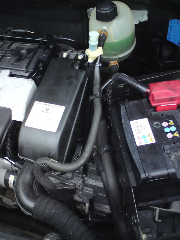

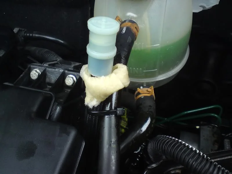

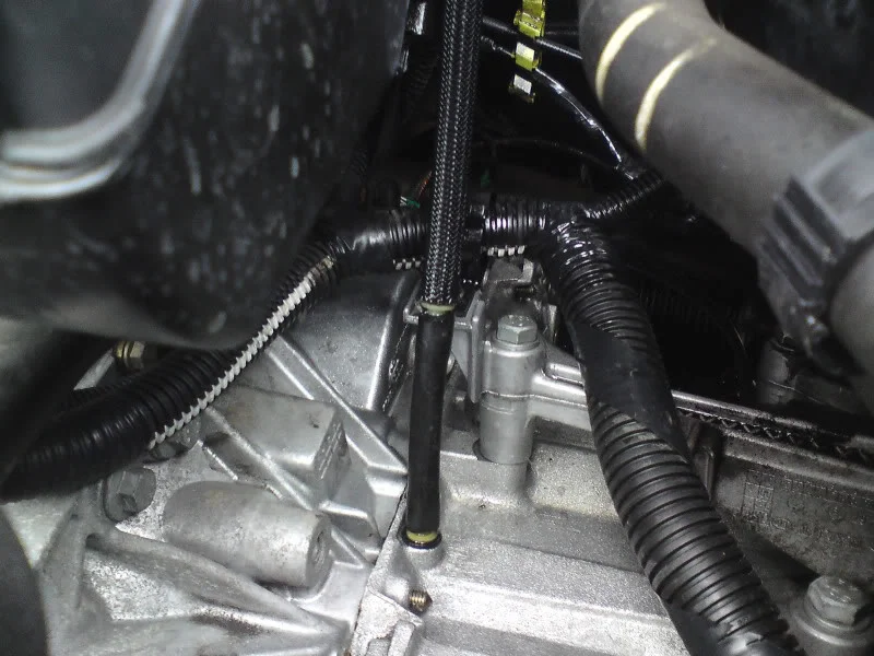

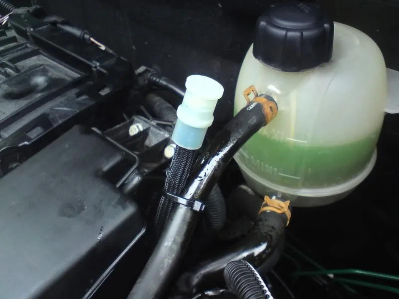

I've just taken a few pictures showing where the oil is leaking out from the top of the breather pipe and also a picture showing where the oil runs down the outside of the pipe into a puddle on the top of the gearbox casing. Ignore the kitchen roll that was tied round the top, it was just to see whether it leaked much on shorter low speed journeys.

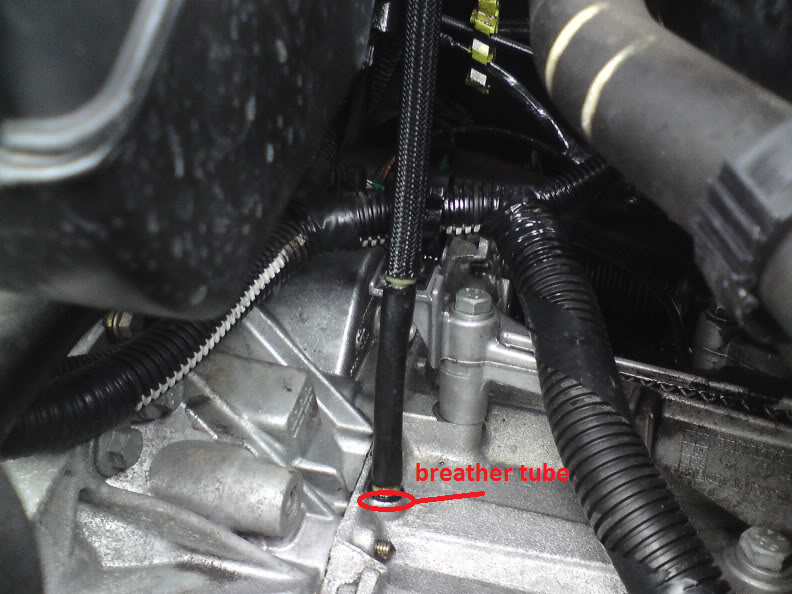

Lower half of the pipe and gearbox casing.
Top of the breather. You can see where the oil is leaking out then dripping down.
Top of the breather with the oil soaked kitchen towel around it.

sometime the breather tube inside the gearbox is damaged and torn during dismantling. This breather tube in most of the gearboxs look likes S shape. well if it is damaged the oil penetrate and oil leakage is the consequence.
has any one check this breather tube checked inside the gearbox?
