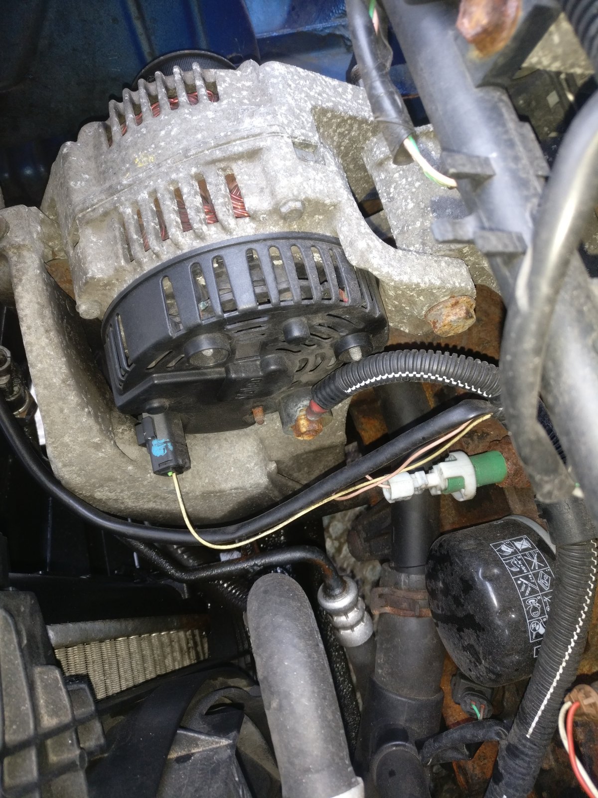

Found a leak on the car but unsure where from! It's under the altanator or so it looks to be! It's collecting on the under tray and seeping out the front bumper where the splitter meets the bumper! Seems to be red in colour and I did notice the power steering fluid was very low! I've put a picture up but it's not very helpful! Does the power steering fluid travel around the front? Cheers

Yeah just ripped mine out this evening. I'd just check that the hose on the pump has been done up correctly
Directly under the alternator Bracley. It's got a pulley on the end of it. It will be hose going in to the top of it
