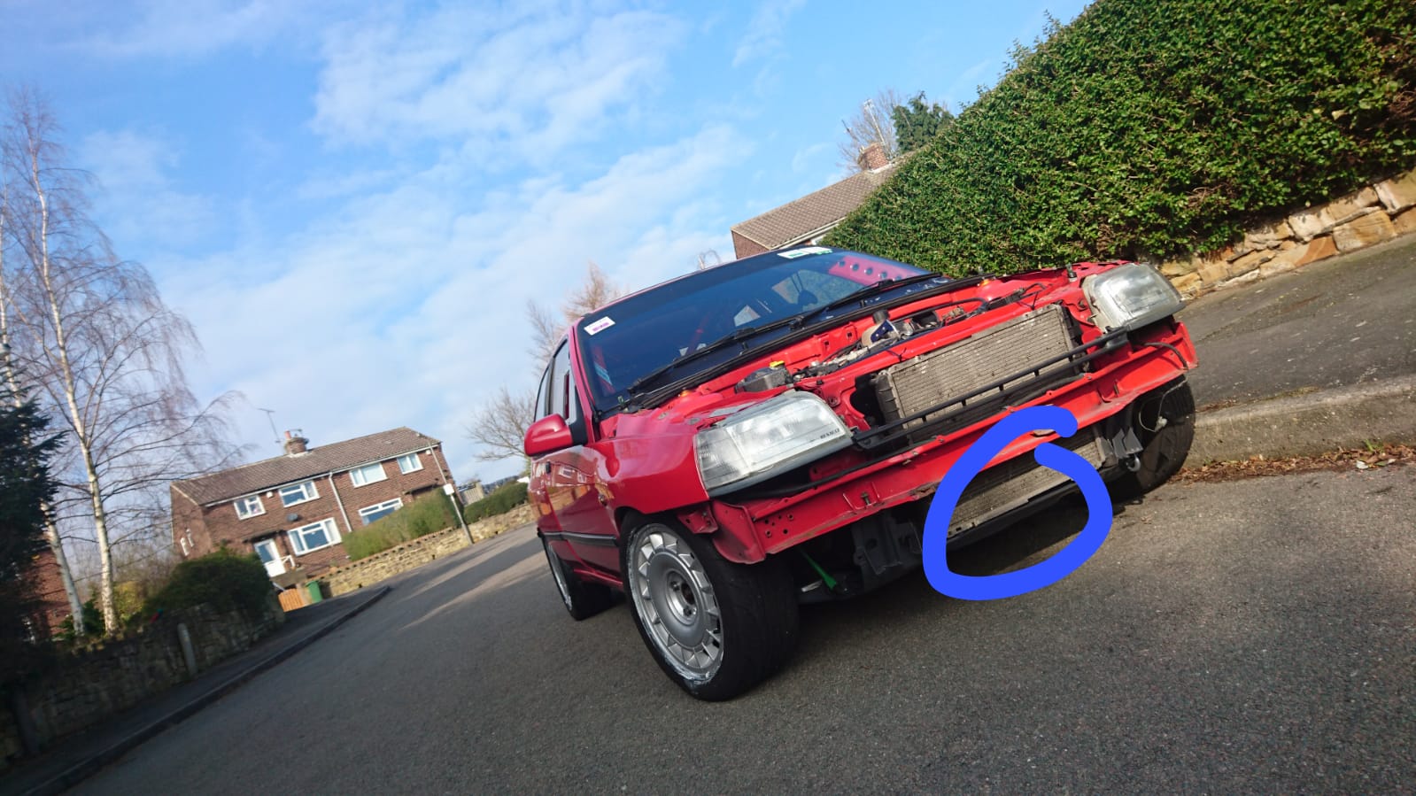

I went lower, mounted below the cross member. Gets plenty of airflow from lower cutouts in bumper
This pic was before I fitted it
@Coops Mk1
That’s right, but I wanted to keep it more hidden. The technical inspection in my country is very strict about everything that isn’t oem.
