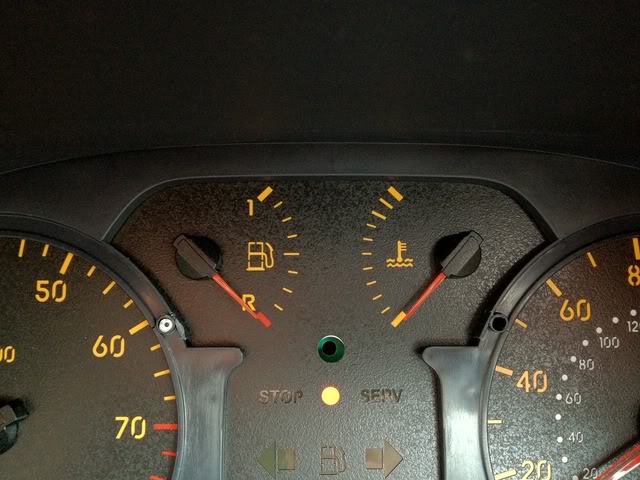

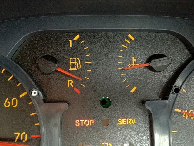

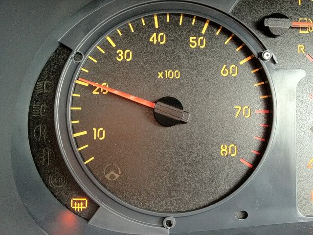

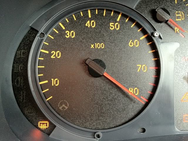

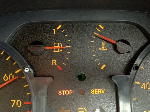

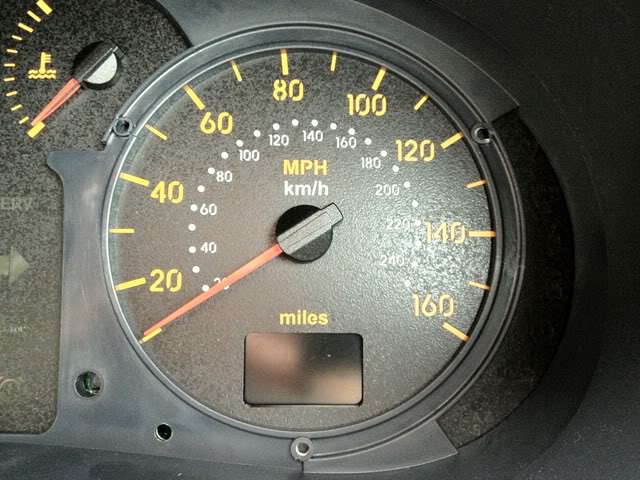

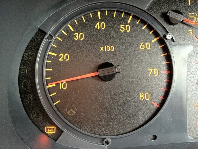

So regarding the needle positions I had a little play today, and tbh I've made them a lot better. They're now sitting okay and the 'kick' puts them back to the same position rather than increasing them each time. This is how they're currently sitting when idle...

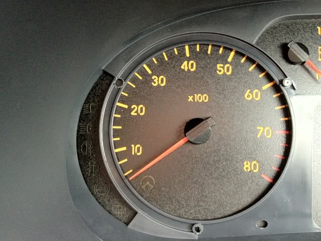

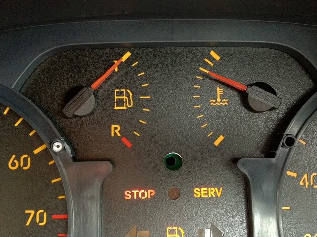

Firstly excuse the state they're in, work in progress! The dip you get after switching the car off brings them to the following, and then back to the original positions...

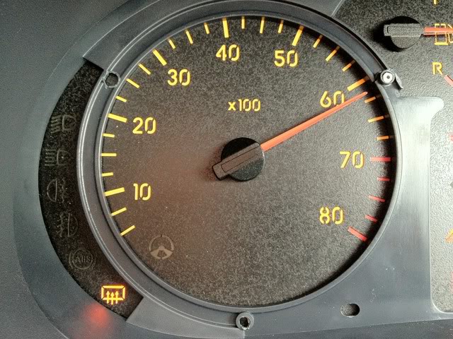

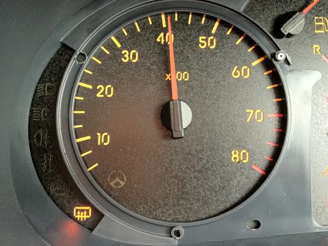

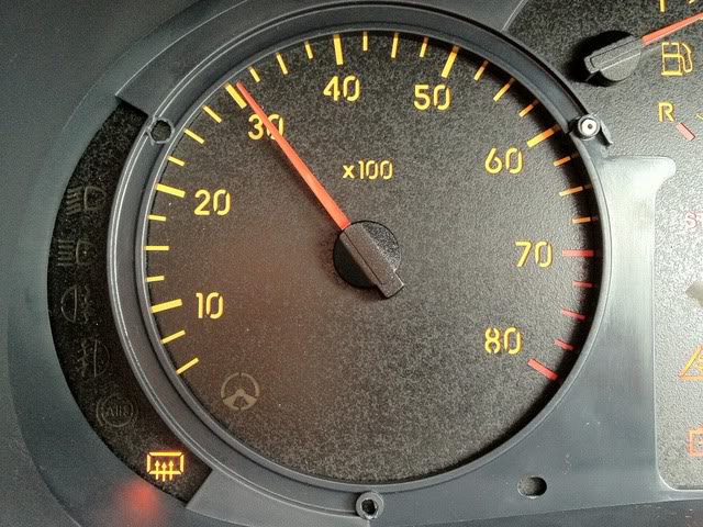

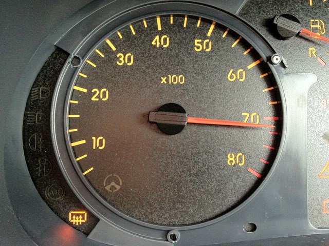

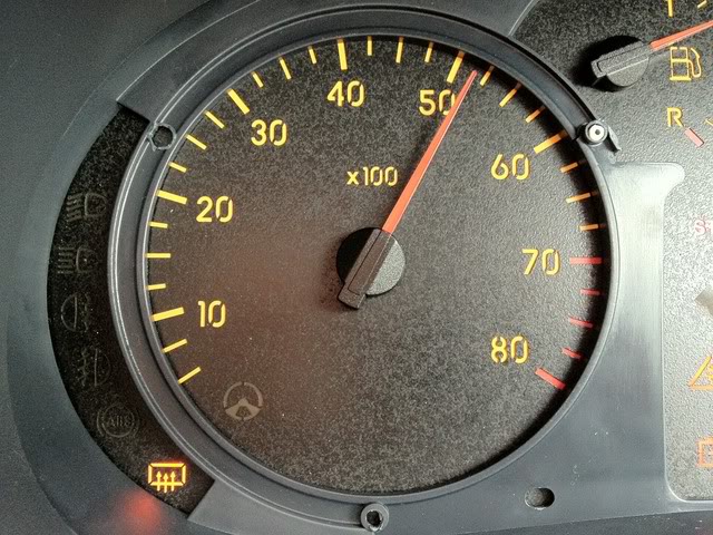

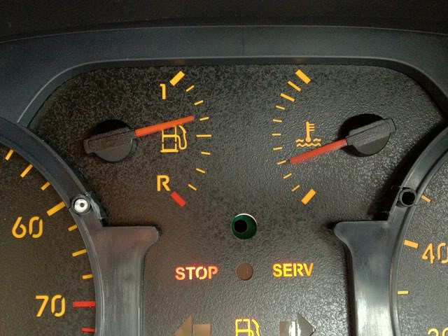

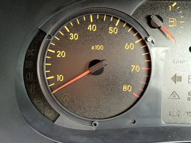

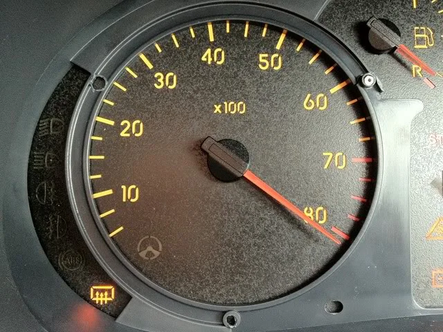

Next up I thought I'd try the needle test, and I found the results to be somewhat out...

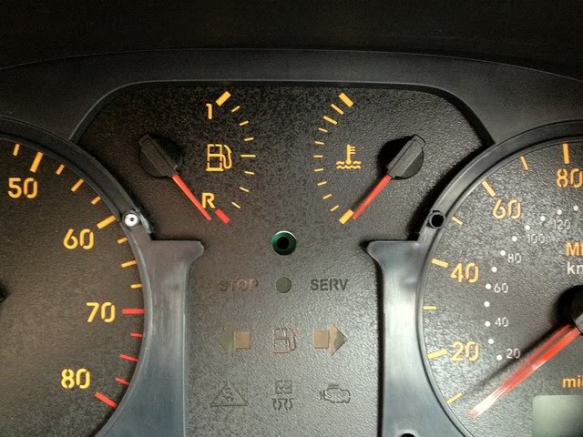

Now after looking at these you would probably say it best to lower it a bit to get the results into line, the thing is, when I do that the needle sits well below 0 for idle, would you still say that's better?

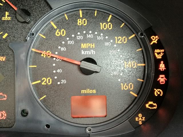

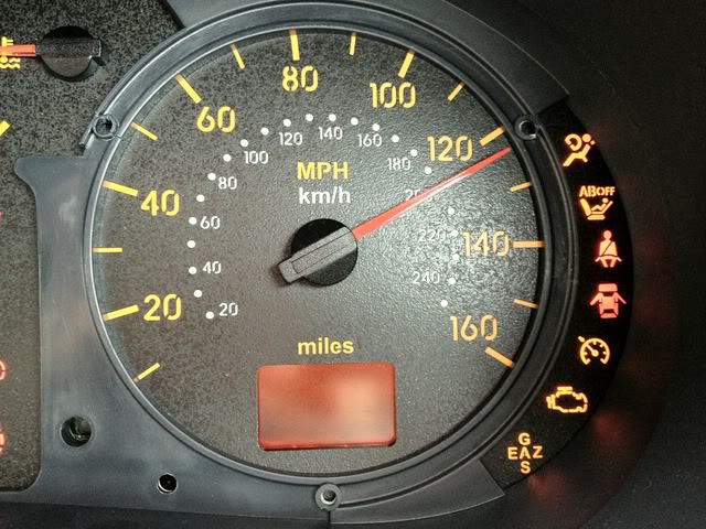

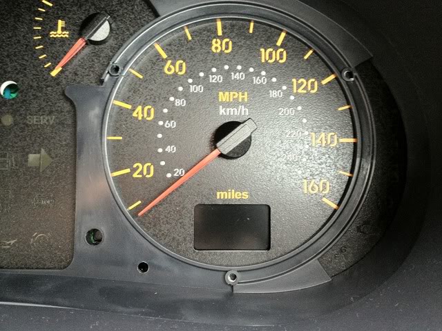

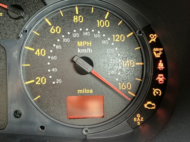

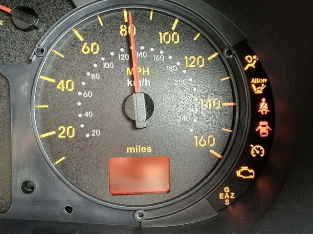

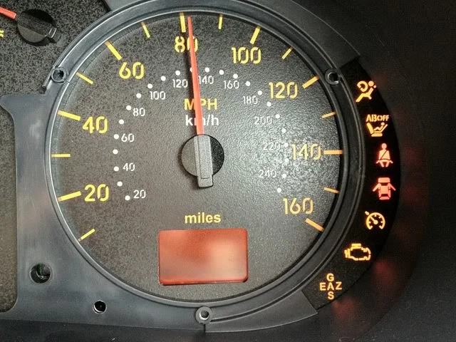

Here we see the needle is slightly off at center point, but sits pretty damn perfect at the top value. Finally the speedo which is actually the most annoying because as you can see it sits perfectly on 40 but then goes more and more out, annoying to adjust as if I bring 80/120/160 into line it's then out on 0 & 40. Am I just going to find this because obviously the dials are not standard ones? The thing is after measuring the difference is distance between these ones and standard ones there seems to be less than a mm in it, and the pictures here are more out than that!
My method of adjusting was as mentioned above... taking the needle off, allowing the car to reset the position and then putting it back on again, had to do this a few times on each to get it right. Thanks for reading as long post is long! Any advice muchly appreciated.
