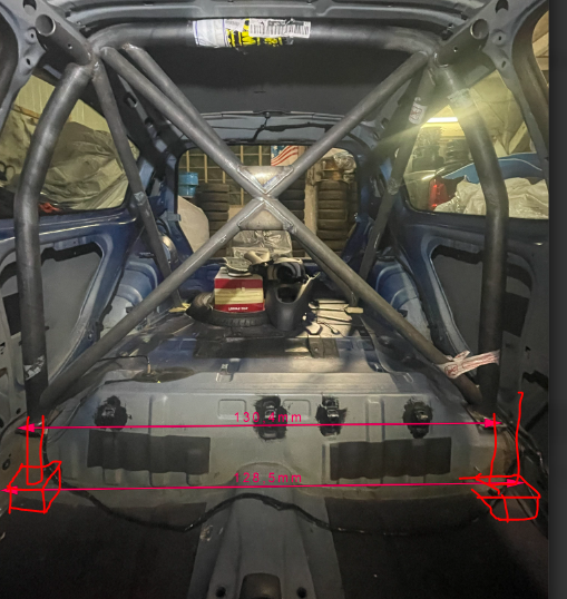

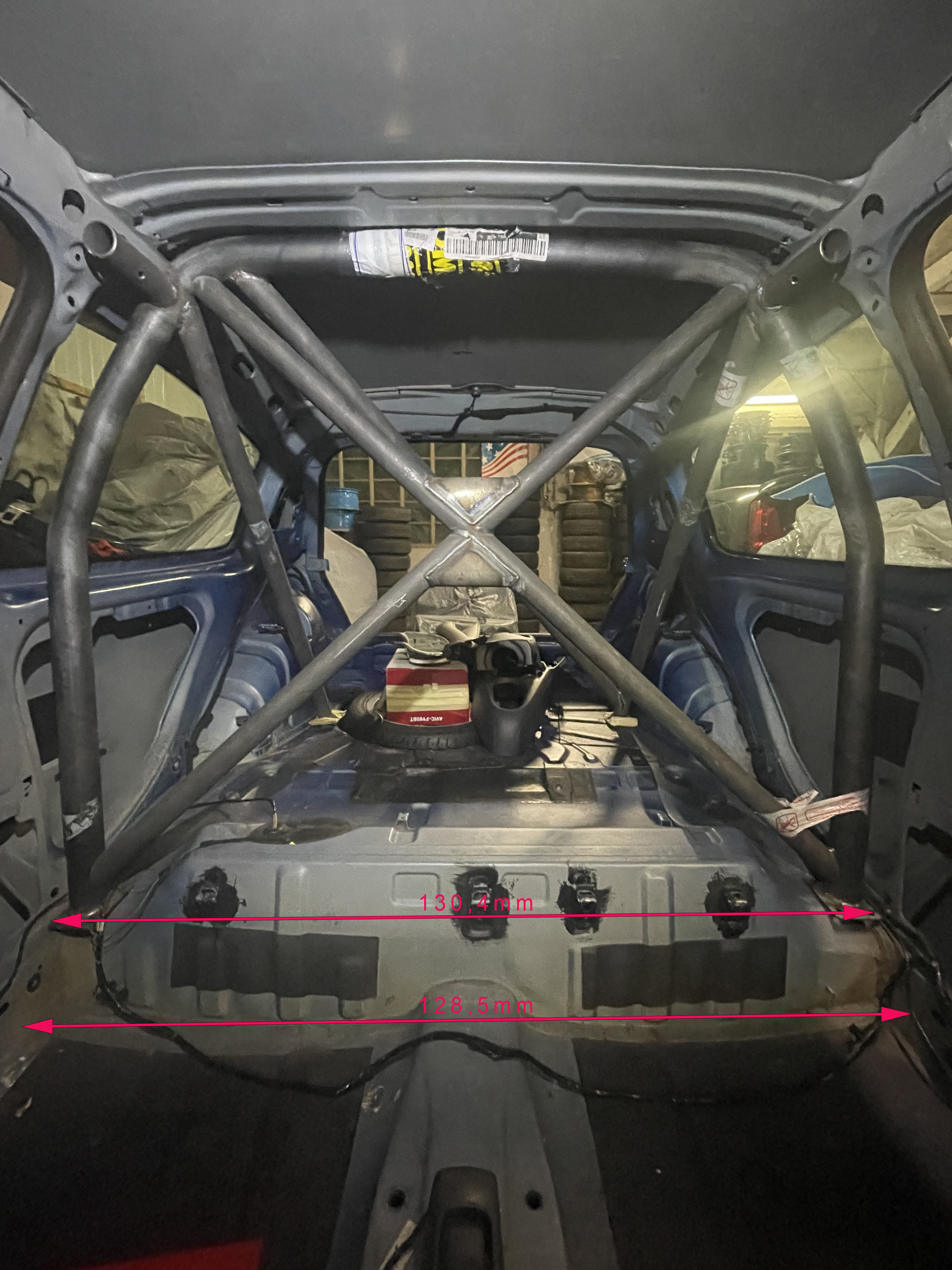

I bought the OMP Rollcage 8OMPAB105P220H for my clio rs2 2001.
Yesterday i tried to fit the rear cage but doesn't fit? The cage is 130,4cm and car is 128,5cm.

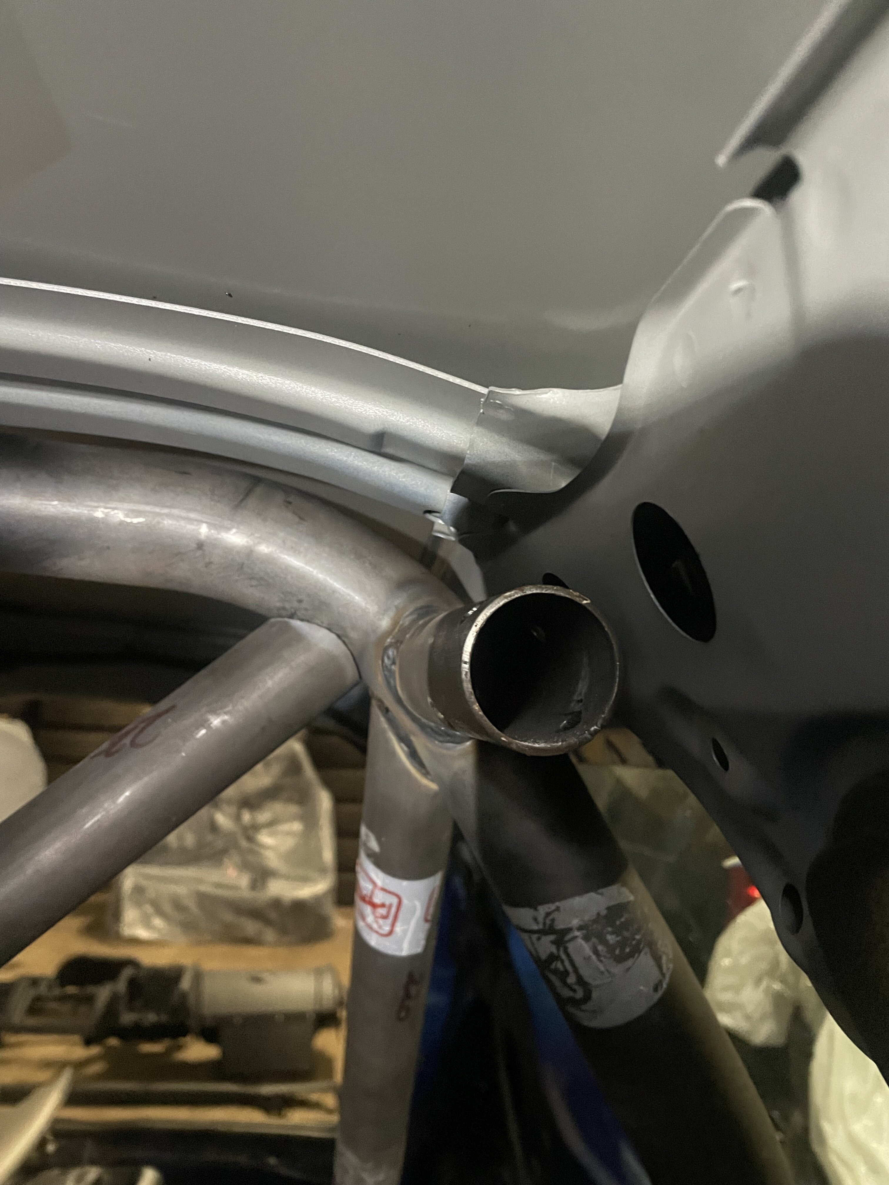

The X is not full welded but just 'pointed', is it possible that this is made on purpose to, cut readjust and weld again?
Thanks in advance!

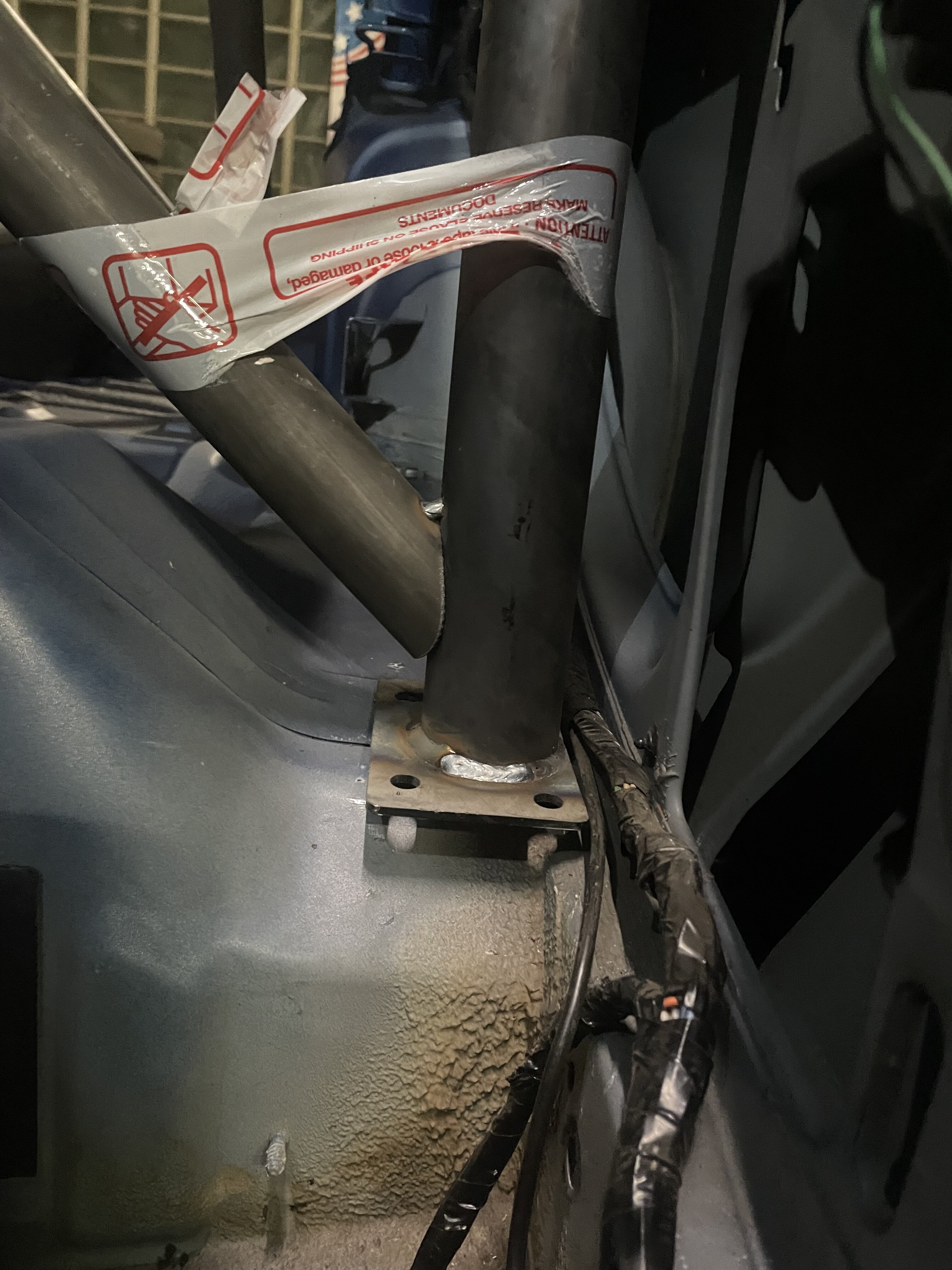

Doesnt look like its right for the car. Is it for a mk1 clio?
Either way it should be sitting on the floor not the seat base. Its normal to need to fab up some feet/boxing to make the gap up, but looks wrong as the rear legs should also be on the rear arches.

I asked the seller again and it should be right.

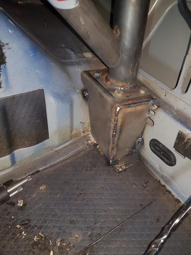

Took it to someone who done that before and he will do a stabiliser frame from top to top of the rear shocks.
For the rear legs i understand what you mean, also asked that to the manufcture and they said that’s right like this.. [emoji2371]

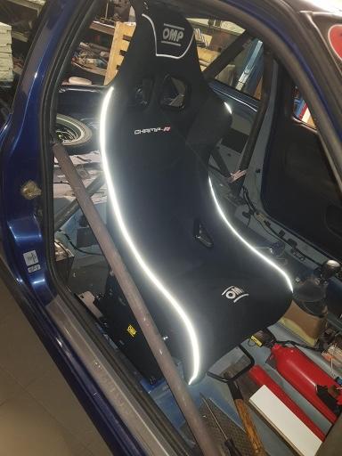

Looks like this now:
