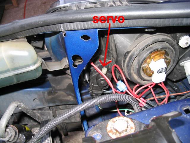

Marky_ ClioSport Club Member Car 182 Mar 5, 2008 #2 Indeed they are electrical. Have you unplugged the adjuster from the headlight recently?
DannyR Car 182, SQ7, Trafic Mar 5, 2008 #3 Not touched it, Where is it located so can see if its not poking out!
Marky_ ClioSport Club Member Car 182 Mar 5, 2008 #4 It's the black thing the arrow is pointing at. It twists and pulls out. You should be able to hear it when it's adjusting if your engine is off. If not then something is wrong with it.
DannyR Car 182, SQ7, Trafic Mar 6, 2008 #5 Hmm, It all seems fine. Thanks for the pic, much appreciated! Is it not the High beam too though? The rubber on the main beam seems very loose compared to the other side too could that cause a problem?
Marky_ ClioSport Club Member Car 182 Mar 7, 2008 #6 The rubber shouldn't affect it. That's just there to keep the water/dirt out. IIRC, the whole reflector inside the unit moves when you adjust it, so both you high beam and your dipped beam will change. Have you tried taking the 'servo' out and refitting it? Make sure the little round bit on the end is 'hooked' into the catch inside the unit.
