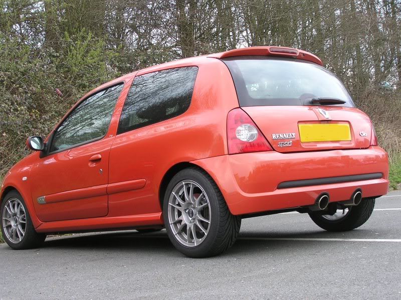

Wouldn't have thought so. Lower the offset the further the wheels will be from the suspension. Standard offset is around ET40.

Well some people are running et38 speedline turinis and not having any drama, Can search on google for wheel offset calculator and check it on there, will tell you how much more/less you have on the inside and outside!

Didn't realise the offset was different to cup alloys, so current michellin tyres will be no good then?

Will they fit on a 182 with Cup suspension?
15x7, +37mm offset.
offset on a 182 is around 45 or 43. this means they will stick out by another 6 to 8mm !!
