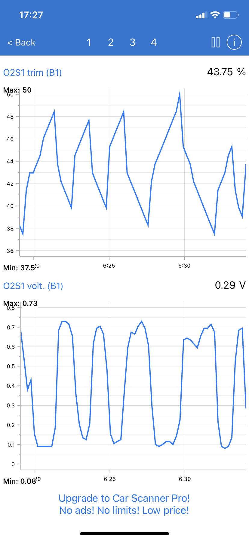

This is the live data coming from lambda sensor 1 at idle. I’ve got no idea what it should look like to be honest! Top is fuel trim, bottom is voltage
Is this with the car warm? You want it to track steady but you have to let it get warm first.
If it looks like that hot then you need a new genuine Bosch lambda

thats it hot (well, coolant at 81 so as hot as it gets sat still) and with a new genuine Bosch sensor from euro car parts. Going off what you’re saying then I’ll go back and shout at them tomorrow and get another one cos that’s clearly not right!
Depends how good your software is I guess. Might just be lag in that, better in clip
could be I suppose. I’ll take it back tomorrow and see how I get on. Suppose I can rule wiring issues out though as it’s clearly doing something, just not the right something. Don’t have clip so stuck with that one!

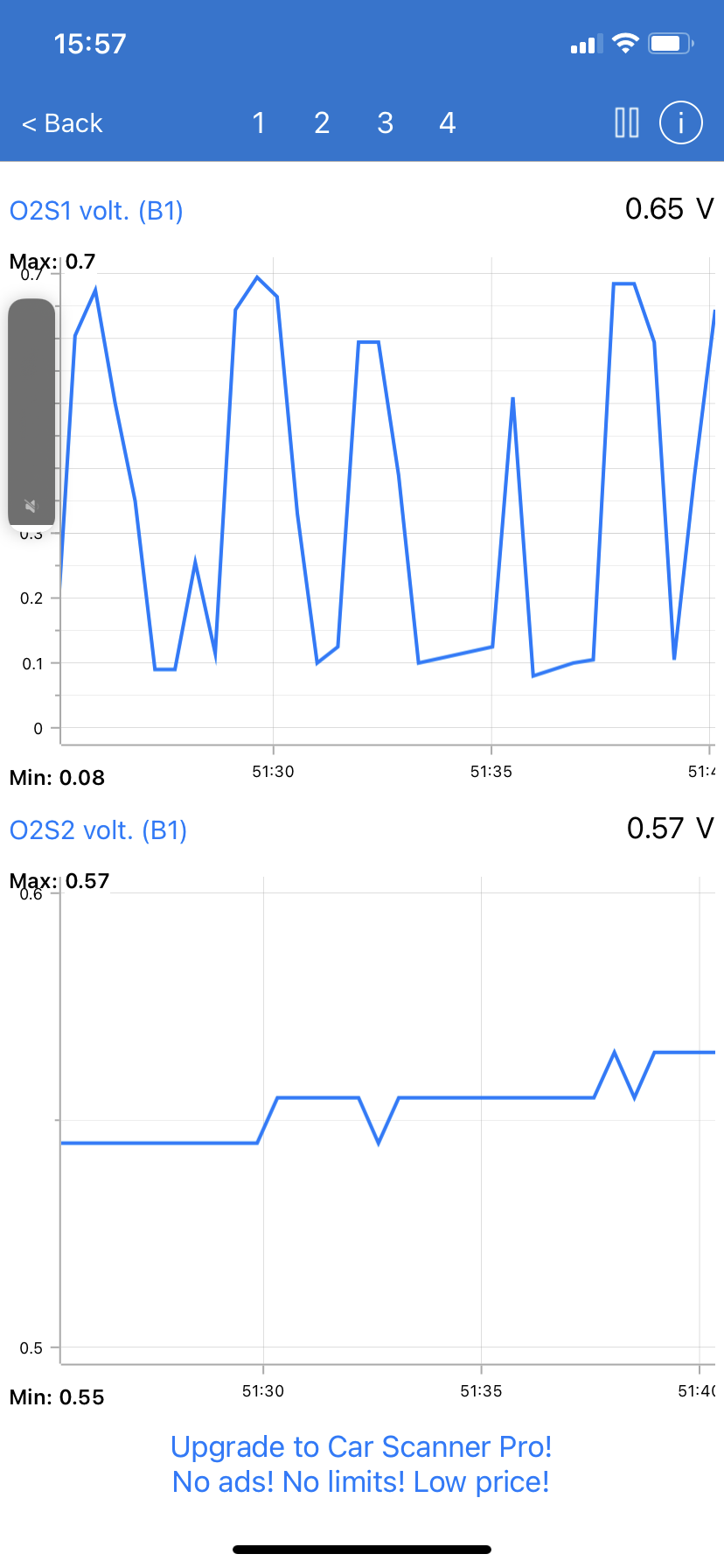

Its just meant to track faster. Your post cat should be a stable voltage.
Yeah, post cat was totally flat. Had the odd little dip now and then but aside from that it didn’t move

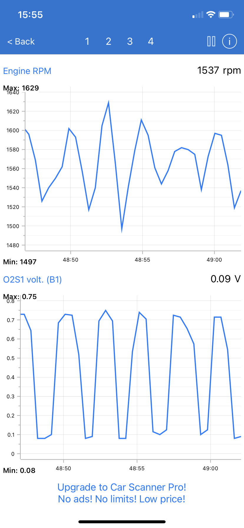

Rpm and o2 with revs held
o2 1 and o2 2 at idle. Bear in mind there’s no cat
