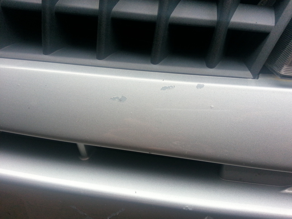

well i know a few will say should have washed it myself, i know, i was been lazy, but its beside the point.
had my car washed by one of them drive in wash places, one ive been to many times. got home to find the paint had been blasted of by there jet wash.
i was so angry, words cant describe, an the fact that they didnt tell me and let me drive off made me even more angry.
so went back to them and they have told me to come back later and they will ''fix it for me'' which i cant see happening, ive had a few quotes on the repair done properly of arround £250
Whats can i do if they wont pay up???

oh dear, looks like its come off from a previous repair on the bumper or a respray it may have had. Notice the silver inserts next to the 'vent' holes, they should be black if it was original.

This. Your bumper has more than likely been repaired previously, they obviously havent done a proper job and now your suffering the consiquences of a previous owner by the looks of it. Unlucky :(

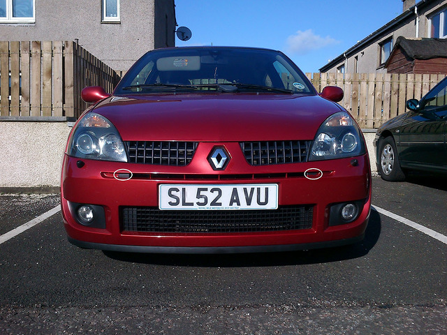

Edit: OP; Look at your bumper, see underneath the edge of the headlight there appears to be an section of bumper thats pressed in further than the rest? From Renault they have a textured black sticker that fills this gap the fact yours doesnt mean they have been removed (potentially during repainting)

It'll be down to a poor spray job. Mine is doing the same and mine is only ever hand washed by myself. Basically the bumper wasn’t prep'd properly before being sprayed.

Renault paint isn't prone to flake like that, Ford's are terrible for it. That's 100% been painted and they've not prepped the plastic properly. See it a lot
That, or they got ridiculously close with the Jet wash, which is the card you want to play anyway lol. Say you've had it from new

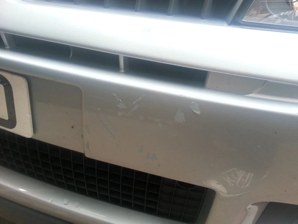

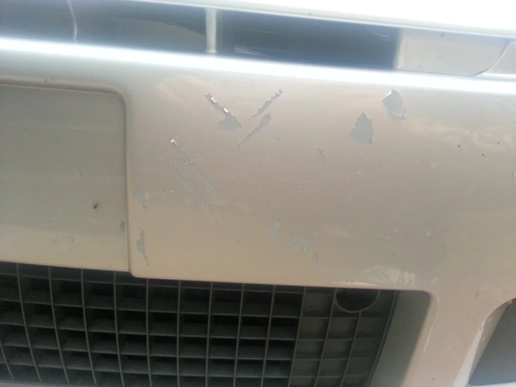

Juts a s**tty paint job I'm afraid.
100% wouldn't have happened to an OEM finish.
Second pic looks like a rattle can special.

Masking lines (top right) and micro-blistering all over the shop.
But either way, the car wash guys have got too close with the jetwash so they need to sort the problem.

Just to confirm when ash brought the clio i belive he had the front bumper resprsyed due to stonechips hence why the bumper hasnt got any black stickers.

I never had it painted when i owned it, when i bought it the inserts were missing i just never replaced them, which led me to believe it had been repainted before i got it. glad its getting sorted tho pal.
