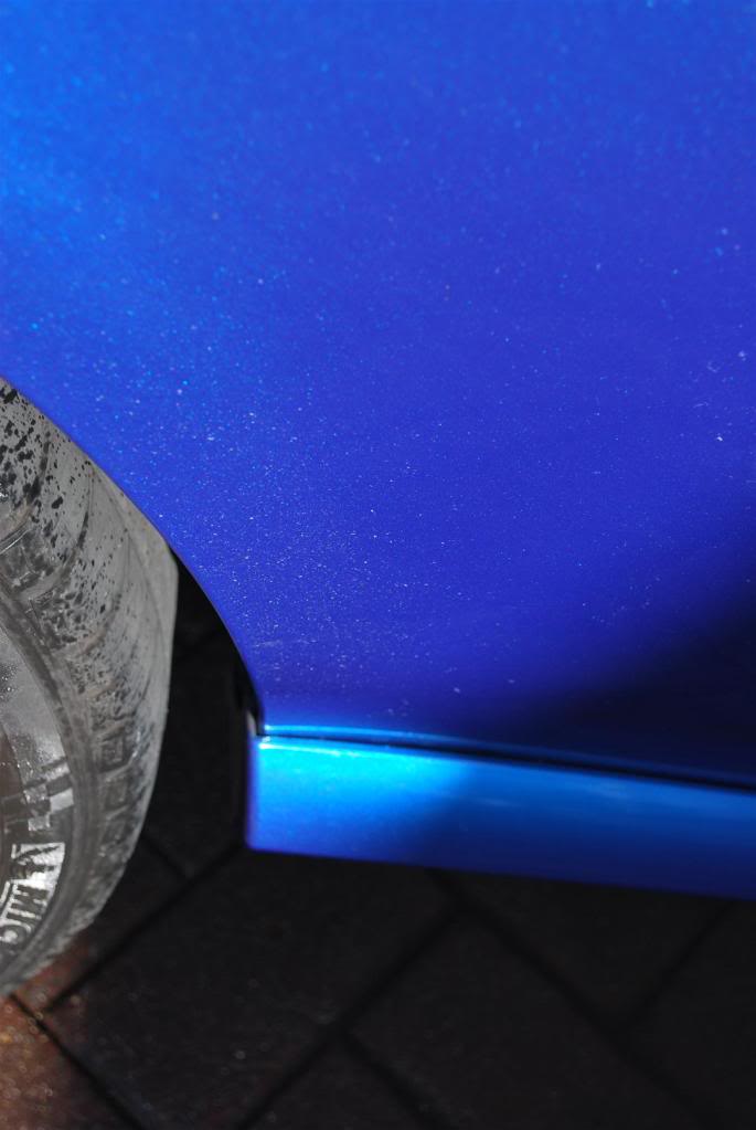

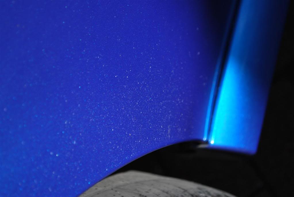

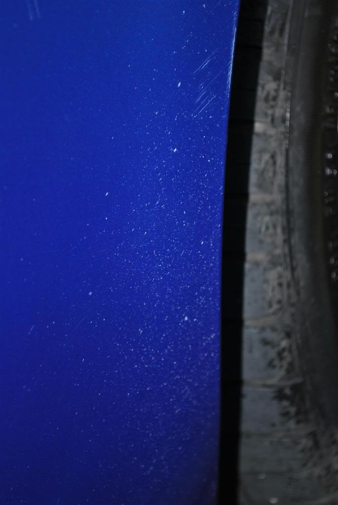

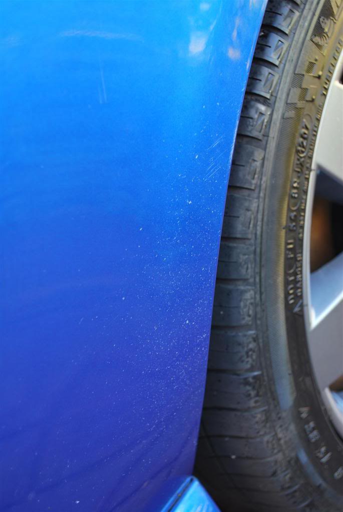

got some marks on the paint work around the wheel arches.
can someone give me some tips to remove them please?

stone chips or overspray from the alloys maybe a smart repair?? can't really tell from the picture but the colour looks similar to the alloys
try claying the area
Daz.
  Clio 200 RS EDC
Yup have them on mine, I'm going to get the quarters painted at some point
  Evo 6, E92 320d
Get a fine detail paintbrush and a touch up pen and spend half an hour touching them all in, wet sand with 3000+ and buff up to perfection :).
