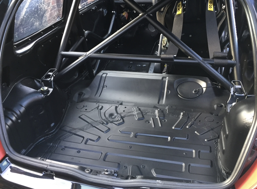

JimF
  Clio 172
I wrapped mine with Tesa loom tape (cloth tape that looks oem), and relocated the boot light to halfway up the C pillar. I used satin black rattle cans and the result was very similar to the above. My only pointer would be that it absolutely stank of paint for weeks after so definitely worth letting it air out afterwards. And I like the smell of paint.
