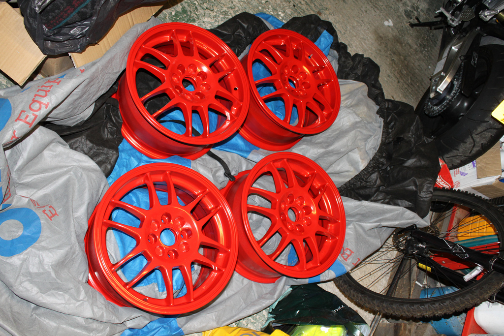

Try it yourself, I did mine and a lot of people have done there own, Painting isn't hard its just refining the last details i.e. a good lacquer coat, no runs in the paint..
Should be fine, all you have to lose and i mean this seriously not sarcasticly is a few nights sanding and painting and a bit of ££ on paint...
Then again if you want a perfect finish take it to a specialist.

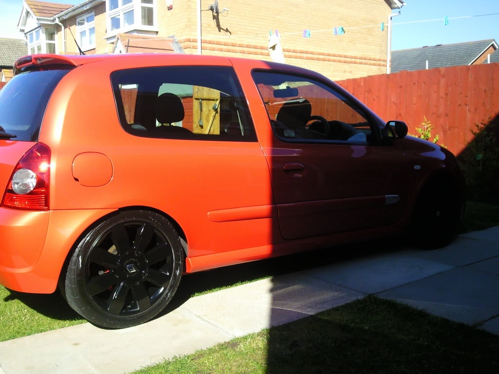

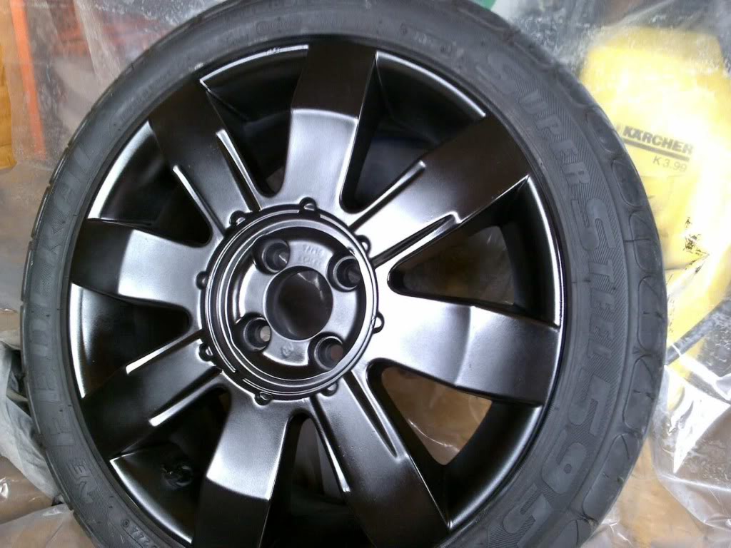

I done my wheels myself first time i hade done anything like this and think the result was pretty good
