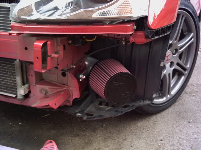

i think a pannel filter is a waste of time tbh, had IK's and pannel filters as well as bolt on for older cars with carb's..... if you have a pannel filter it will make sod all difference when comparred to the std pannel filter, anything open such as a bolt on or open cone will have heatsoak regardless of whether you have a heat shield so i would say that a ram air filter that is enclosed is your best bet with a cold air feed. the only exception to this rule is if you have an open cone induction kit that has the cone well away from the engine bay, in the bumper for example like the AEM Cold Air Intake they do for Honda's. i have had them all and would say that the AEM is the best by far, they dont do anything like it for a renault though unfortunately!

well i ran an AEM Cold Air Intake on my Civic Type R for 12 months driving it every day in every condition imaginable and never had hydrolock once even with the cone sitting behind the front bumper here ------->
if it was dry enough here you have no chance of getting water up a cold air feed pipe!
if they did an induction kit like this for the clio i would buy one without any hesitation at all! this had almost identical gains to a £500 ram air induction kit but only cost £180!
