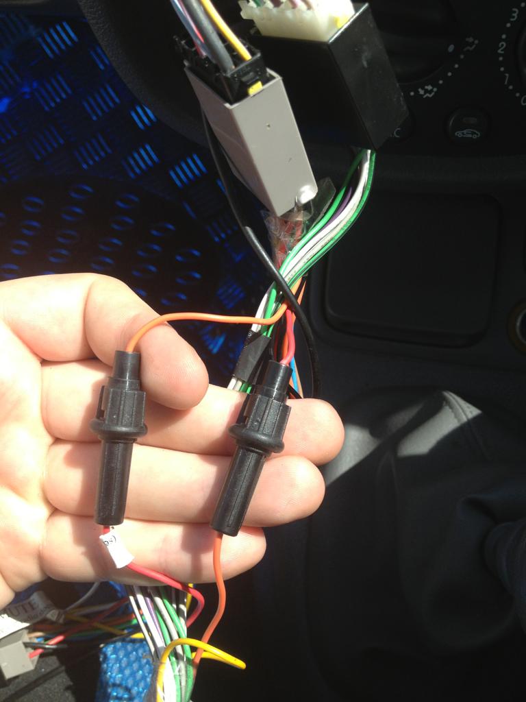

Take your pick mate.
Im absolute cack with wiring.
Go to your blue box, and on the wiring from that to your stereo wiring there is a red wire and an orange wire with black plastic things on, they're fuse holders. Swap them so they go red to orange, and orange to red.

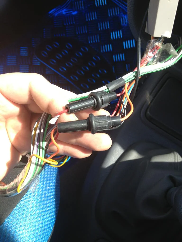

This bit in the picture?
Am I just unplugging them and swapping them?
so root is red but then turns to orange? Vice versa.
Or do I need to change that whole cable over?
So it should look like this after?
(I won't put ignition on yet incase this ain't right)
​So the red has turned into an orange cable, and the orange has turned in to a red.

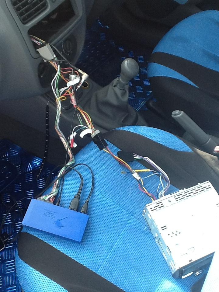

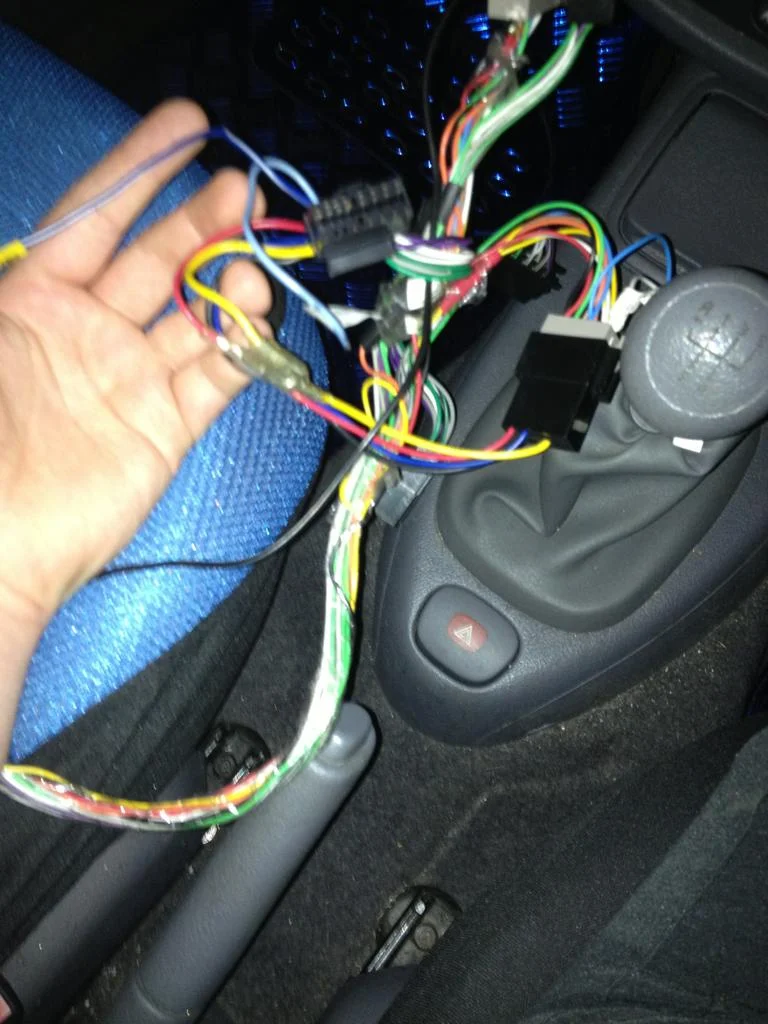

Could you get a photo of all the loom laid out, whilst connected in the car?
On the male iso (parrot) which plugs into radio there will be 3 mute cables with female connectors on them - make sure none of these are connected.
And from the parrot box there will be a yellow cable with a male connector on it - make sure this is not connected to anything.
..someone mentioned the connecting the mute cable to the radio so that is read 'speech' on the display, but your aftermarket HU may not have mute function, therefore no mute will be required, and the display will show the same as when the radio is playing by itself

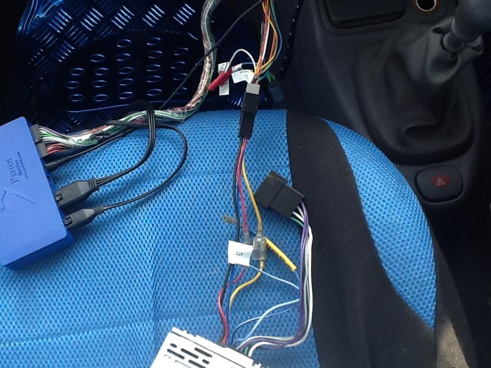

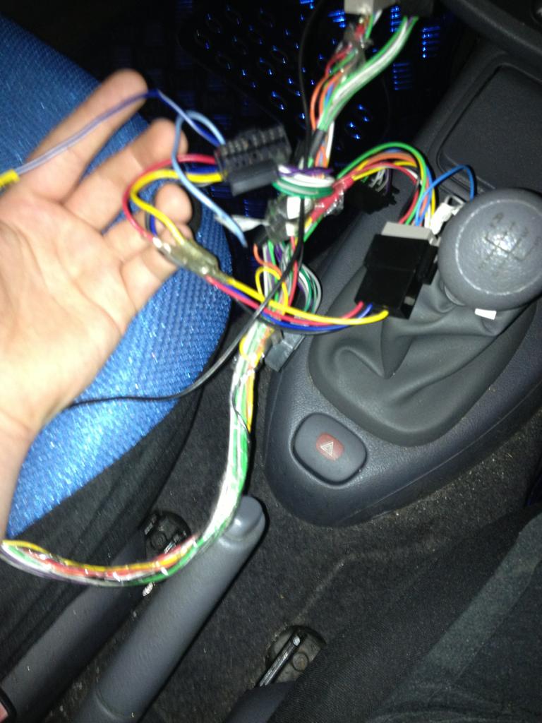

Just drove to brothers. On the way, iPod jumped so I pulled the parrot screen off the stand, put it back on and was fine.
A bit further on the drive, nothing was playing, iPod wasn't working, and if I selected iPod on parrot again, it just kept saying "connecting iPod". I turned car off and on again and was fine.
So something isnt right here.
Here are the images for you, lemme know if you need more?
  Clio 182
Straight away ;) - ur audio iso isn't connected into the loom, there should be a male iso on the parrot loom to connect back to the radio, this looks like it is under the power iso connection in the 3rd photo
Edit: black iso from parrot kit, into black iso female from radio
