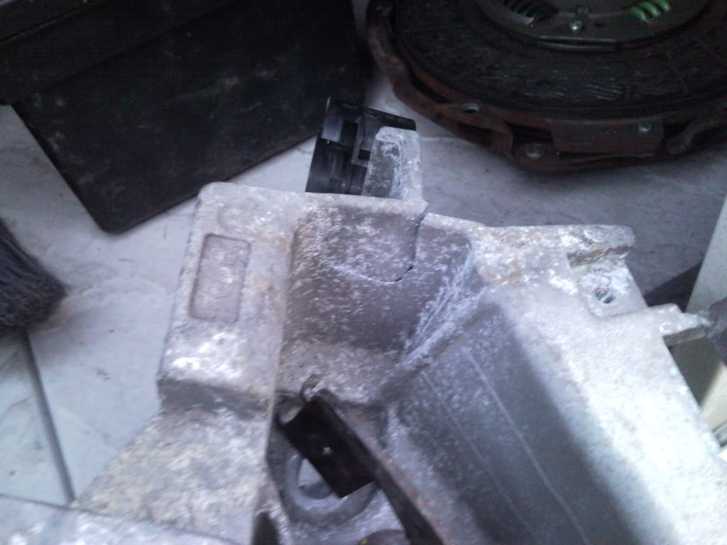

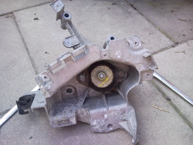

Can anyone tell me what this is? im sure its a Engine mount(passenger side), but i might be wrong,
anywho its cracked :( so i need a replacement.
Anyone kno the part number for it? .....
were that black plastic is, well the metal right next to it, il go and get a decent pic ov the crack,
there's the crack, ok its not big, but since the engine will be goin in i dont want to ecperience any problems further on.
Which engine is it, manual or auto, the part no for the normal one is 77 00 430 825. Id go down the 2nd hand/breakers route though and just pop a new mount in it.
