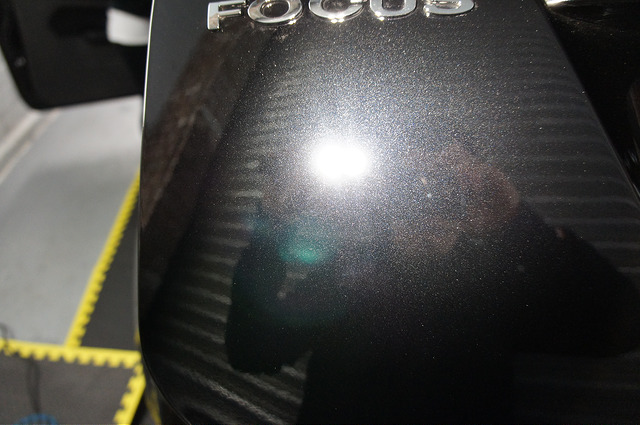

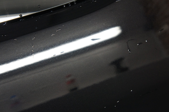

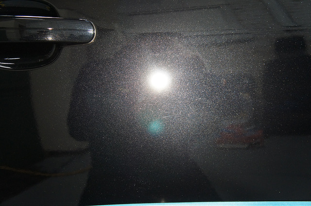

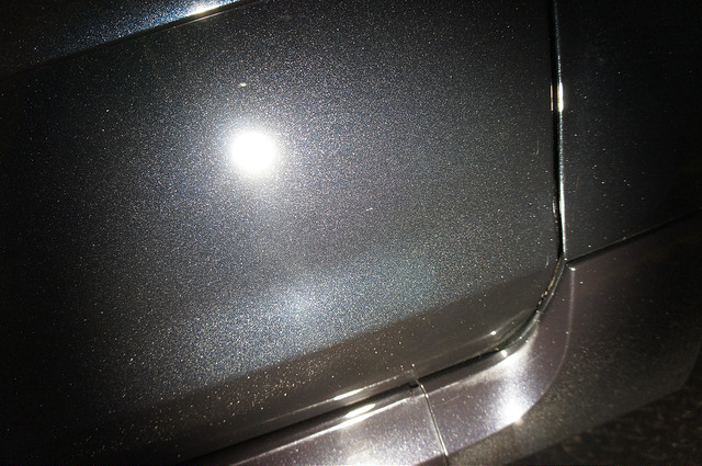

This particular example was without its decals and had seen some paint on its rear quarter, which had been finished poorly with signs of pig tailing, sanding marks and very poor clarity in the clearcoat. The rest of the car was suffering from very heavy swirling.
The aim of this detail was the wet sand the repainted area to improve its appearance, then to enhance the paintwork to remove as much swirling as possible. I also took the opportunity to try Auto Finesse Hide out on the Leather Interior...
A few befores:
DSC03390 by RussZS, on Flickr
DSC03391 by RussZS, on Flickr
DSC03392 by RussZS, on Flickr
DSC03393 by RussZS, on Flickr

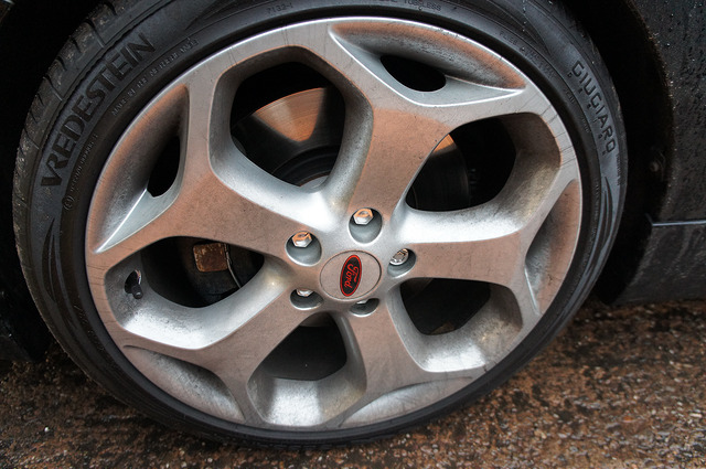

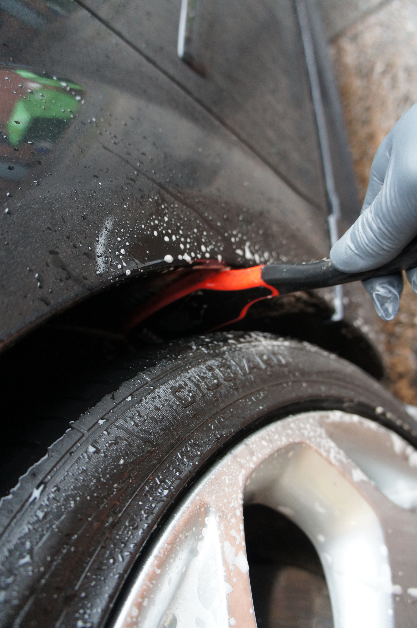

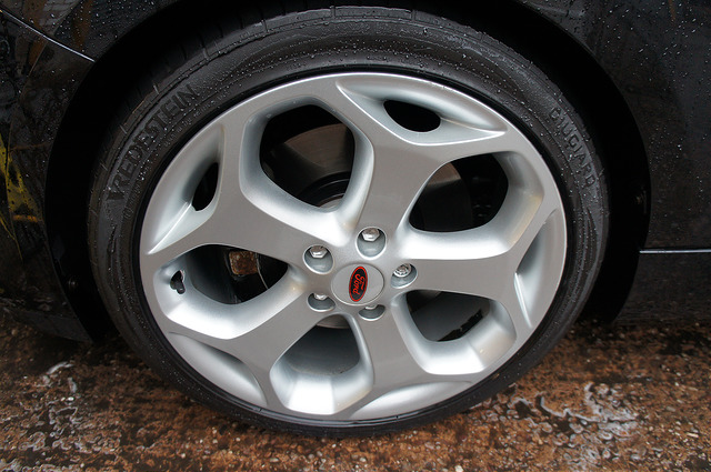

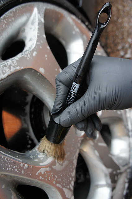

As always, wheel area first with Smart Wheels, G101 and various brushes:
DSC03397 by RussZS, on Flickr
DSC03398 by RussZS, on Flickr
DSC03399 by RussZS, on Flickr
DSC03401 by RussZS, on Flickr
DSC03402 by RussZS, on Flickr
DSC03403 by RussZS, on Flickr
DSC03404 by RussZS, on Flickr

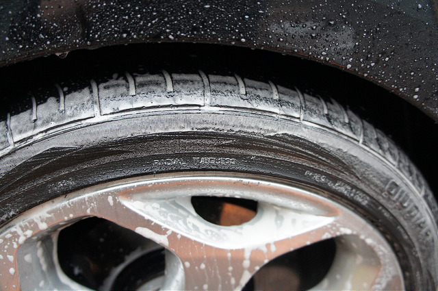

Next the car was foamed with AS Duet:
DSC03407 by RussZS, on Flickr
(That's after 5 mins dwell)

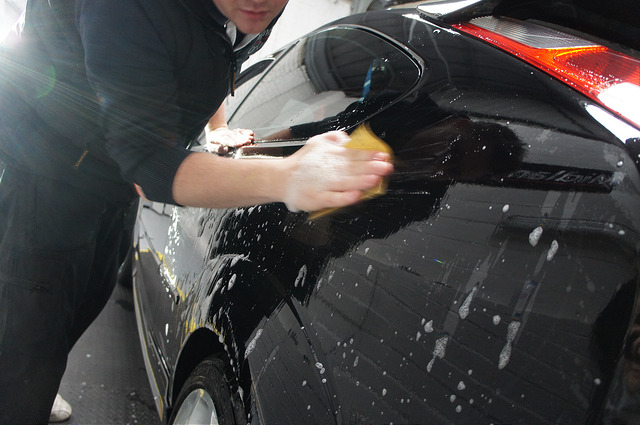

- Hand washed with AS Duet
- Rinsed
- IronX applied to entire car to remove any fallout
- Tardis to remove tar

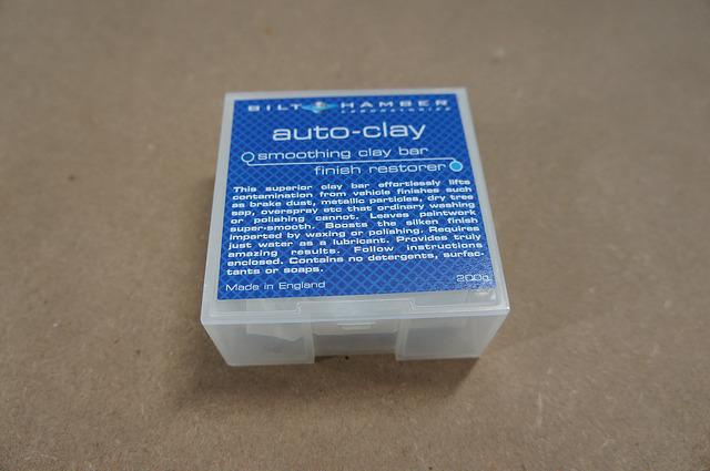

BH Clay Soft:
DSC03412 by RussZS, on Flickr
DSC03413 by RussZS, on Flickr

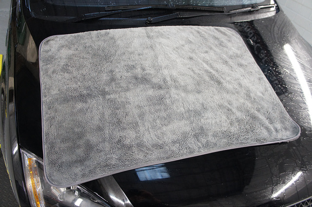

The car was then dried with CG Wooly Mammoth:
DSC03414 by RussZS, on Flickr

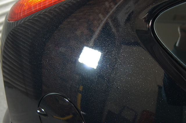

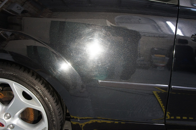

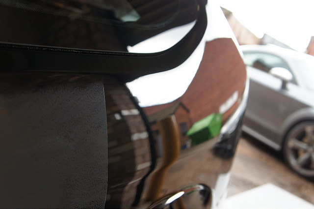

I decided to wet sand the rear quarter first, then machine polish the rest of the car afterwards.
Some pics of the rear quarter:
DSC03408 by RussZS, on Flickr
DSC03410 by RussZS, on Flickr
DSC03409 by RussZS, on Flickr
As you can see, very poor general finish and reflections!
Now ideally I'd be getting this panel perfect, but given that the rest of the car is very 'orange peely' from Ford, my aim was to restore the depth to the paint, but not remove the Orange Peel completely.

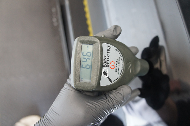

Depth wise, we were looking at an average of about 650 on this panel:
DSC03422 by RussZS, on Flickr

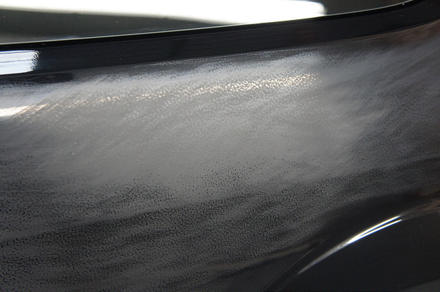

I decided to begin with 2500 grit, then follow up with 3000. This combination was chosen to not remove the peel completely, but to finish down the poor finish as well as possible and to try to 'match' the rest of the car.
I also had the issue that various areas were worse than other parts of the panel, so I changed pressure and working time based upon this.
DSC03425 by RussZS, on Flickr
DSC03427 by RussZS, on Flickr
DSC03428 by RussZS, on Flickr
DSC03429 by RussZS, on Flickr
DSC03433 by RussZS, on Flickr
DSC03435 by RussZS, on Flickr

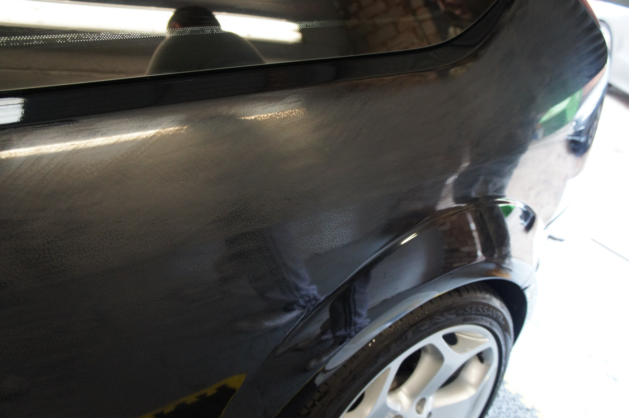

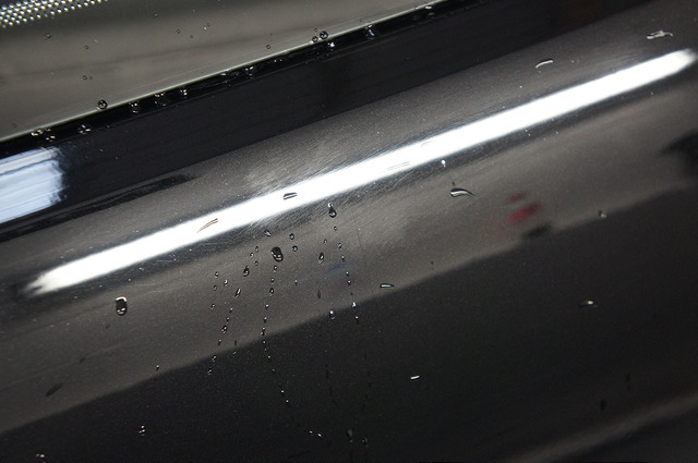

After 3000:
DSC03436 by RussZS, on Flickr
DSC03437 by RussZS, on Flickr
I corrected the 3000 with Scholl S3 and Scholl Spider Pad:
(Slightly out of focus - apologies)
DSC03439 by RussZS, on Flickr

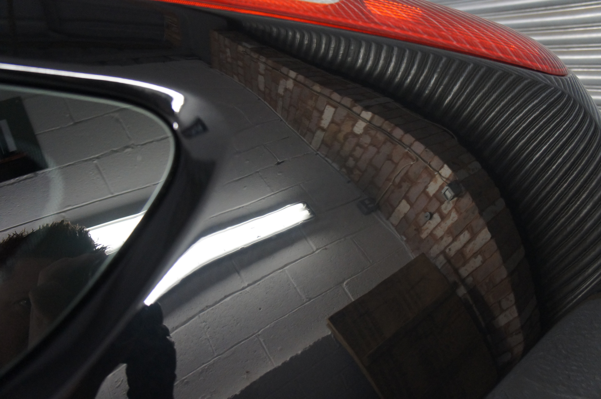

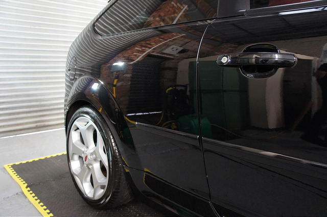

After:
DSC03440 by RussZS, on Flickr
DSC03441 by RussZS, on Flickr
DSC03444 by RussZS, on Flickr
The peel is still present, but the reflectivity and depth have been restored.

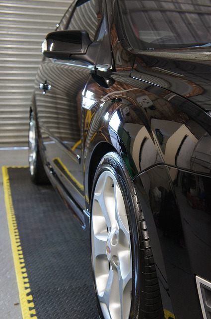

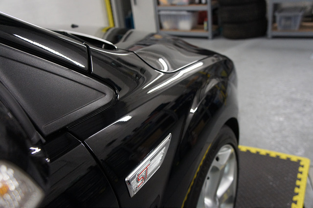

After:
DSC03520 by RussZS, on Flickr

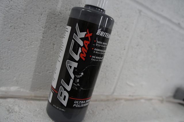

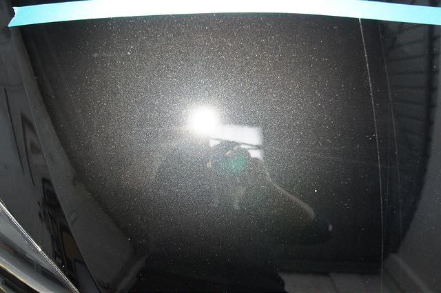

Now I had a real struggle finishing down well on this paint. Megs 205 and Menz 106FA were leaving very faint holograms which were simply not acceptable.
Britemax Black Max came to my rescue and allowed me to finish down perfectly using a 3M Finishing Pad and DA:
DSC03473 by RussZS, on Flickr

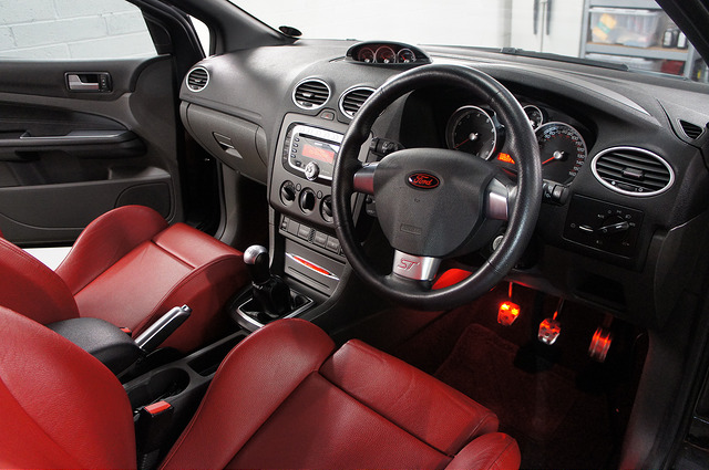

The Hide Pair was used on the interior along with Spritz:
DSC03475 by RussZS, on Flickr
DSC03476 by RussZS, on Flickr
DSC03477 by RussZS, on Flickr

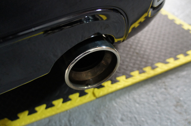

Mercury on the exhaust:
DSC03482 by RussZS, on Flickr
DSC03483 by RussZS, on Flickr

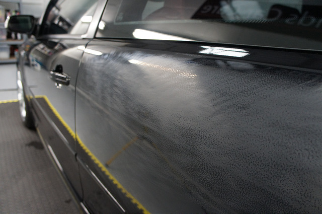

LSP for today was Auto Finesse Desire...
DSC03480 by RussZS, on Flickr
Curing:
DSC03481 by RussZS, on Flickr
