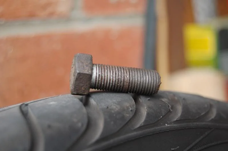

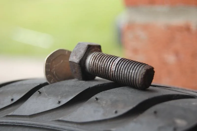

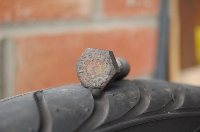

problem solved 1 of the bolts has gone holding the capilar on!! :eek: :S
and i could loosen the other 1 off by hand!

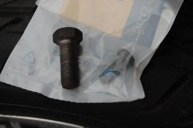

its the 16v been down today and orderd 1, guy didnt have a clue what part i needed took him 10 mins to find it

Well if its the small one (caliper to carrier bolt) and part number 77 01 020 243 then your ok, the big one (carrier to hub bolt) is 77 03 101 617.
-KarL-
Renault are great and orderd the wrong part :D !!!
whcih is the right part number above for the 1 i need?
took some pics..
